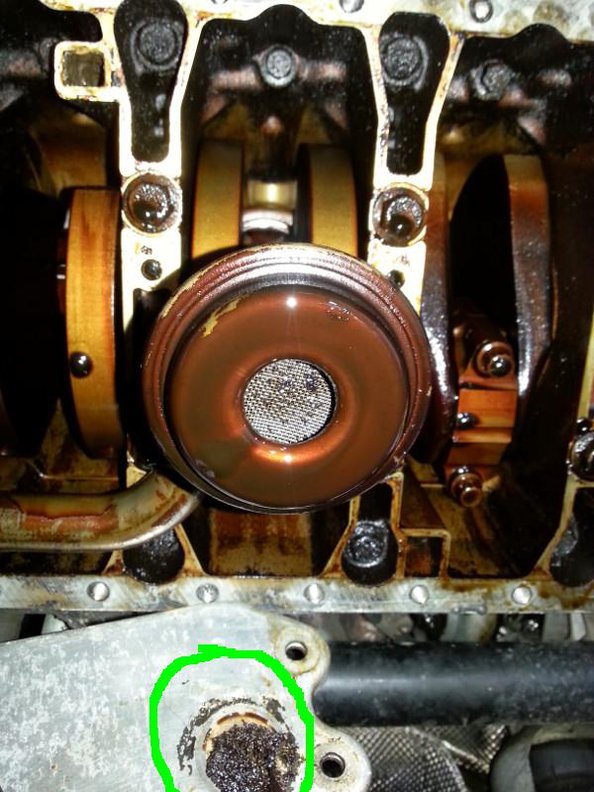

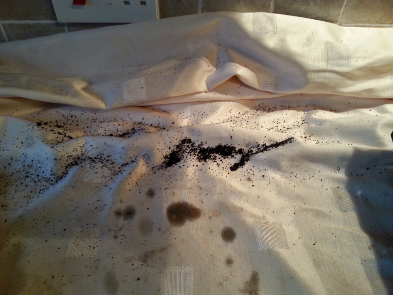

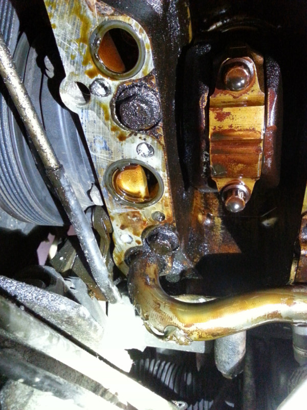

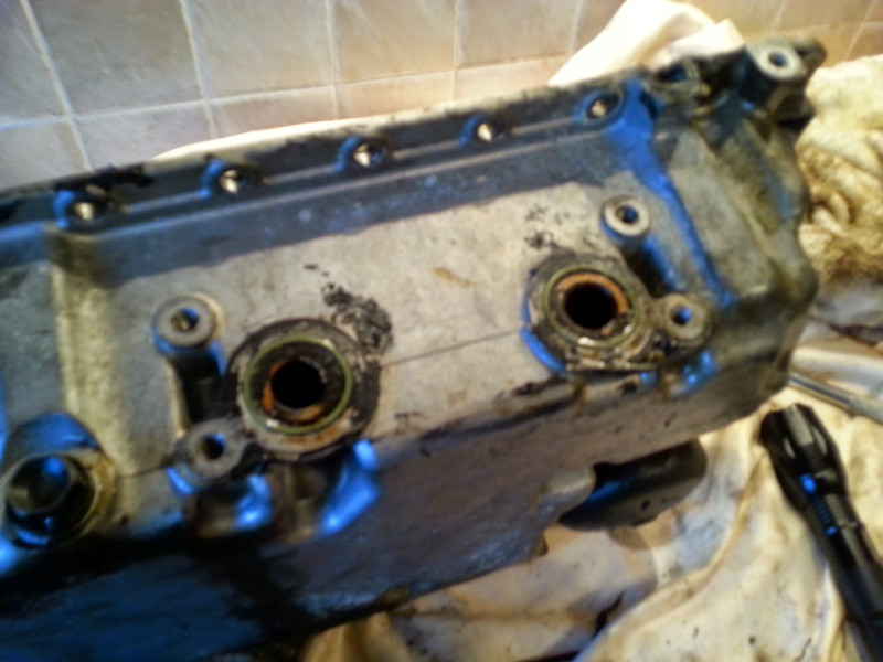

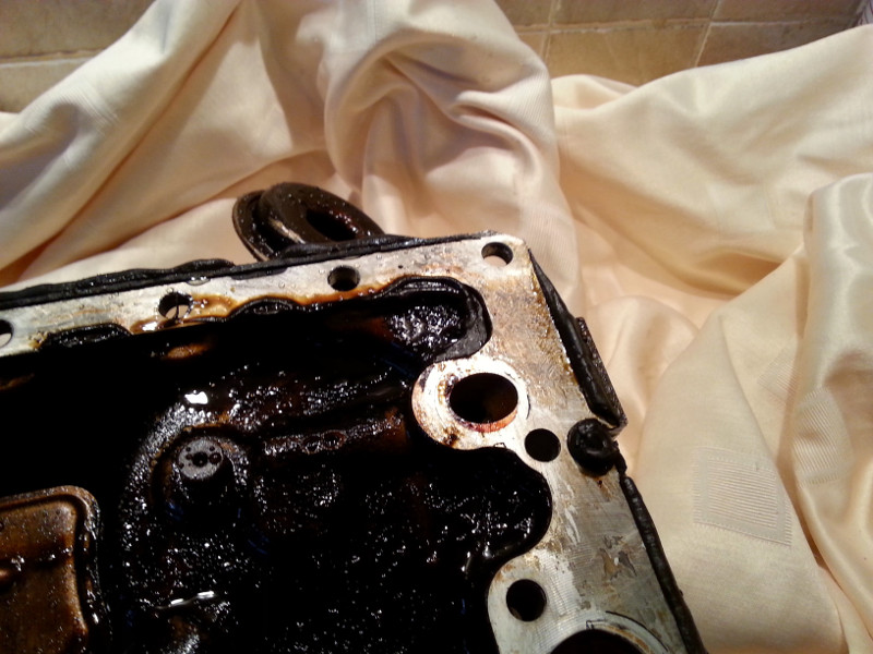

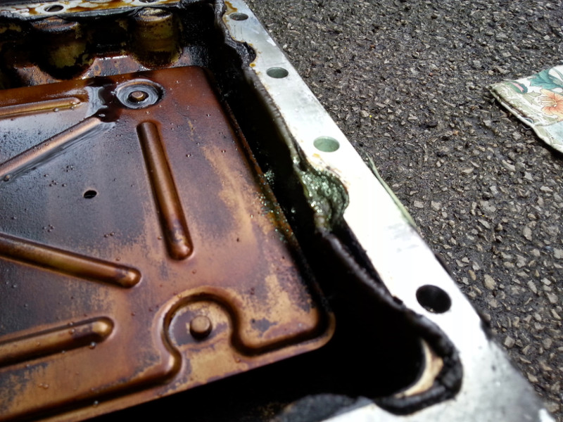

I removed the sump from my 2001 T5 over the weekend and want to show you all the pictures for your opinions :)
The thing was covered in black sealant inside & out and the pick up pipe was full of little black bits (which I assumed were bits of sealant????).
Now it's all off and cleaned how in the world do you guys get them back on with out upsetting the sealant?
I cant even get the sump back on in one let alone with the sealant on, I must be missing something.
Thanks All
Si

Is that the PCV port at the bottom of the 5th picture?
siboyslim
Posts: 15
Joined: 04 Apr 2013, 15:24
Year and Model: 2001 V70 T5
Location: UK, North Wales
Post by siboyslim »
Yes It looks like it!
The sump port is clear but the one in the block definitely looks blocked, is it safe to poke something up there?
Well spotted :)

Post by oragex »
The one in the block goes to the PCV box, you can try pass a stick or something to clear it, but most probably the PCV box is also clogged, by the looks of the port. But it's good to have the sump removed, because the sump port cannot be cleared otherwise (and must be done when the PCV is replaced)
While the pan is off, you can try checking the rod bearings for play by hand, especially the one on the 5th cylinder (this one happens to get some wear if the oil pressure was too low because of a clogged pick up pipe mesh)
Next step, pcv replacement, another couple of hours of fun :)
As for the original question, I don't know tips, but maybe this video may give some answers, it shows somehow a similar looking situation with an engine in need of a good cleaning
This port also looks a bit clogged, could be the one that goes to the cooler?

Thanks for the info, been dreading PCV replacement but it looks like it will be on the cards very soon, hope it gets warmer soon! Way too cold for this sort of thing.
Don't worry about the oil cooler I plugged the hole with a bit of rag:) looks just like sludge.

I see many miles and years of oil sludge - those little bits are crusty oil. My BMW looked the same, my S80 was not so bad. Clean it all up - really clean. Take out all the parts and work around the baffles. make sure your pick up tube and screen is clean.
Looks like your sump pan has been played with before. That does not appear to be factory sealant - they use Anaerobic Sealant not RTV.
To install pan you have to practice, practice and practice with your clean pan so you can get it in without bumping anything. You have to figure out the twist, tilt, turn ... so it goes in. Once you got it down you are ready. Make sure you use the right sealant, roller it on thin, make sure all your O rings are in place and go for it. Helps to have a second person to hold the pan on while you tighten the first bolts. Follow the pattern. One more thing - replace ALL of the O-rings as these wear and leak with age. I use brake cleaner just before I install on the sides to get those final little drips, then wipe clean and move quickly to avoid more drips.
