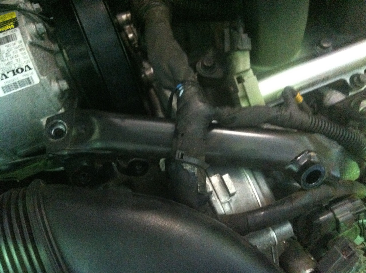

Remove the big bracket. 12mm and 1 14mmm bolt. Just remove the bolts, the alternator will not move.
There is a cable tie holding a cable onto the main bracket. It's a little difficult to get the bracket out. I just rotated it around and pulled it out the way.

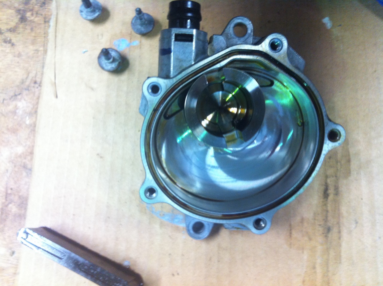

Remove the torx bolts and the cover comes off. Remove the large o-ring. I cleaned up behind the oring with some turps as it had a build up of burnt oil behind it. Similarly on the back side of the cover. You will need to clean that up too.
The difficult bit was the black plug on the end. You need to squeeze from both sides. Have a look at the replacement part to work it out. It would be easier with a second set of hands.
The new one just presses in.
The smaller o-ring fits on the backside. The dental pick helps with getting the old one off.
Bolt it all back together and then clean up the mating faces.

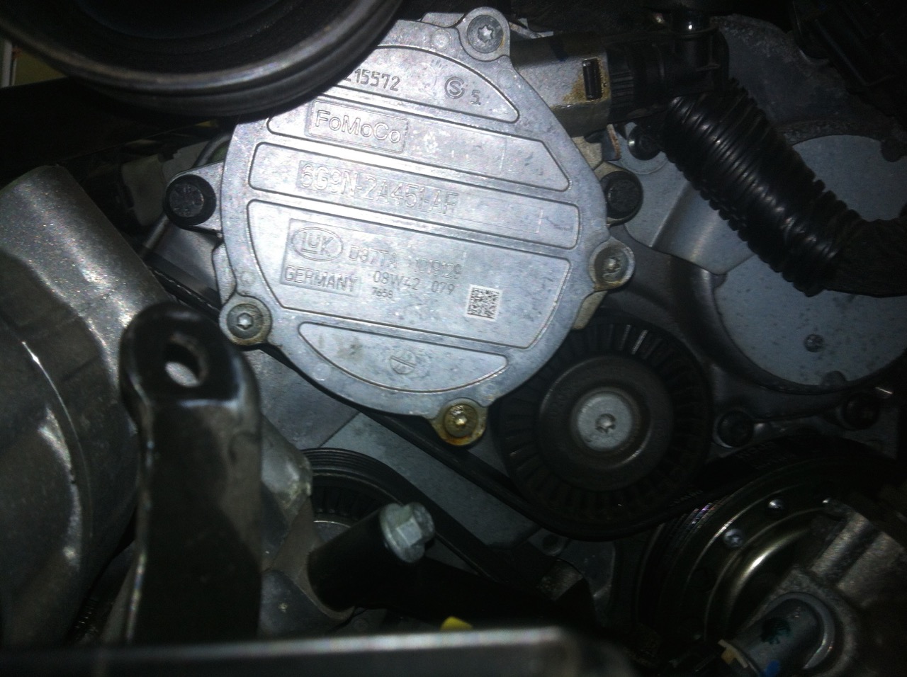

The offending item with the airbox cover removed. I’m not sure why mine has a blue mark on it. We are the only owner.

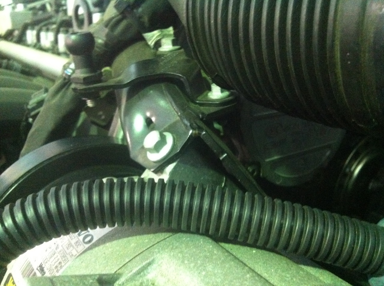

These are the 3 brackets you need to remove. You can see the pump in the background. There is 1 large bracket that has the other two bolted to it. You remove the first one from the top front side 1st. then the smaller backside one and then the large one.
the large bracket still before removal. You can see the power steering pipe that has been moved out of the way
The big bracket rolled over and moved out the way. I had cut the cable tie you can see.

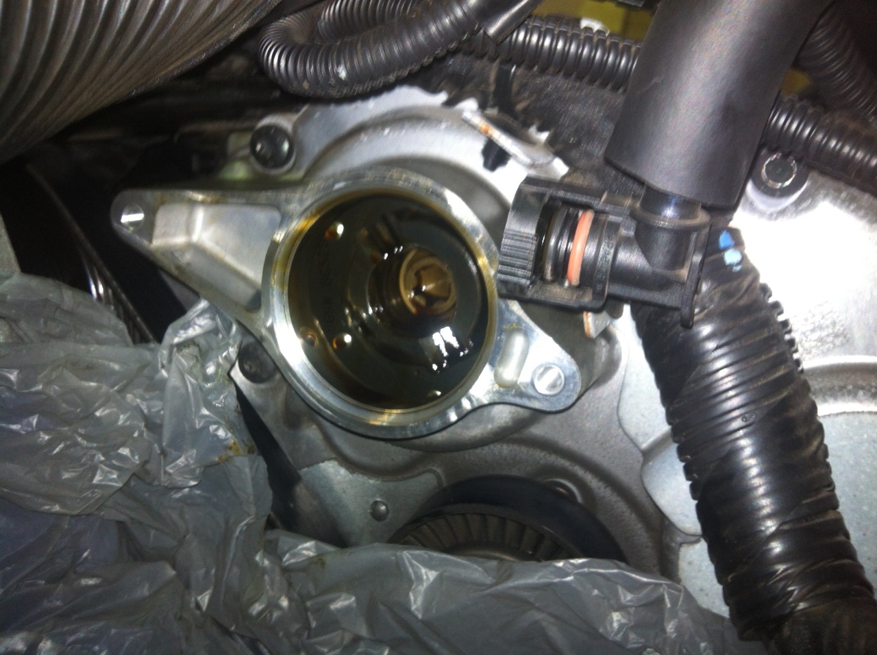

Pump removed

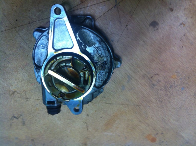

backside of the pump prior to cleaning

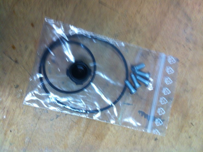

Rebuild kit contents. Not a lot for your $80. But cheaper than $450 for a whole new pump. Although value for money??

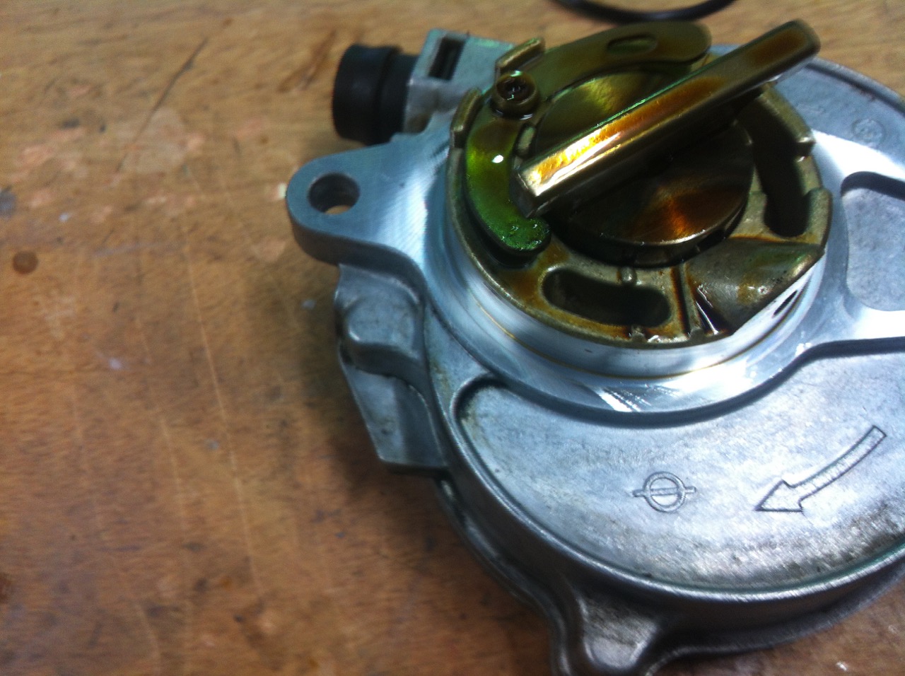

Backside o-ring
backside o-ring removed

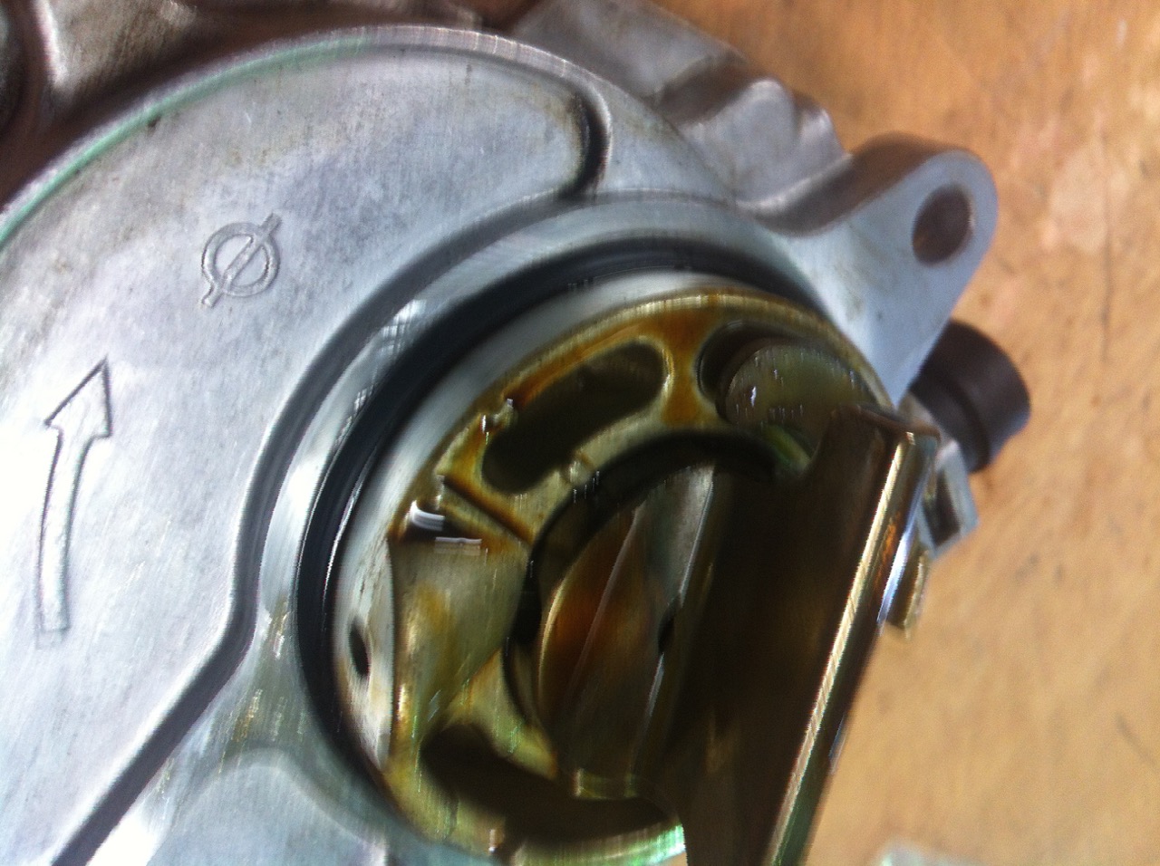

Pump open and o-ring removed. The paddle in the bottom left sits in the slot and spins around.
Backside o-ring

Looking at the photos now. I think mine was leaking from the rear o-ring, and perhaps the black fitting. I did notice that when I spun the pump the black fitting would move in and out. However, when I installed the new one it didn't move at all.
