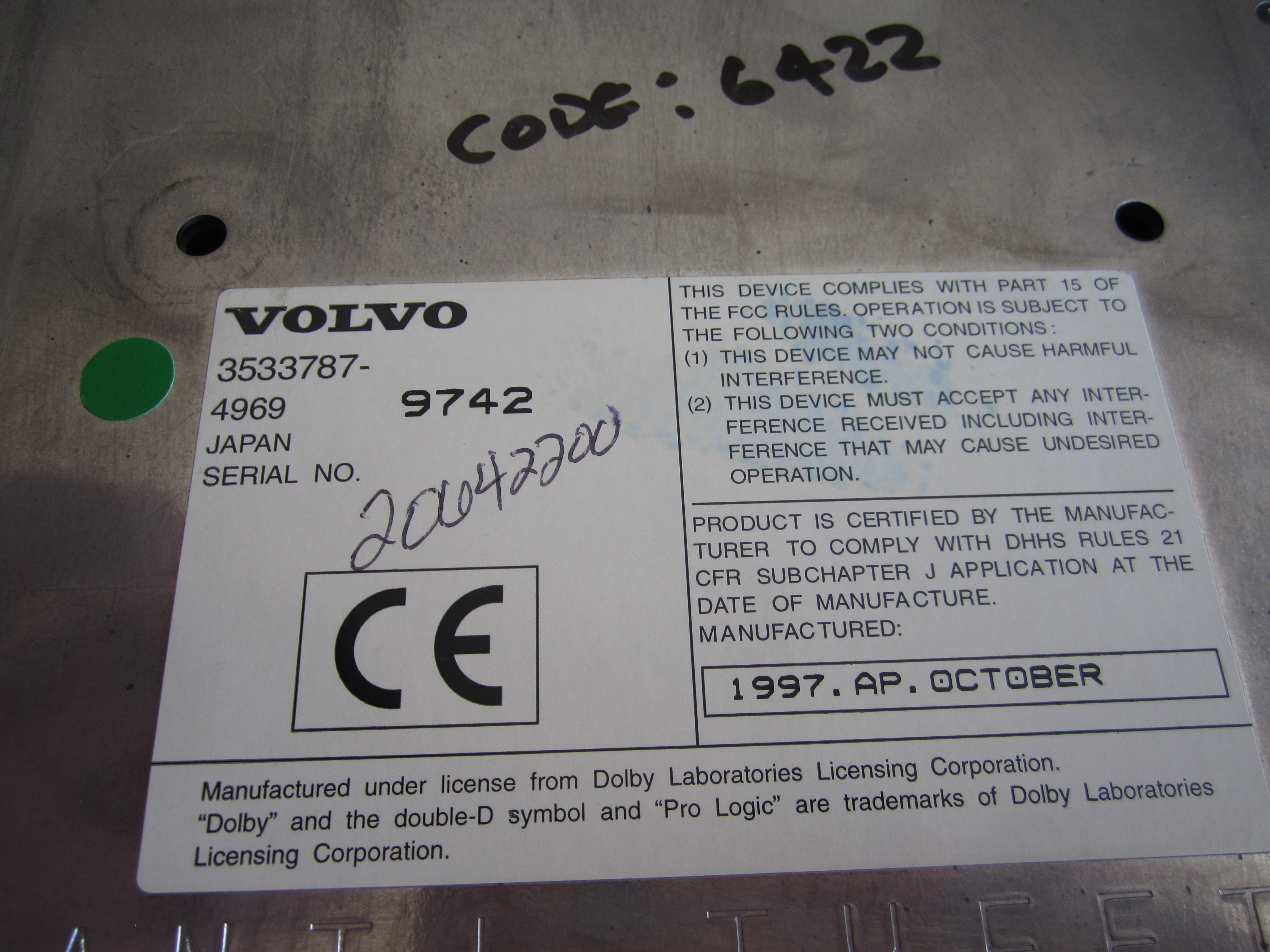

I seem to be collecting radio units. I was given a SC-900 unit today for $0, but the catch was there is no code and no VIN. What is the info I need to get of the unit to call Volvo to get the code? I know the dealer well, but don't like to waste there time if I can get the info together first.

So here is the update. The rider here is that you may need to have a good relationship with your local dealer, or may need to prove you own the vehicle, and the unit is original to your vehicle to get help in the best case scenario, or if the radio/head unit is not original to the car they may not help you at all. Hopefully that is not the case! In my case, I did help out at the dealer a few years ago, and have one Volvo serviced there and the others occasionally go there when I can't fix something myself (knowledge/tools available to me/ or can't be bothered!).
(A) - How to get the radio code if the radio/head unit is original to your car, or has been replaced by the dealer and so the records are up to date You may have to take the car in for proof of ownership.
You will need: 1) Radio/ Head unit model (e.g. SC-900, SC901 etc., )
2) Vehicle VIN number (if you don't know it is on a plate on LH side of dashboard at the
windscreen, and viewed from outside. Will start with something like - YV1XXX and has
about 17 characters in it. There is usually another plate with the VIN on it under the
hood on the side of the inner wing on the LH side toward the front).
The service department were able to get the code for me in a couple of minutes over the phone.
(B) - How to get the radio code if Radio/Head unit is not original to the car, and VIN is not available.
I had to go through the parts department for this, and my friend there took the time to look up the info for me in a quiet time and got back to me. Don't hassle them, or they may not help!
This is all the info I gave him to help I.D. the radio code. They may not need it all, but I got my answer the next day:
2) Part number: this is on a label on the top of the unit -
The part number for this unit was - 3533787. I did also give them the other info from this label. The additional numbers after the part # - 4969, and also the heavy printed number : 9742. Don't know what that number is for, but I do see a similar number on the labels of all my radios.
3) There is also a stamped set of numbers on the rear of the unit which can be hard to see. This is the serial number:
I gave them all the info as it is not clear how much is the serial number, some or all.
From this, information I got the serial number and was able to connect and check the unit to see if it worked.
Hope this is of help!
