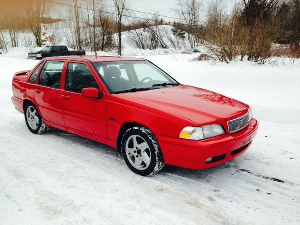

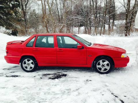

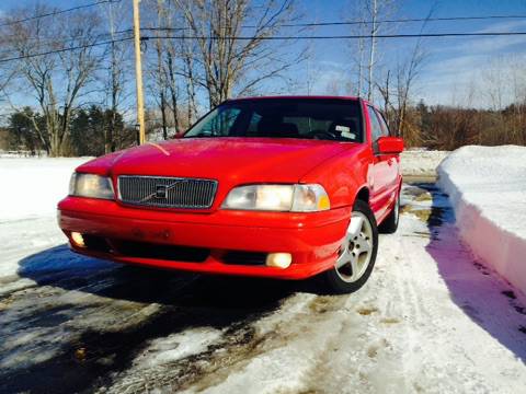

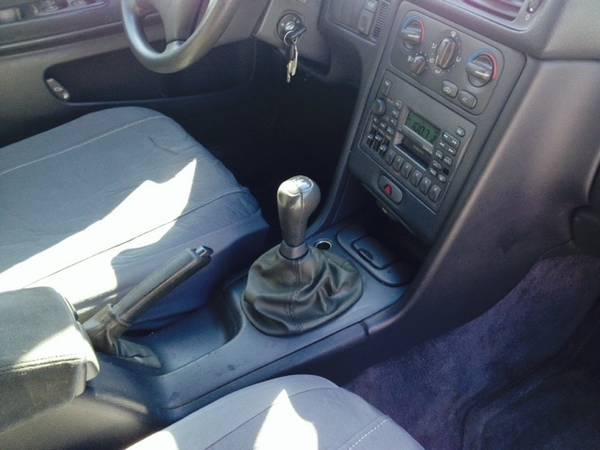

Hello everyone just bought a 98 s70 T5M today after my 854R died finally. I think i got a really good deal and definitely the better end of the bargain. So the bad: 216k, clogged pcv, bad rear strut mount, tiny radiator leak,a but worn tie rod ends, exhaust leak, broken dipstick. The Good: timing belt done 10k ago, clutch done 8k ago, brakes and rotors done 1k ago, doesnt leak any oil, even compression across all cylinders, turbo pulls like a raped ape, and finally i only paid $660 for it. So things i have ordered and will be here tomorrow: fcp pcv kit (genuine volvo), genuine volvo spark plugs, bougicord wireset, bosch rotor/cap, oil & filter, fuel filter, air filter, cabin filter, vacuum hose, myle tie rod ends, myle HD sway bar links, dipstick/tube and oring, 35w H7 hid conversion kit with 10000k bulbs, rear strut mounts for both sides. So i have attached pictures and would like any input and advice on next step I should take as far as maintenance. I dont want to upgrade too much and im not expecting it to be a 300hp volvo. I want any preventative maintenence to guarantee she sees her 300k anniversary lol. Thanks in advance

Looks nice. Congrats.

Nice looking car for 660$.
