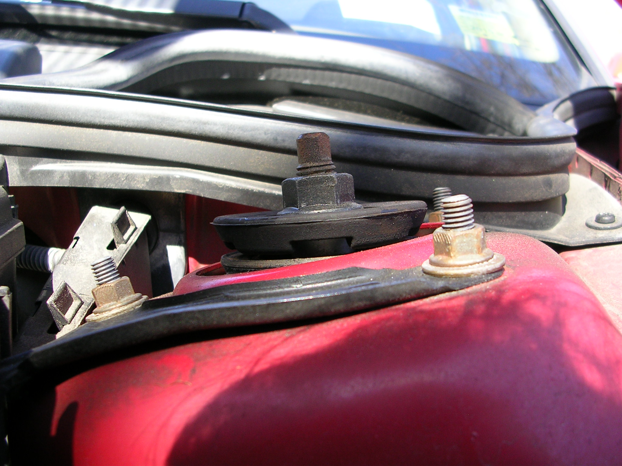

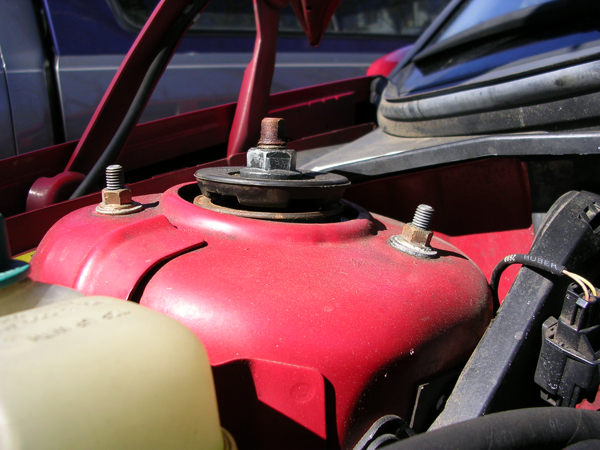

I purchased the full front end kit from FCPEuro and got the beater Volvo back together last spring around this time.
This was a first time adventure for me, so not without its mishaps, but I was able to get the car aligned, so it tracks, handles and steers decently.
Unfortunately. I am still getting some clunking in the (mainly passenger side) front end--occasionally it is the 'reset' kind of noise like when the strut tower changes direction, and definitely some clunking/rattling when I hit the connected potholes that New York calls roads.
First (and idiot) question--how tight should the top of the strut tower look? On the passenger side (where I hear the noise) I can actually see a gap between the top washer--actually a little on both sides...
Other than that--where do I begin?

I dug out the FCP front end kit details:
*spring seats
*control arms
*bump stops
*dust boots
*swaybar links
*outer tie rod ends
*OEM struts and XC strut mounts--I splurged for the OEM Volvo HD seats that I no longer see on the FCP site
I also replaced the upper motor mount
Gonna recheck the endlinks per this thread:
https://www.matthewsvolvosite.com/forums ... =1&t=33170
I have had the wheels off once and checked for loose bolts etc, but I am about to do some brake maintenance, so I will have a chance to check things.
Any assistance is appreciated.

I don't see the upper strut bearings in the kit list and from the photos it seems you didn't replace them. If so, that might explain the issue.

Sorry--I called them "mounts"--those were the XC heavy duty ones...Cees Klumper wrote:I don't see the upper strut bearings in the kit list and from the photos it seems you didn't replace them. If so, that might explain the issue.

It sounds like you replaced the entire front end suspension and some steering components, this might be the best it will get with the car. Might be the dash too and all the trim around that area.
*your pictures look good, doesn't look like anything is off

It's confusing because of the way FCP bundles parts--but the actual item listed was "Volvo Strut Mount and Spring Seats Kit-OEM" and this included the OEM XC spring seats and new strut mounts (the metal piece). Sorry for the confusion.dosbricks wrote:JRL is talking about strut mounts (steel top plate with bearing in it), not the XC rubber spring seats with the molded in steel bushing. These terms get confused all the time.![]()
So I have essentially all new parts in the front and have been disappointed it didn't make all the noises go away.
Now there are other random rattles/noises--the passenger seat headrest, and the passenger seatbelt retainer. And I'm getting some random noises from the belly pan that is damaged (and rubs)--this car was driven hard and put away wet.
Aside from the 'reset' kind of noise (very occasionally), I will get a knock/rattle only on the passenger side and pretty much only when I hit a series of depressions in the road where the wheel kind of oscillates a few times, and I hear a knocking that does seem to be suspension related.
So my question remains--if I scrutinize my work what should I be checking?
Thanks all!
