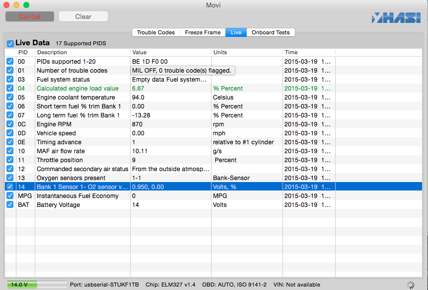

This is what the OBD2 output looked like while it was idling roughly:

The MAF readings while it was idling poorly seem quite high, usually this is around 4. Unplugging it caused the car to idle smoothly.

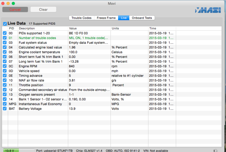

Once I turned the car off and reattached the MAF sensor it ran smoothly again. This is what the output looks like:

Three things point to the MAF:
- very negative LTFT
- the comment about unplugging it
- the low MAF reading
Bad MAF can be very erratic. How old is the MAF? Is it Bosch?
Also I would make sure the IAC is clean.

Ok, thanks. Also just realized I have those screenshots labelled incorrectly, they should be reversed.

Your double digit negative LTFT indicate ecu pulling fuel, so it's running rich. Since temp is correct ECT is working, also o2 sensor is switching. That said other causes are fuel pressure, leaky injectors. Thermostat was a good guess, did you use OEM? At some point you had a code as seen in first scan. Did you check skinny airline coming from pcv return/intake into throttle?
