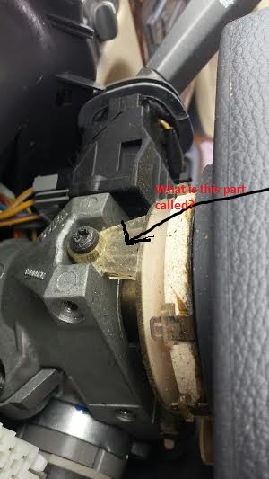

My turning signals are not working. Once I turn it on it will work once then stop which tells me it is not the light. The four ways work just fine. I found a few suggestions on here. One of which was changing out the turn signal lever. I have it all apart put noticed that there was another part broken as well. Wanting to know the name of this part and if it needs to be replaced or if it's just fine to leave it. Thank you, Necia

That is the mount for the clockspring, it is part of the airbag system. If you don't have the SRS light on it should be OK to just leave it.
