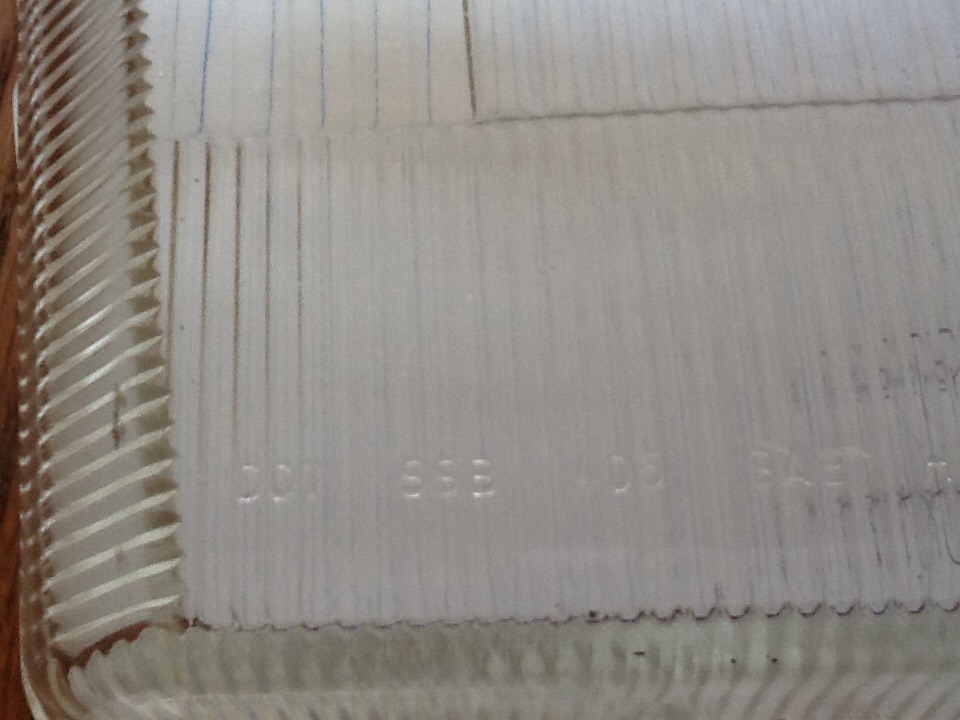

I've noticed the low beams on my '98 V70 appear to be quite dim. Family members have wondered how I drive it at night. I guess I've grown accustomed to it.
I'm betting the silvering on the low beam reflectors is shot or nearly so. High beam seem fine. Rather than spending outrageous sums on replacement headlights, I'd like to look for a serviceable set at a scrapyard.
How can I tell the difference between a regular DOT lens and an E-code lens if (ever the optimist) I were to happen to run into an E-code lens in a yard?
'98 V70 -- Headlights Dim

I've heard of the Ecode lenses but I've never understood the difference between them and the DOT lenses. Ecode are better I take it?
