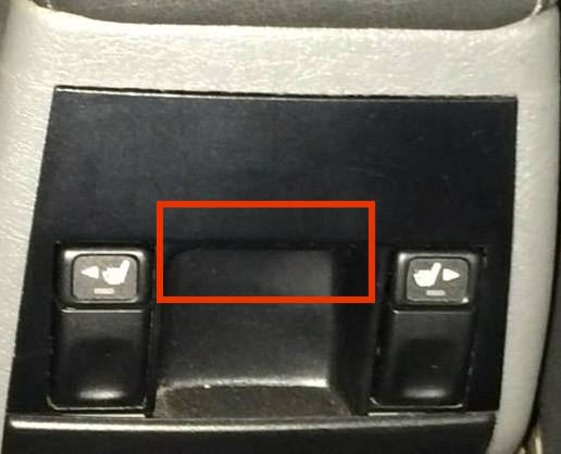

I have a quick wiring question...how does the courtesy light in the rear of the center console get power? When I removed the center console from the car to fix an issue with the power window switch I noticed a lightbulb was missing in the rear between the two switches. Two wires were left unconnected one was a ground and the other is for +12 volt (it's a pink wire). As a fun project I thought it would be neat to put an LED light in to illuminate the passenger footwell at night. However with everything connected up and the center console reinstalled into the car it didn't work. :?
I tried turning on and off the headlights and making it night in the garage thinking the light would illuminate when it's dark outside.
The area inside the rectangle on the photo shown below would be where I think a light may be in the center console to illuminate the rear passenger footwell area.

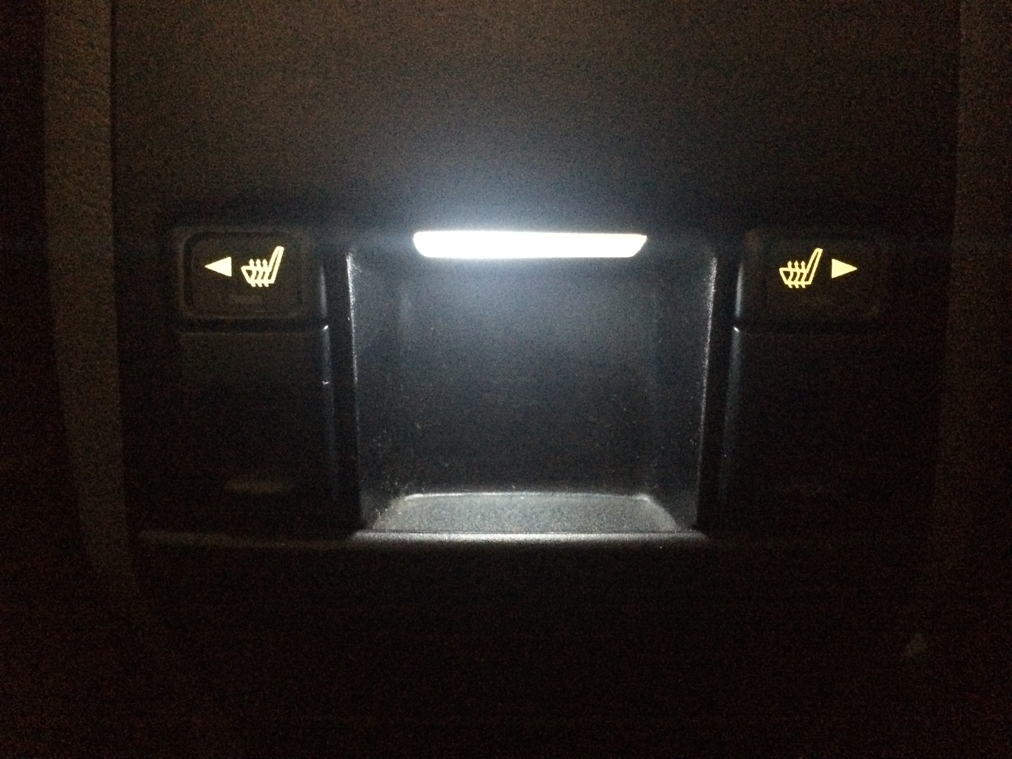

Thank you everyone again for the replies! Turns out the LED's polarity was correct, but one of the wires came unplugged when I installed the console. :oops: Reconnecting the LED light to the circuit gave it power and it lit up. The back seat floor lights up really well at night.
As a side note, the light is for illuminating the rear seat ashtray at night. It is powered from the vehicle's illumination circuit (the pink wire) which turns the LED light on when the headlights are on. Also found out the LED is dimmable.

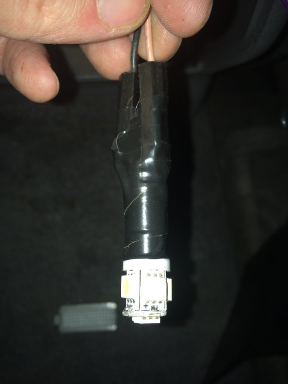

3. Connect bayonet base to the two electrical leads. Then plug in LED bulb.
4. Test the LED's polarity by turning on the vehicle's parking lights or headlights. Either would work. If the LED lights the polarity is correct; if not, switch the wires and test again.
5. After the LED lights, use the electrical tape to attach the electrical leads to the bayonet base and LED bulb. Cover the entire contact surface as shown.
Finished light assembly.

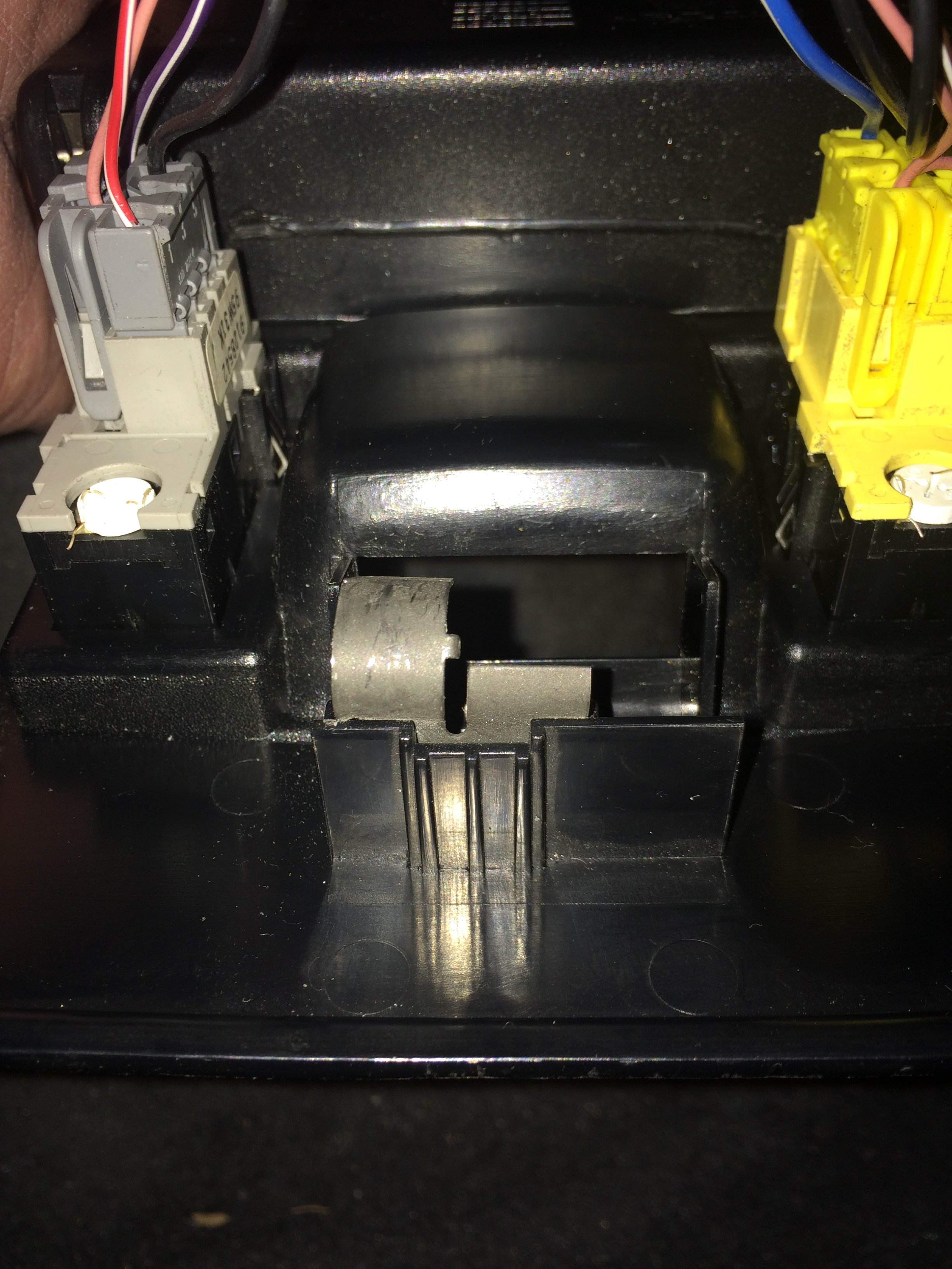

6. Modify/adjust the factory metal reflector to accept the LED bulb and bayonet base assembly. This will attach the bulb to the back of the center console. I removed the light lens to make it easier for installation. Push the two tabs inward to remove the lens. Also, the metal reflector is above the factory lens for perfect light distribution.
Adjust metal tab
Adjust metal tab
7. After you get the light installed and tested go ahead and reinstall the clear lens then back panel into the center console.
8. Enjoy the finished result!
Finished Result!
Finished Result!
