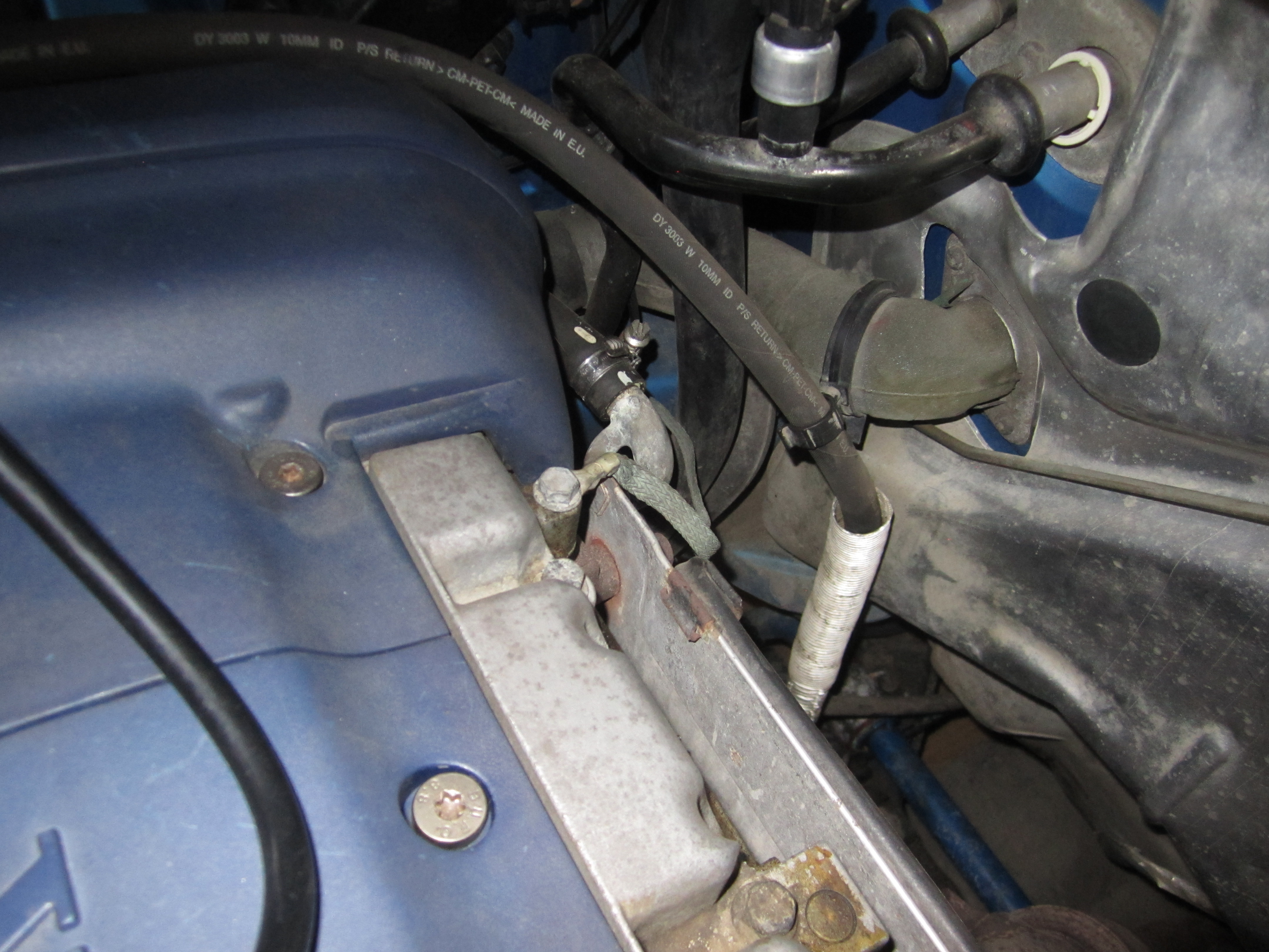

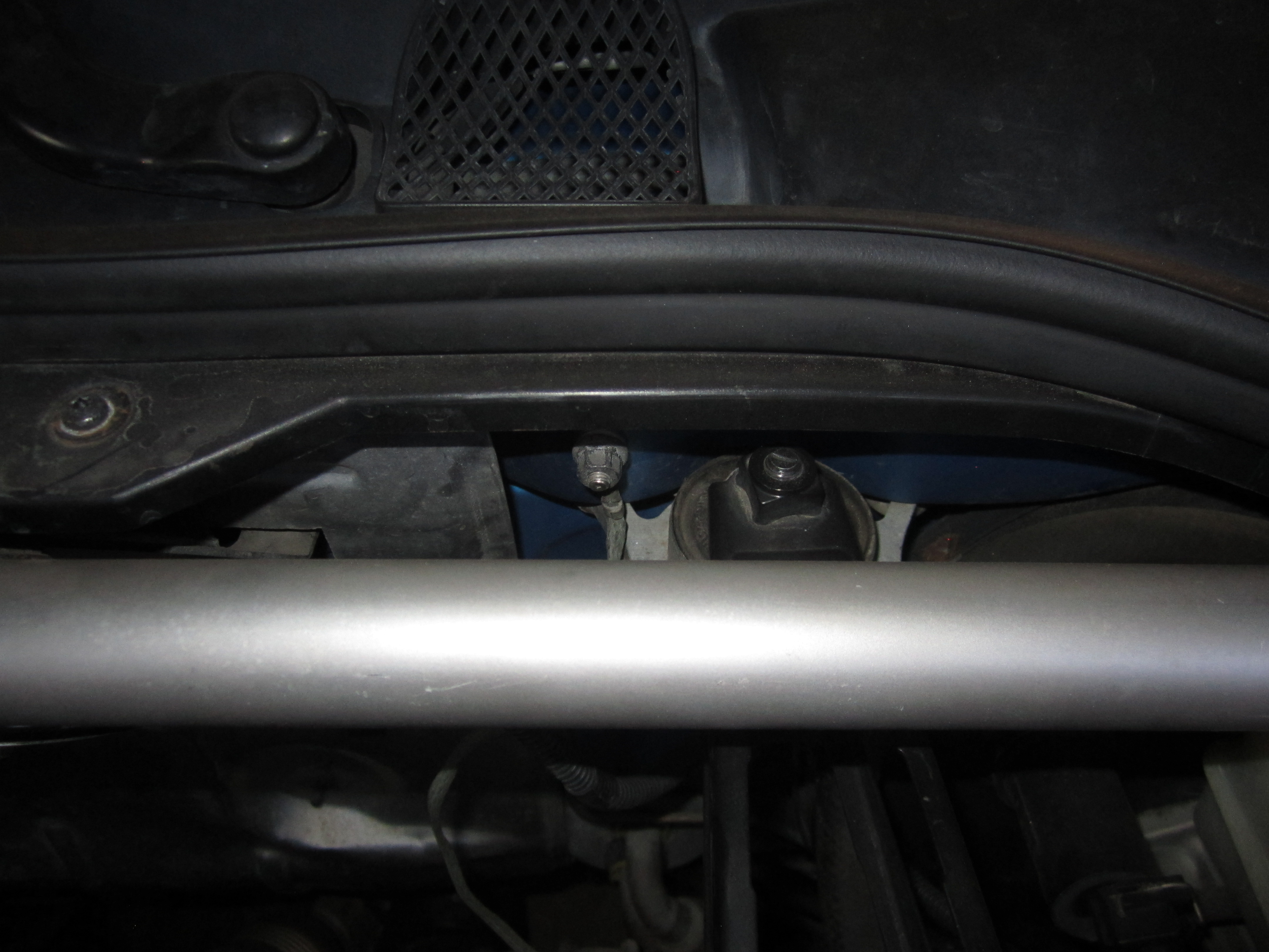

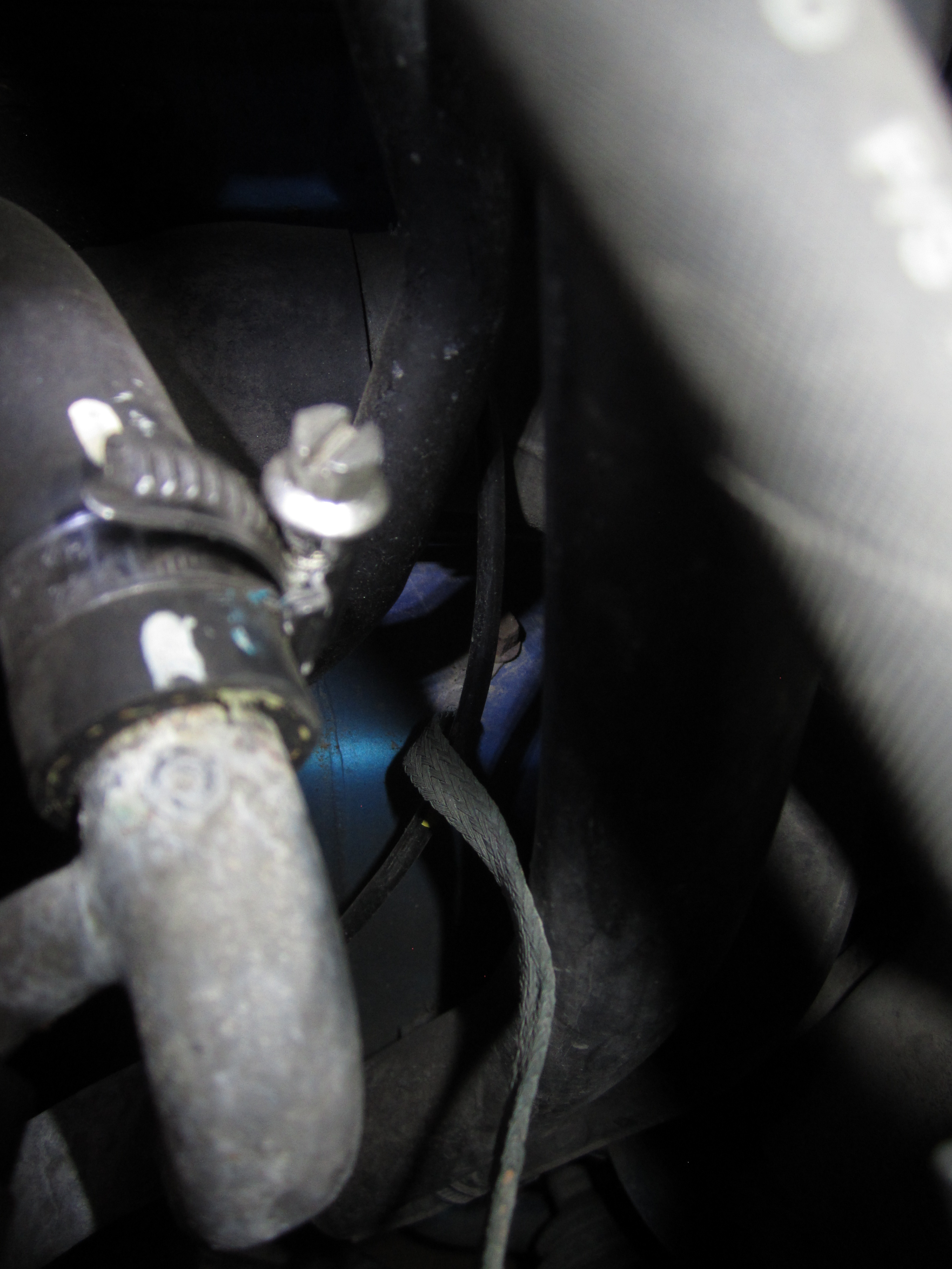

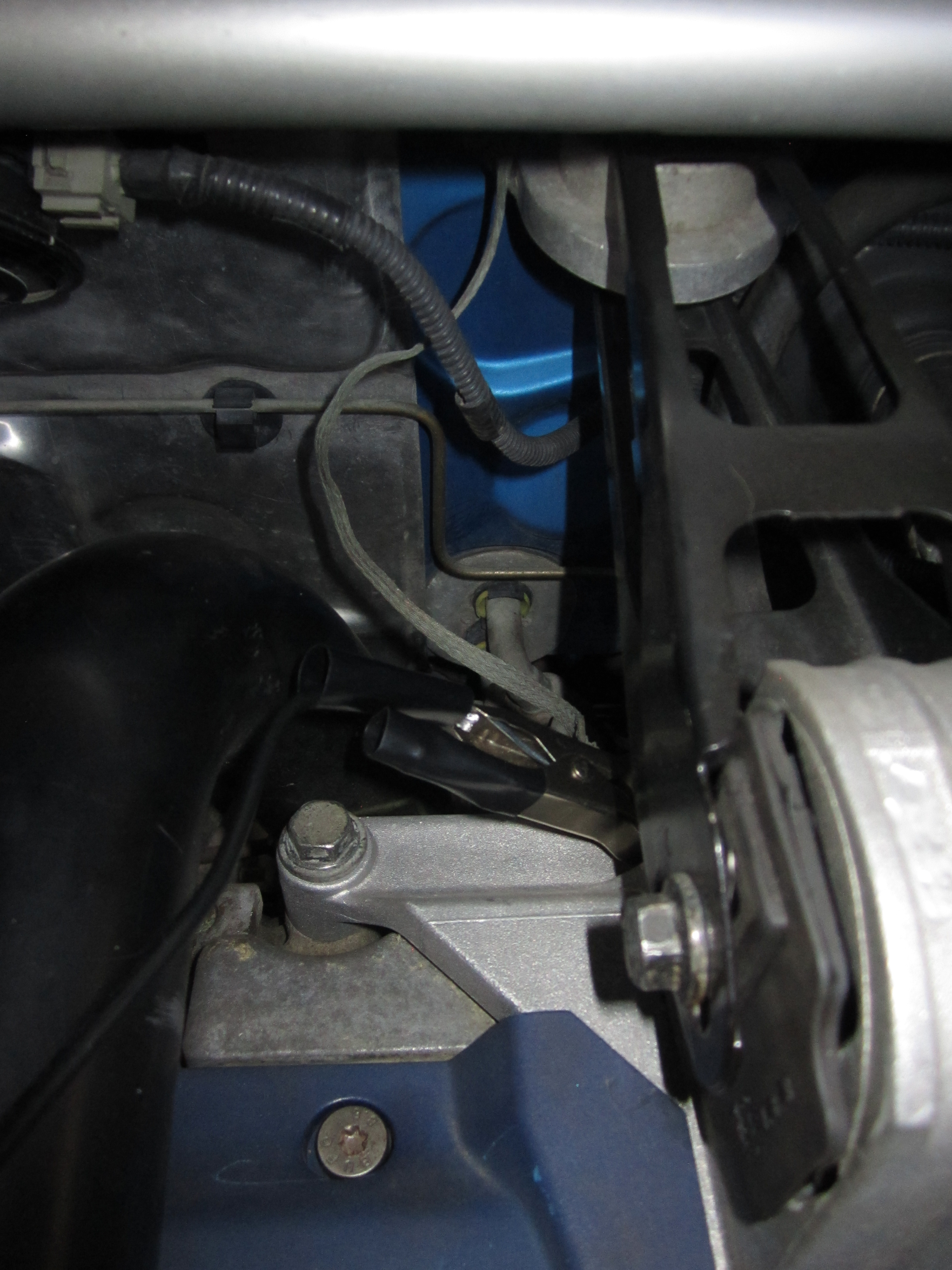

I had the camera out for another post, so took a couple of photos of the rear engine earth straps on my 2000 V70 R. Not sue if they are the same, but hopefully they are. The one in the center by the torque mount I'm fairly sure should be correct. Not sure about the one by the cam belt cover.
Hope this helps somewhat. The Cam cover strap is hidden by a bunch of metal/hard pipes that I couldn't move, but hopefully gives an idea of where to look.

In all P80 models, like misha said, the one by the cam cover mounts to the strut tower or chassis like in those nice pics, not to the firewall.
