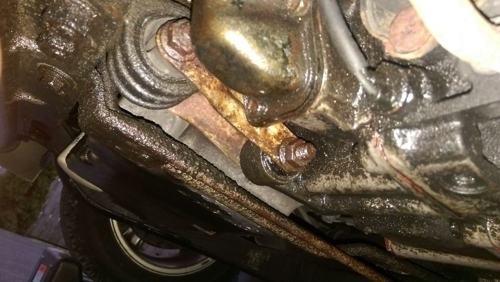

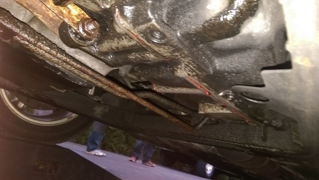

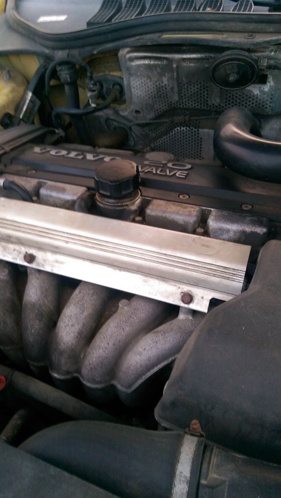

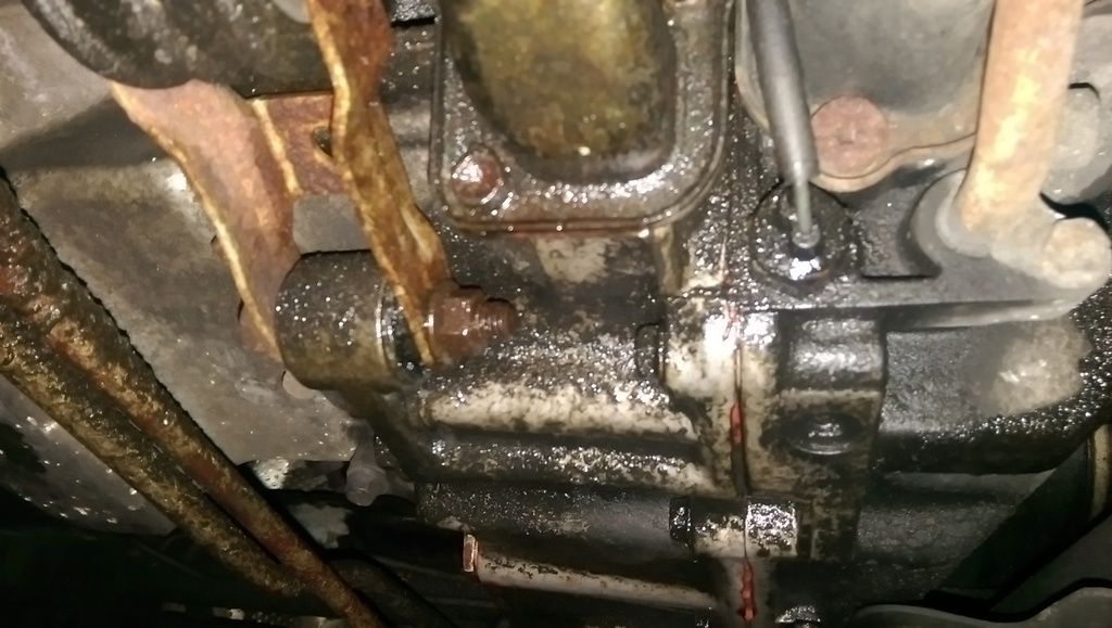

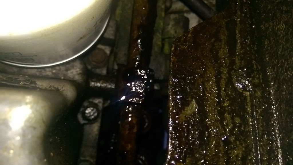

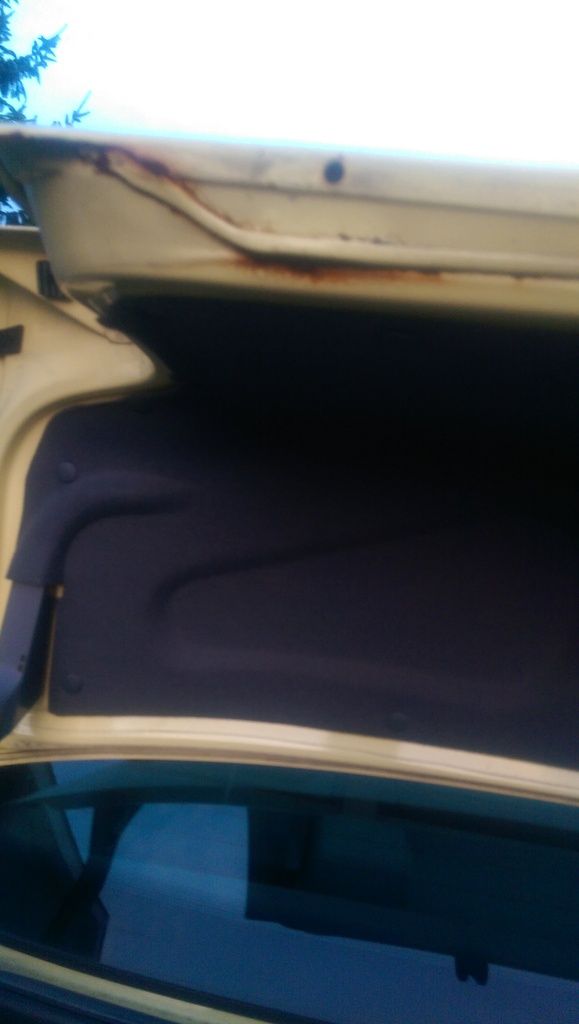

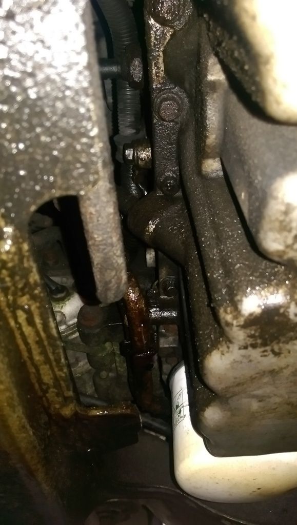

Well looked at it this evening, and overall it was OK but not without faults. Paint isn't the greatest, has some rust on the trunk, overspray on the front from previous bodywork, needs an axle/reboot, looks like it has some turbo oil line leaks, leaking heater core (smell from vents and slow coolant loss), and no A/C (evap was done a few years ago). Other than that, engine and turbo pull strong, transmission is firm but seems solid, timing belt done at 217k, interior is decent, everything works inside, diligent routine maintenance, newer suspension bits (slight clunk from the front though), newer brakes, no PCV smoke comes with a variety of other parts. I'm so extremely torn it's unbelievable. He had me help him drop off the car at a shop to get the A/C inspected so I'm waiting to hear back about that first. I'm not afraid of working on my own cars, I just don't want a turd. I'll attach some pics soon.

I saw this car and it looked better from the exterior pictures. Usual issues for a 95, but the fact it needs h. core, axle, and turbo lines would need to be part of the negotiation of price if you decide to go through (parts and your time cost)
IMO, you can get a non R in much better shape (without your aforementioned issues) for half the asking price of the T5R. Personally, a zippy NA might be the best if you need it for daily driver and quick winter warm up since your in ohio.
If I ever got a T5R, it will only be for novelty/hobby instead of a daily driver. From what I remember, the paint was only single layer, no clear coat. That might explain some of the rust issues if someone did not pamper/wax it/avoid rain/snow

I'd pay 2500 but not 3200, assuming that is not a rear main seal leak underneath, and that the evap core is OK. I agree with mika, it has more issues than the original posting suggests but they appear to be the typical ones, easy to do but will keep you busy.
