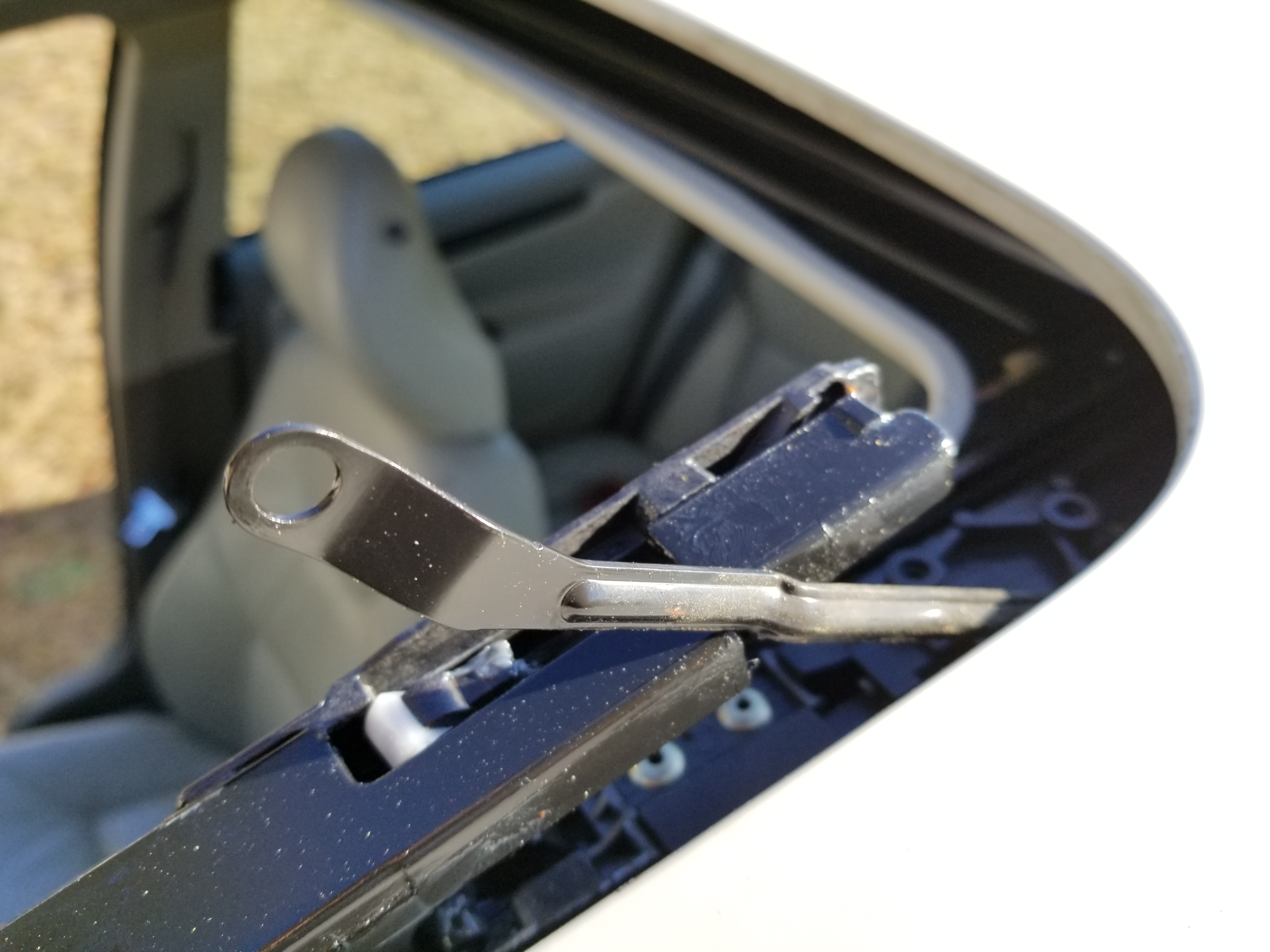

This may be old, but I had the same issue and stumbled upon this forum post, so figured that I would share.

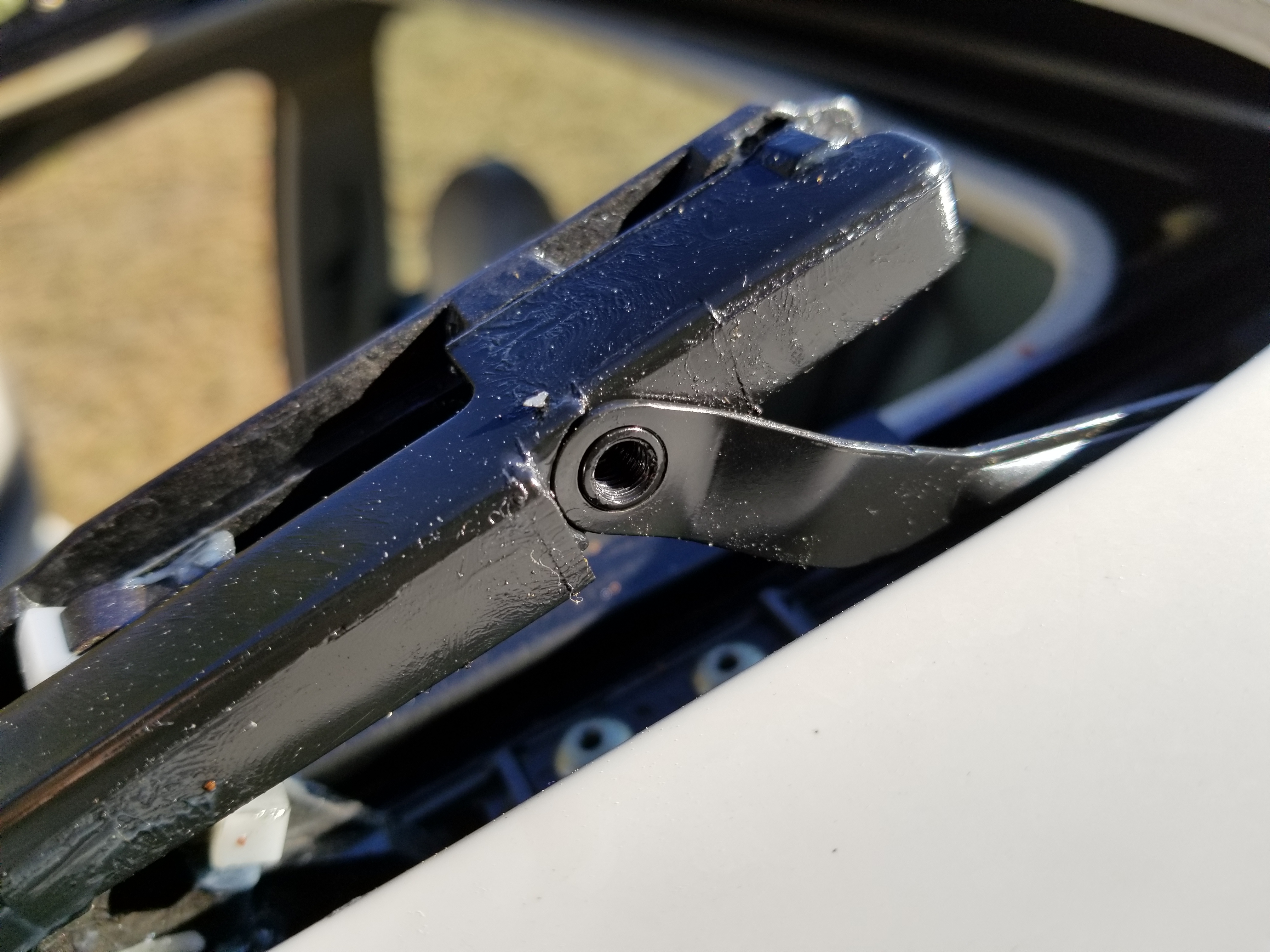

That little tray is a gutter for water to make its way to the drains. It slides back with the glass when the sunroof is open, so it is attached by an arm to the mechanism. There is a screw on each side that takes a T25. Once those screws are removed you can pull the arms away from the sliding mechanism and pull the tray forward to get access to the 4 T15 screws and washers holding the gutter in place.
I took the pics after removing the gutter and the T25 screws holding its arms to the mechanism, but you can get the picture (see what I did there? lol)
I looked at that piece quizically for several days before seeing that little gem.

+1000 for sharing that gem and a beautiful clear picture of the trick - thats what makes the collective brain larger
