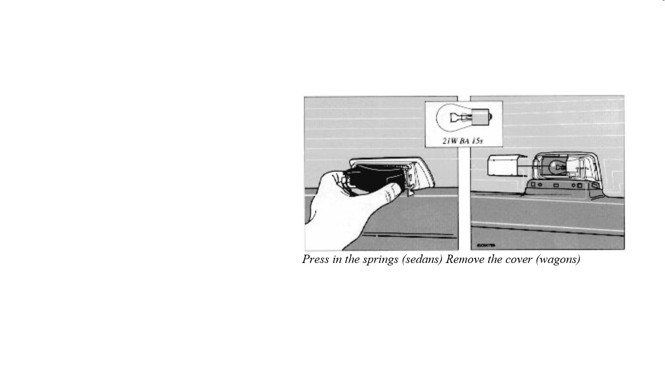

Hey,
I'm having some trouble with the brake light that's located on the rear window (Sedan). It doesn't work and every time I brake, the bulb failure warning light on the dashboard illuminates. I replaced the bulb and it seemed to work then it stopped working again after I replaced another bulb that wasn't working in the tail light. Has anyone else had this issue and what can I do to check for the reason?
Thanks

The contacts at the base of the assembly get loose, they lose their springiness, and you can often get them to work again by bending the contacts on the bottom of the base down.
