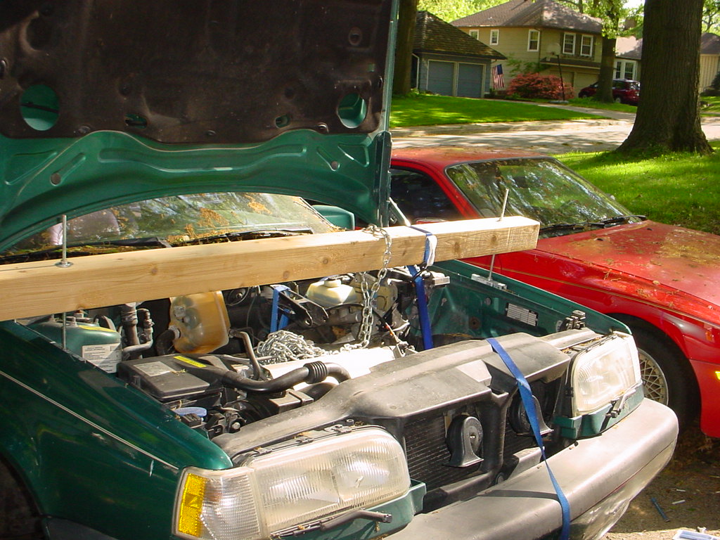

You can see them in this picture. This is an 850 that was in the middle of a clutch job but I think the bumpers are in the same place on a 70 series. I went through my 70 series pictures and I don't have any that really show them.

They are on the underside of the hood roughly just above the edges of the radiator. If you look on the black plastic radiator shroud you will probably see square shadows in the plastic where they land when the hood is closed.
I put a fender washer (or several stacked) on top of the shroud and attached it with a self locking nut and a pan head bolt through the plastic and made an elevated landing pad for the bumper. A fender washer is relatively thin, fairly large in diameter and has a small hole in the center.
Over the years the bumpers shrink and the landing pad fixes that. You can use all stainless steel hardware and it will still be less than $5.00. Or you can buy new bumpers. New bumpers cost more.
If you do it just make sure to be careful that you don't drill into anything you can't see.
