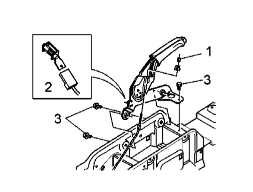

Screen Shot 2016-01-06 at 1.59.02 PM.png (126.03 KiB) Viewed 853 times
Item (2) is the connector for the parking brake lamp switch , this is under the cover on a 1999 but I think your 2000 is the same

Post by hbsluna8 »
abscate wrote:
Thanks for the reply. I removed the center console yesterday and that connector was where it should be. From what I saw, when you activate the e-brake, it causes the connector to pull away and stop making contact. When the e-brake is removed, the connection resumes. Is that how it's designed to work? Nothing happened when I pulled the connector. I will be using a volt meter to see if the wire has current.
