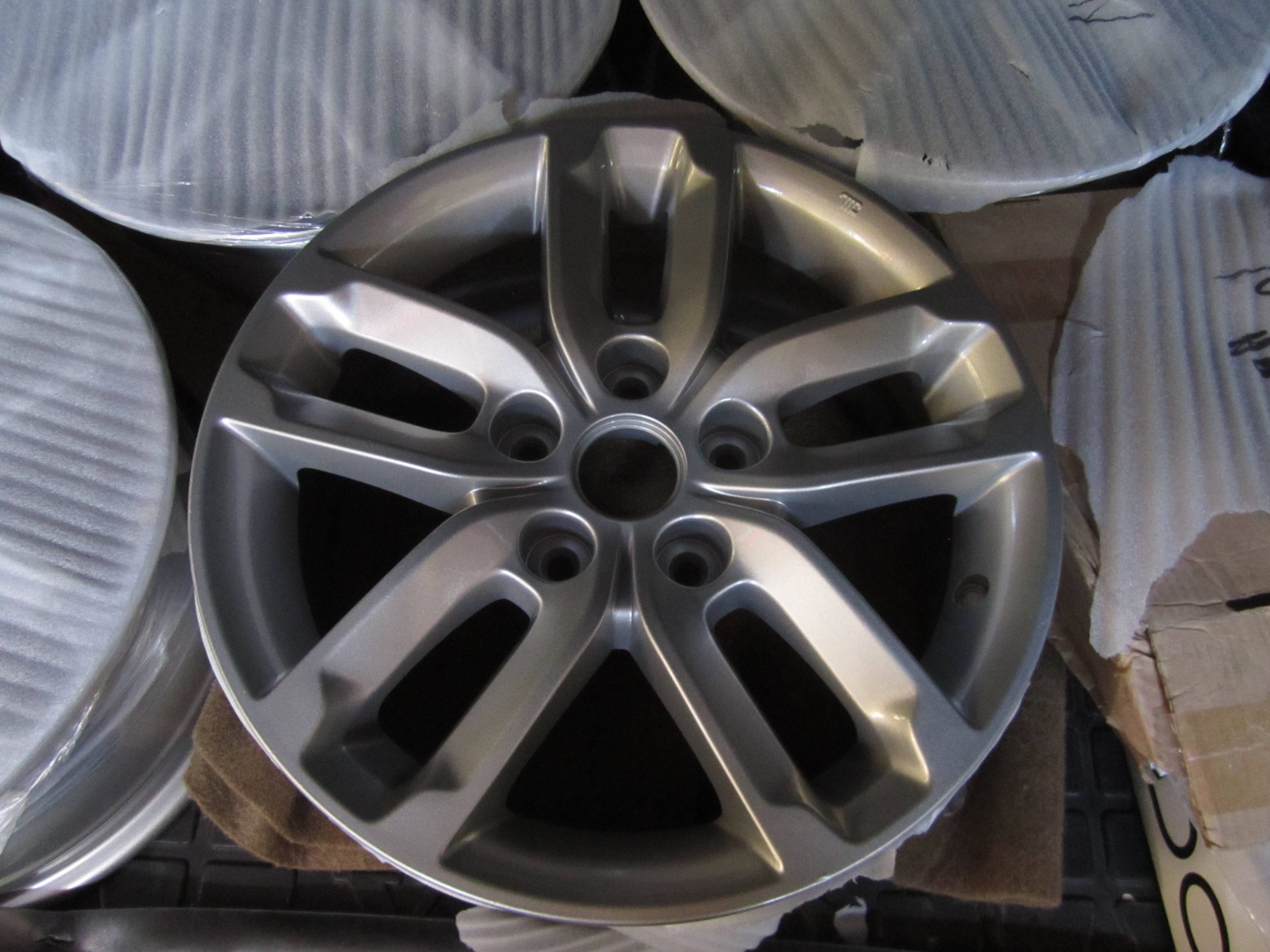

How much would it be to powder coat these? The cleaning process should remove all the loose flaking stuff and a good powder-coating company should rub down the curb rash before coating, In Canada where I live it cost me about $350 for 4 wheels to be re-finished (about 190 pounds). If you plan to keep the car for some time it is worth considering. Also worth checking if you can get a better set for less than re-finishing. You could try yourself and save money, but it is not my personal choice.
Below is a photo of some Kia wheels I had re-done last year:
Re-finished powder-coated wheels
The other advantage is I find the coating doesn't scratch or chip as easily as painted wheels.
