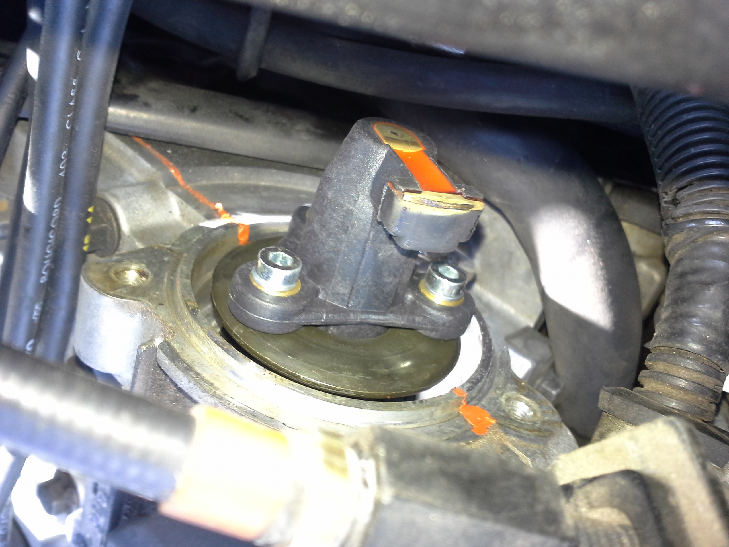

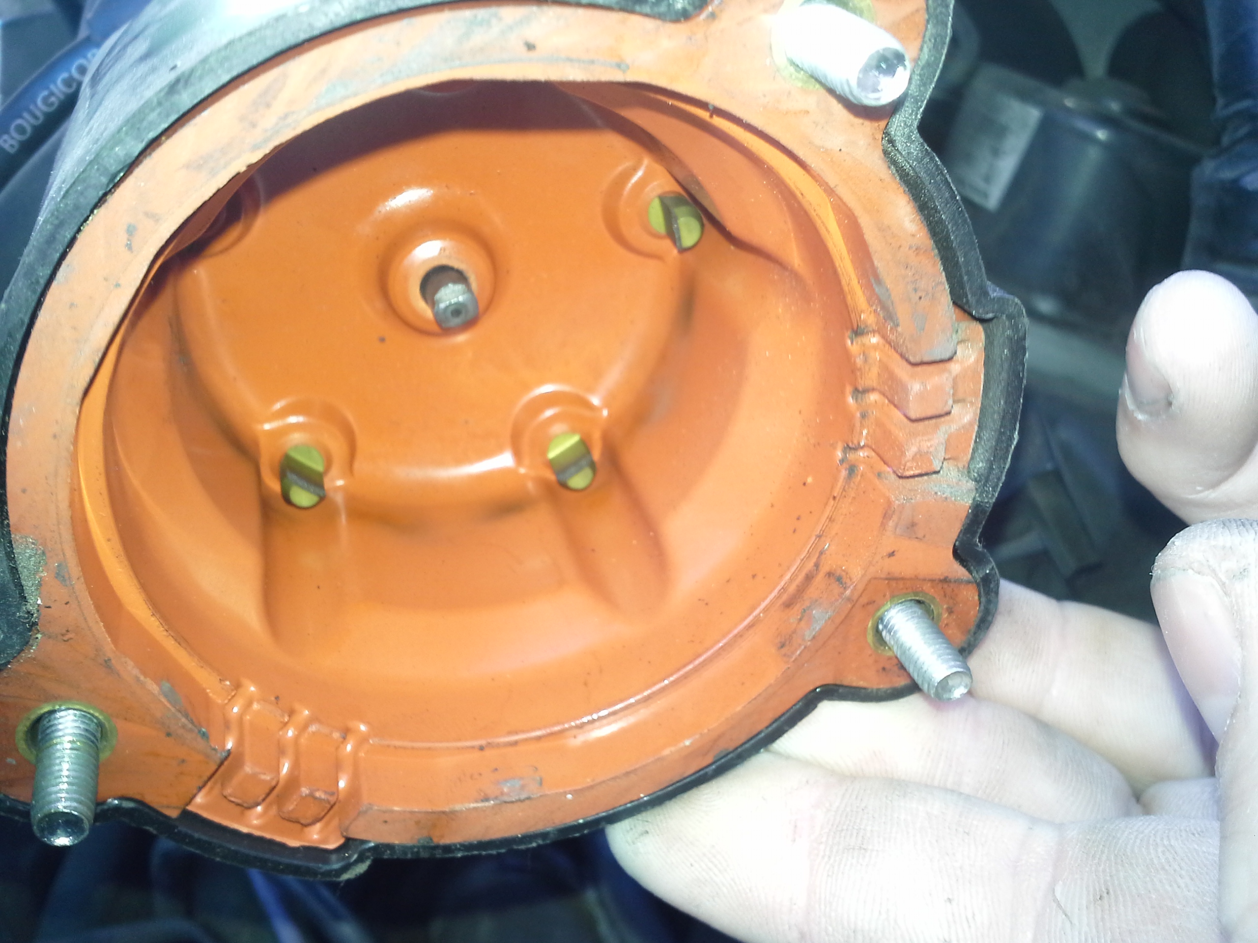

How does the distributor cap look? A rear cam seal leak can foul the cap with oil and that can come on suddenly which is how you describe the onset. The fuel pressure is good which is great news with an XC.

thanks for the reply ill check tomorrow and let you know. the cap and rotor are about 1 year, so i didnt even bother checking. but considering the amount of oil leaking from my rear cam seal, this seams like a good lead. thank you Lee. ill let you know what i come up with

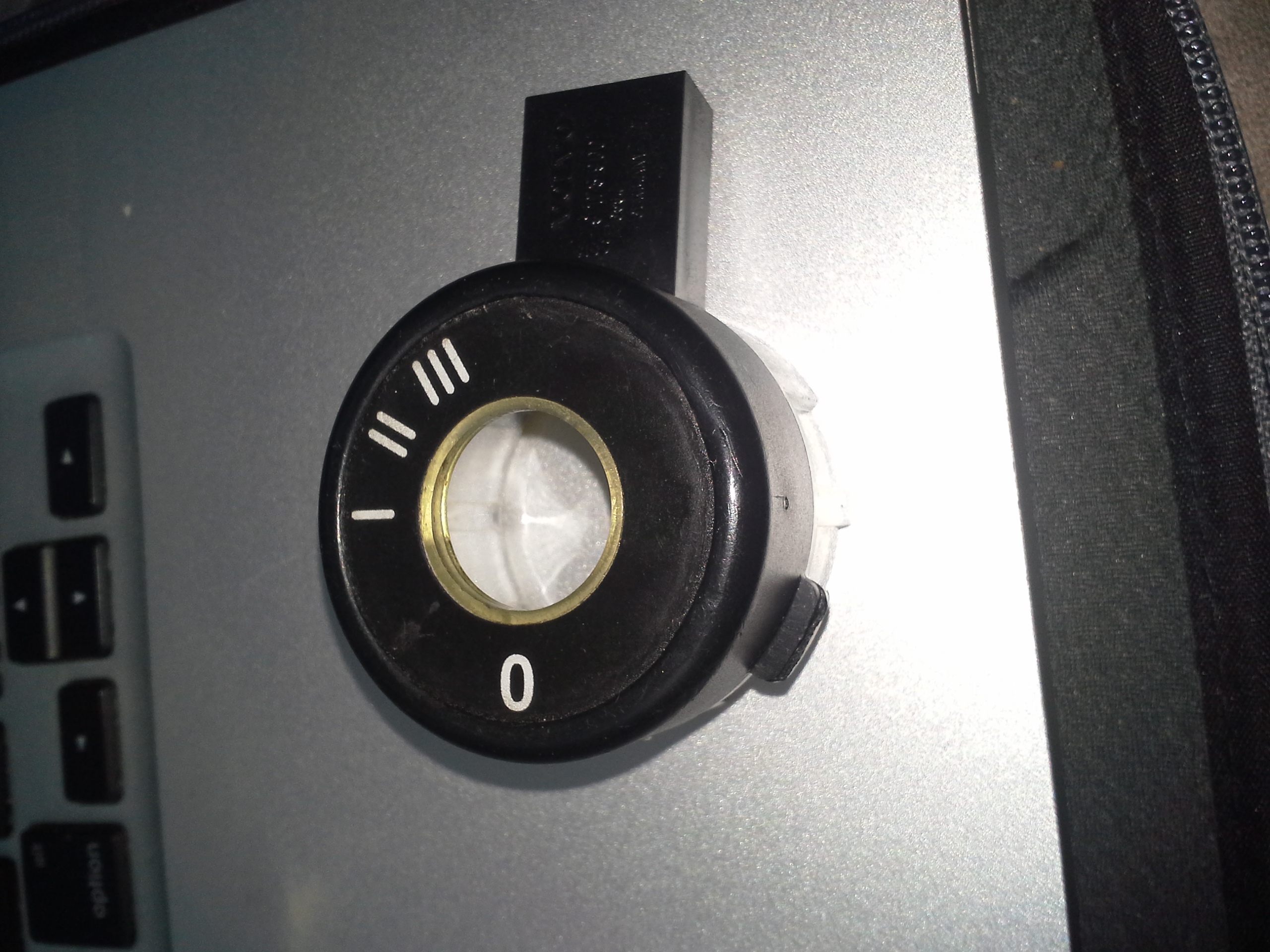

Check the antenna ring by the ignition switch, that apparently can cause your symptoms.

Oily distributor. Send pix!

That was my first thought as well but the North American version of the '98 model doesn't have a chipped key.Cees Klumper wrote:Check the antenna ring by the ignition switch, that apparently can cause your symptoms.

The tittle says 1998 but the manufacture date is late so it does have the antana ring and the key is chipped. Going to check the cap and rotor now. No engine codes. ill keep everybody posted. thanks
