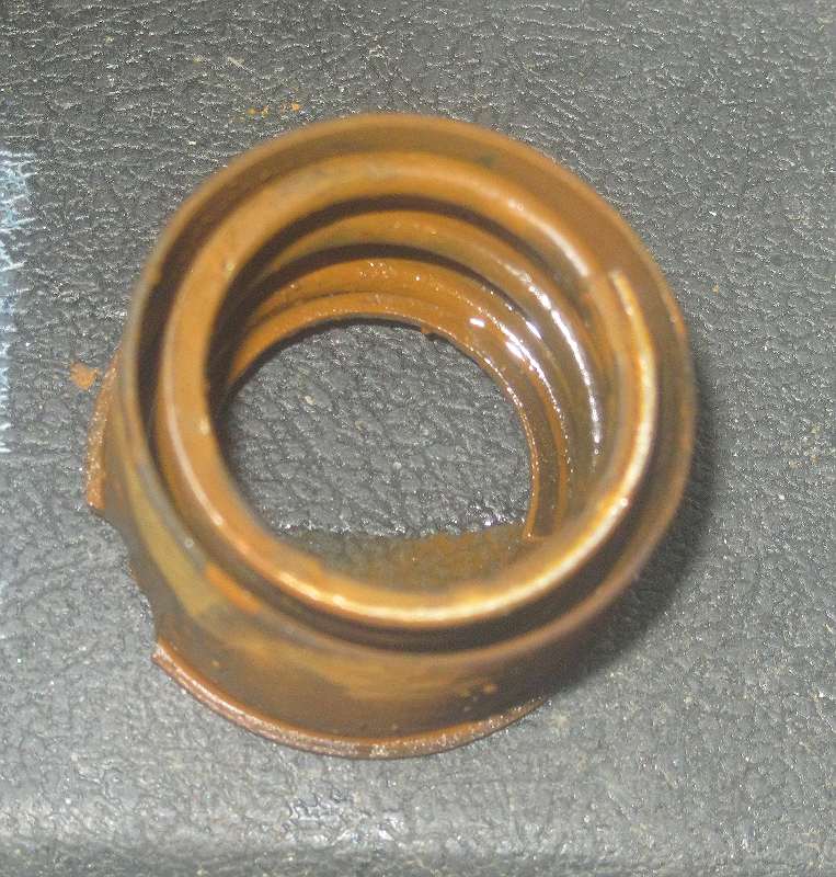

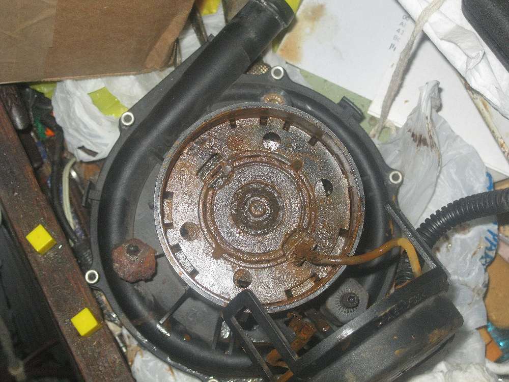

I decided to take apart the old secondary air injection system air pump just to see how they made it and why it might be so expensive in some places (like $600 USD).
It isnt that complicated. Just a thin blower fan (mini turbine) and a motor, and some bearings and a spring and connector, and of course the housing.
I had to drill the tops of the rivets to get the top off, and the bottom where the motor was came right off with the tabs.
The pics are shown in the attachments just in case anyone else wants to see the internals. The spring goes on the back of the motor between that and the back of the case where the wires come out. This particular model was the ORIGINAL dated 1998, and has raised lettering that reads, "Pierburg".

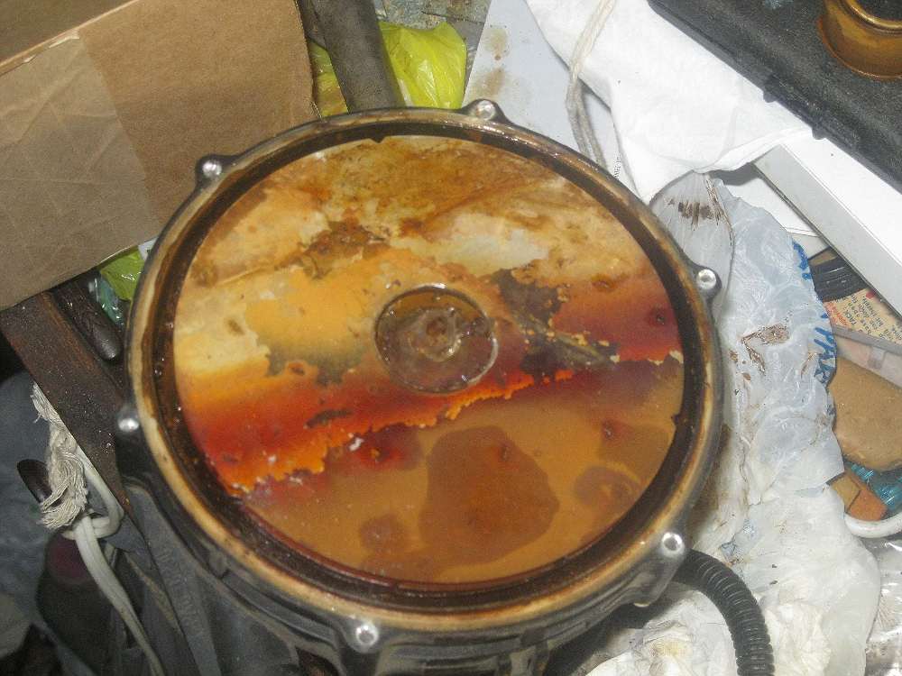

If you look at the top (the pic with the big round rusty thing) you'll see the fan blade part, and if you look at the center you'll see a beat up shaft or something in the middle. It looks like it is pressed on or something and if no one here knows how to get that off i'll have to grind it off, just so i can get it completely disassembled for better viewing of the entire thing. I tried turning the fan with vise grips but it wont turn as the bearings must be completely frozen from rust.
So if anyone knows how to get that off that would be nice, or else i'll grind the heck out of it until it comes loose.
The motor is pretty big, maybe bigger than the windshield washer motor, but i dont have any specs on the speed or torque or anything like that.

Yes, it's nasty looking and fully rusted up so nothing turns at all.
The pump was not even on the car when it was purchased, i had to ask the guy to find it and give it to me so i could see what one looked like, and also to get the bracket that goes with it which is required for mounting the new pump.
I have read that condensation from a faulty 'control valve' can cause the bearings to freeze up, but this almost looks like it was in a flood at one time.
