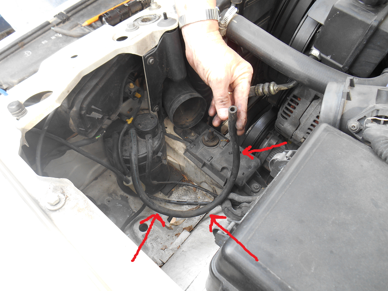

Hello, I have a 1996 960 Wagon. Had a P0172 code. Was looking for vacuum leaks when I saw that one of the hoses from the vacuum canister was not connected to anything. I can't find where it connects to. Has massive vacuum leak. Picture of the hose attached.
Thanks for your help -Doug
a picture of the detached hose

DooMan wrote:Hello, I have a 1996 960
960 Charcoal Vapor Canister Replacement.
Vacuum Line Notes. The vacuum lines to the vapor canister are printed on the vacuum diagram under the hood.
