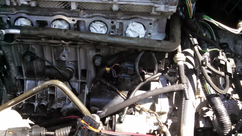

help does anyone have some pics or a diagram of the vacuum hose connections on a volvo v70 xc turbo , just pulled and re installed intake, now hard start, skipping, and a hose directly on the top of the intake ,like 3/8 is collapsing under vacuum, before a little black box with 3 hoses was clicking while engine was running smooth, now no ticking/clicking? i need some pics or diagram.

Google "volvo xc70 vacuum diagram" and switch to images - there are plenty of schemes/screenshots/photos.

The vac hose that goes into intake between cyl's 2/3 comes from the T connector resting on top of starter and has a 1 way valve in line with arrow pointing to manifold. Make sure check valve has correct orientation.
