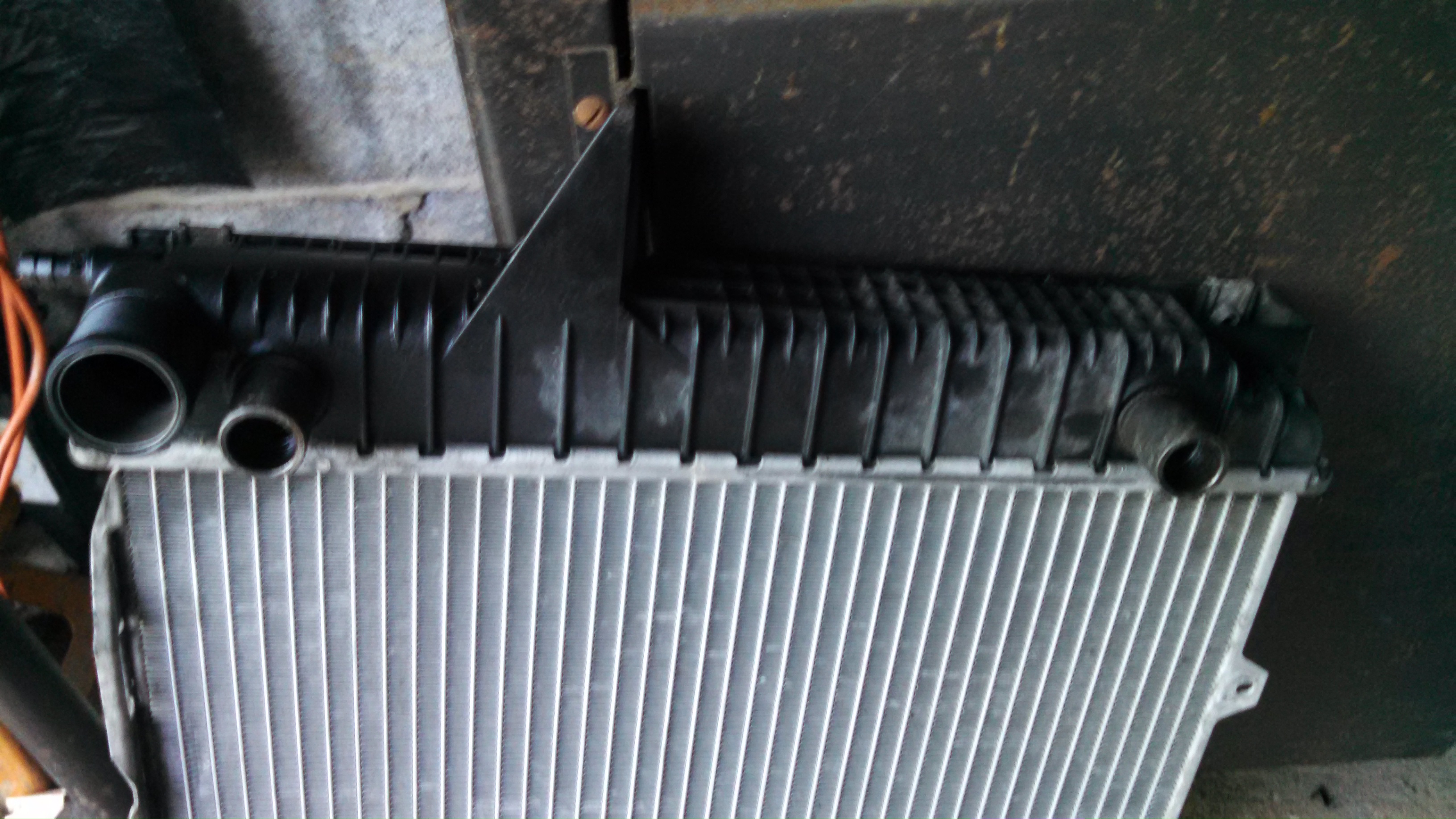

My 1999 C70 has the trans lines, with the plastic green clip. There is a cylindrical receptacle on the radiator. I am replacing the radiator.

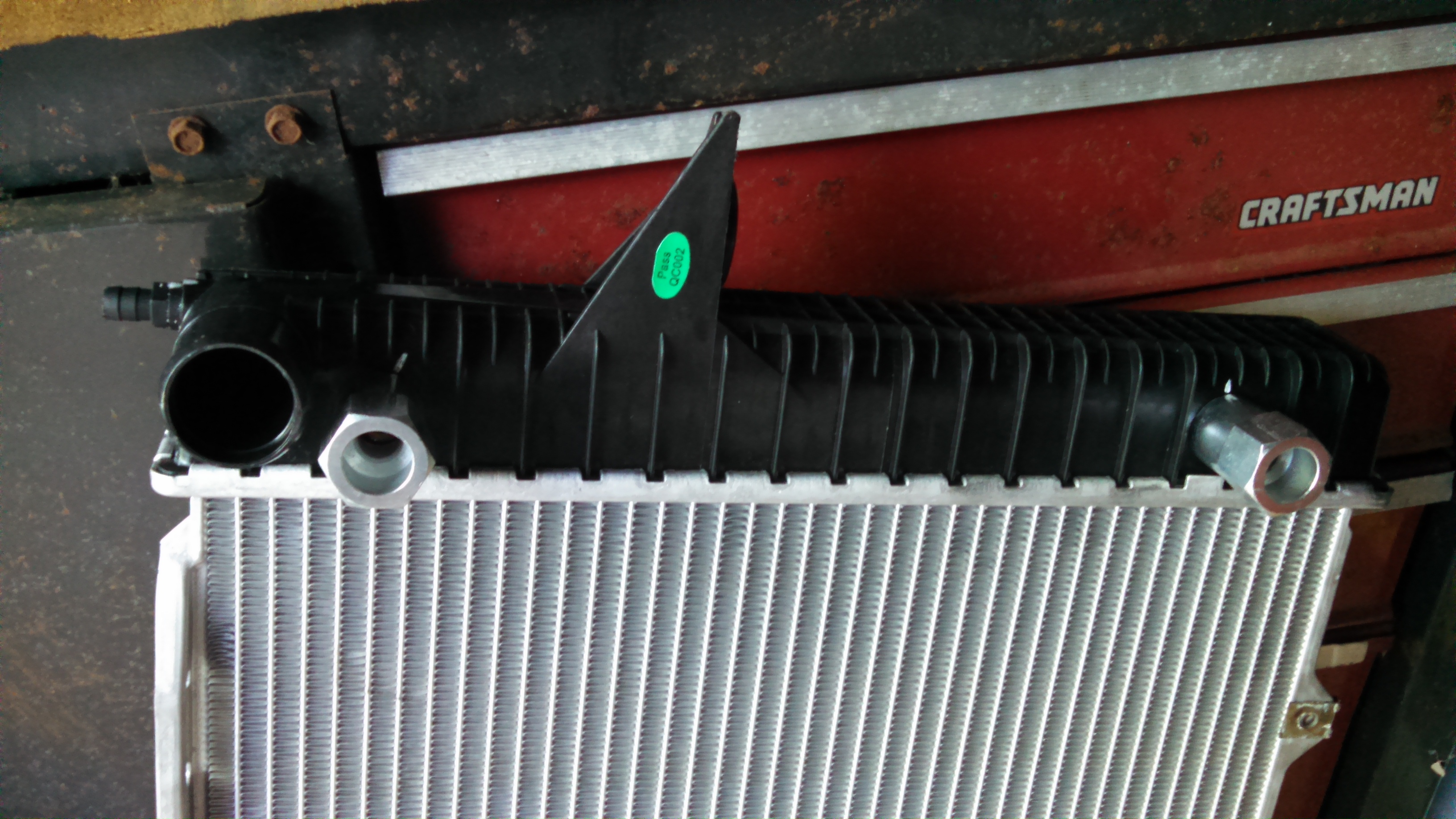

My new radiator has receptacles for the trans lines, that look quite different. They appear to have the same inlet size, yet have a taper inside at the bottom. They also have a big hex cast on the receptacle. That hex faces the vehicle.
My question is will my existing trans lines work properly with this receptacle that is on my new radiator ? Thanks for any input.

This is my original radiator
c70 1999 radiator
c70 1999 radiator

This is the radiator that I just purchased.

I have not mounted the new radiator yet. I was hoping to get some confirmation that the trans line receptacle on the new radiator,(2nd picture) will work with my line conection (3rd picture). Thanks

The fittimgs are correct in your photo and typical of aftermarket radiators such as Hella-Behr, Nissens etc.
I have a XC 2001 with the same fittings. Also I just fitted the same type of radiator to a 1999 V70. Internally the diameter is correct for the trans line fittings.
Just be sure to lube the o rings so they don't get torn up.
