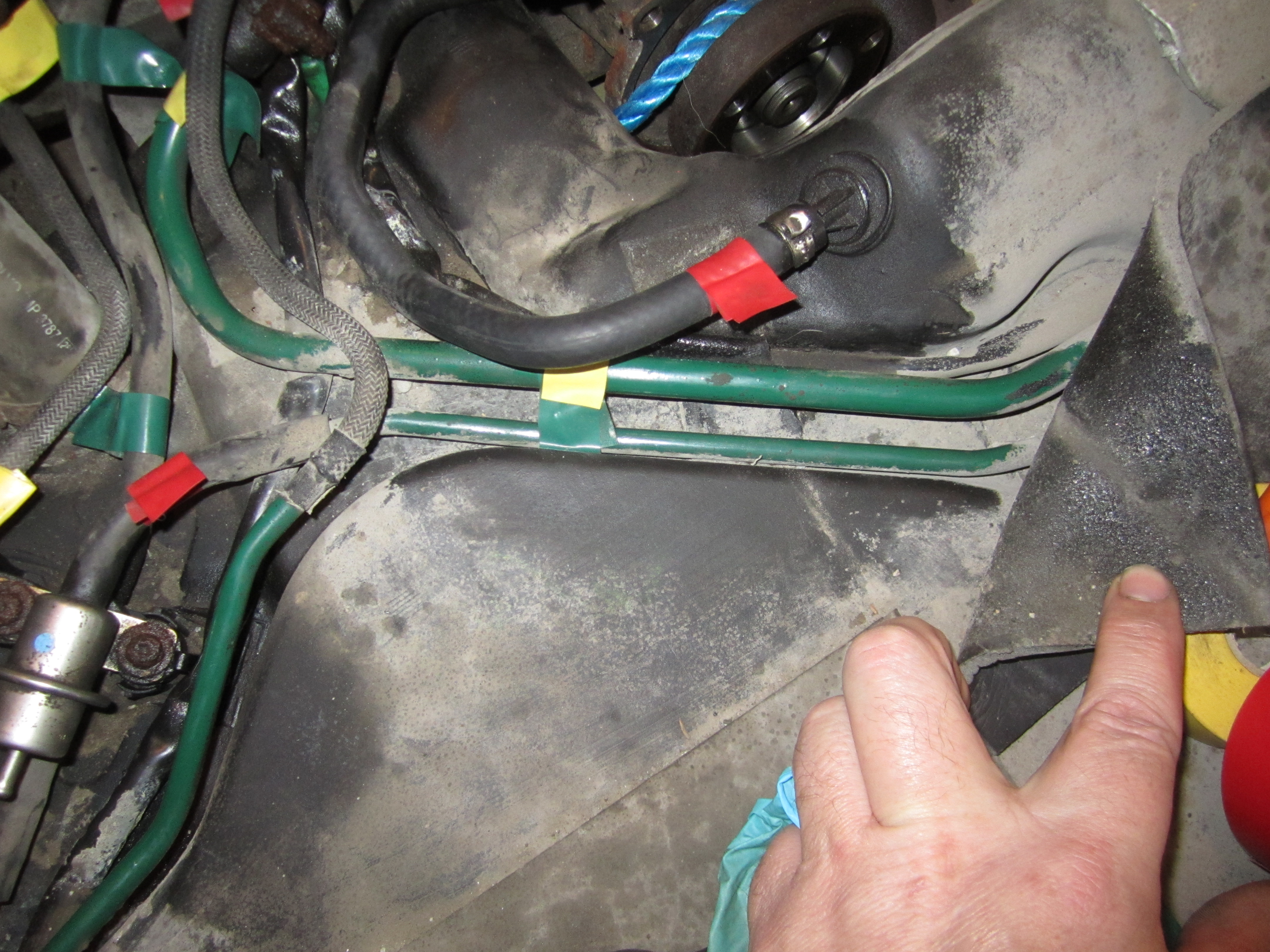

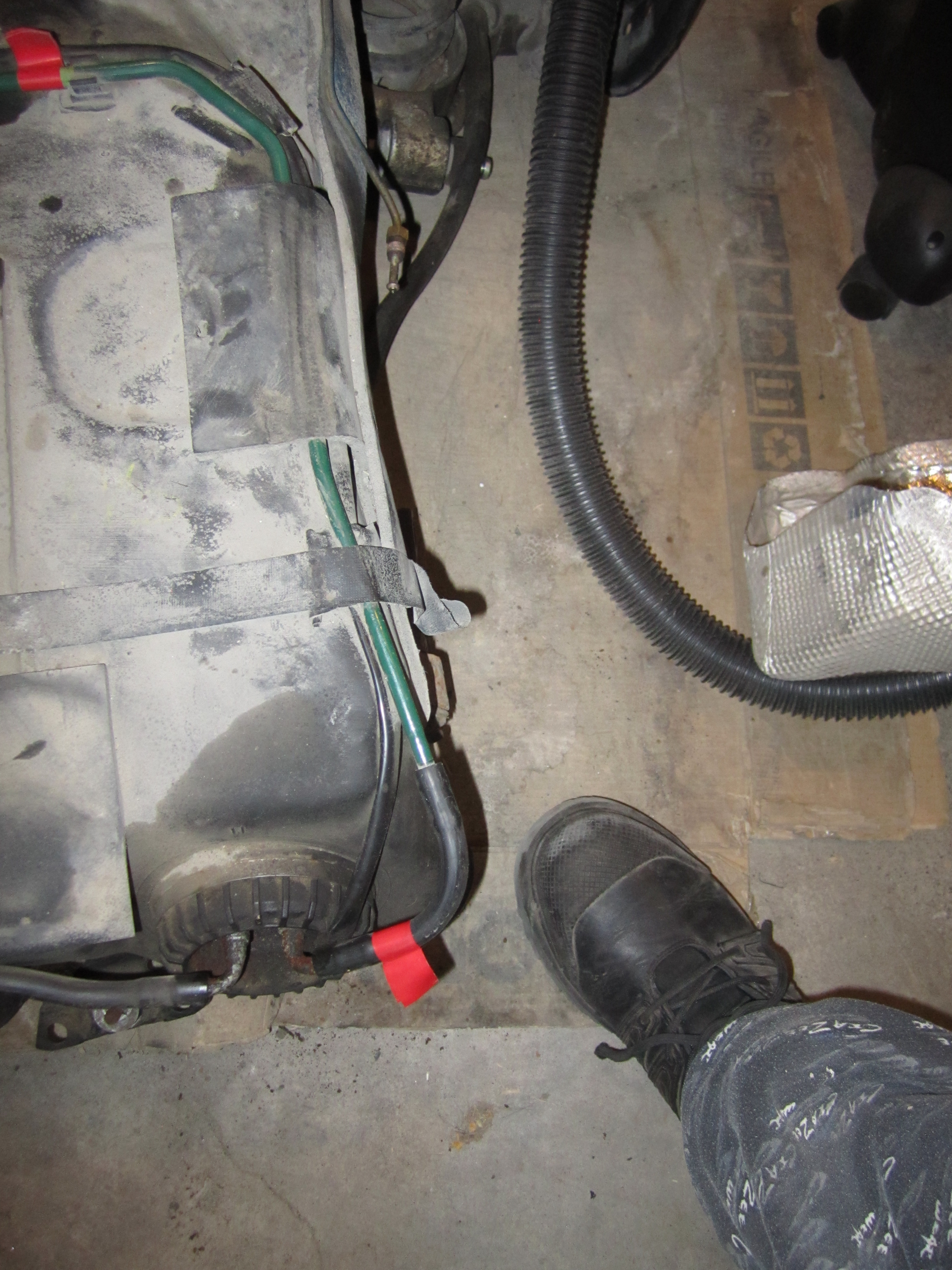

The second pipe I have no idea. It is the pipe that runs from the LH fuel pump up to a valve(?) and then has a 'T' into the vacuum pipe from the carbon filter to the front of the car.
The pipe is the green one running from the LH fuel pump to along the LH side of the fuel tanl. then runs across the tank to this valve:
Pipe is the narrower green pipe that runs horizontally across the picture to the silver valve on the LH side of the picture. The 'open' end of the valve has a shot pipe that 'T's' into the emissions pipe from the carbon filter in the back of the car and runs all the way up to the radiator are in the front.
Any help is appreciated as both pipes are badly corroded where they connect to the LH and RH fuel pumps.
Any advice as to what the valve is (fuel pump regulator??) and the part number are much appreciated.
