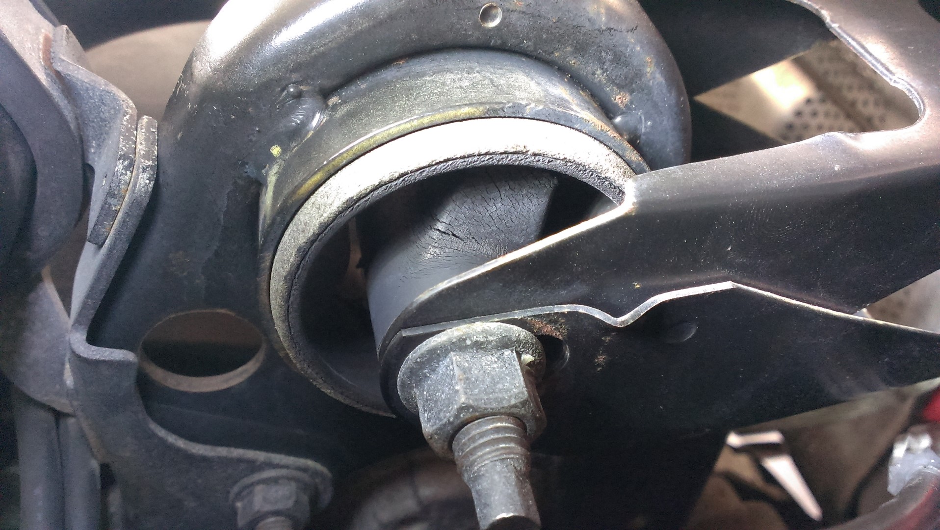

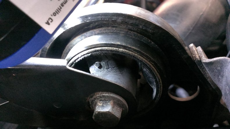

Misha,
What a call! Here is the upper engine mount:
and here is what I have seen of the lower engine mount so far:
I also have a massive oil leak under there. Doing pcv this weekend, but I think it might be too late as far as seal damage and may be doing some terrible seal replacements. The leak is dripping right onto the lower engine mount (along with about everything else under there. That coupled with age probably killed it. Is there anything else I should be looking at when doing the mount replacement?

Nothing else can make loud vibration and shaking the whole car like that mount.The same piece of mount i found few years ago when i bent a protective plastic shield to check is it still there.
When you start changing that mount,you will need two jacks.One to lift the car and to remove the wheel and other one to put just under oil sump.A piece of wood that will fit between the sump and jack is required in order to support oil sump properly while you changing the mount.You will need to lift the engine a little with a jack under the oil sump to remove the mount and to install new one.After you put it in it's place,you will need to nivelate an engine a litlle with a jack to properly install a new mount.

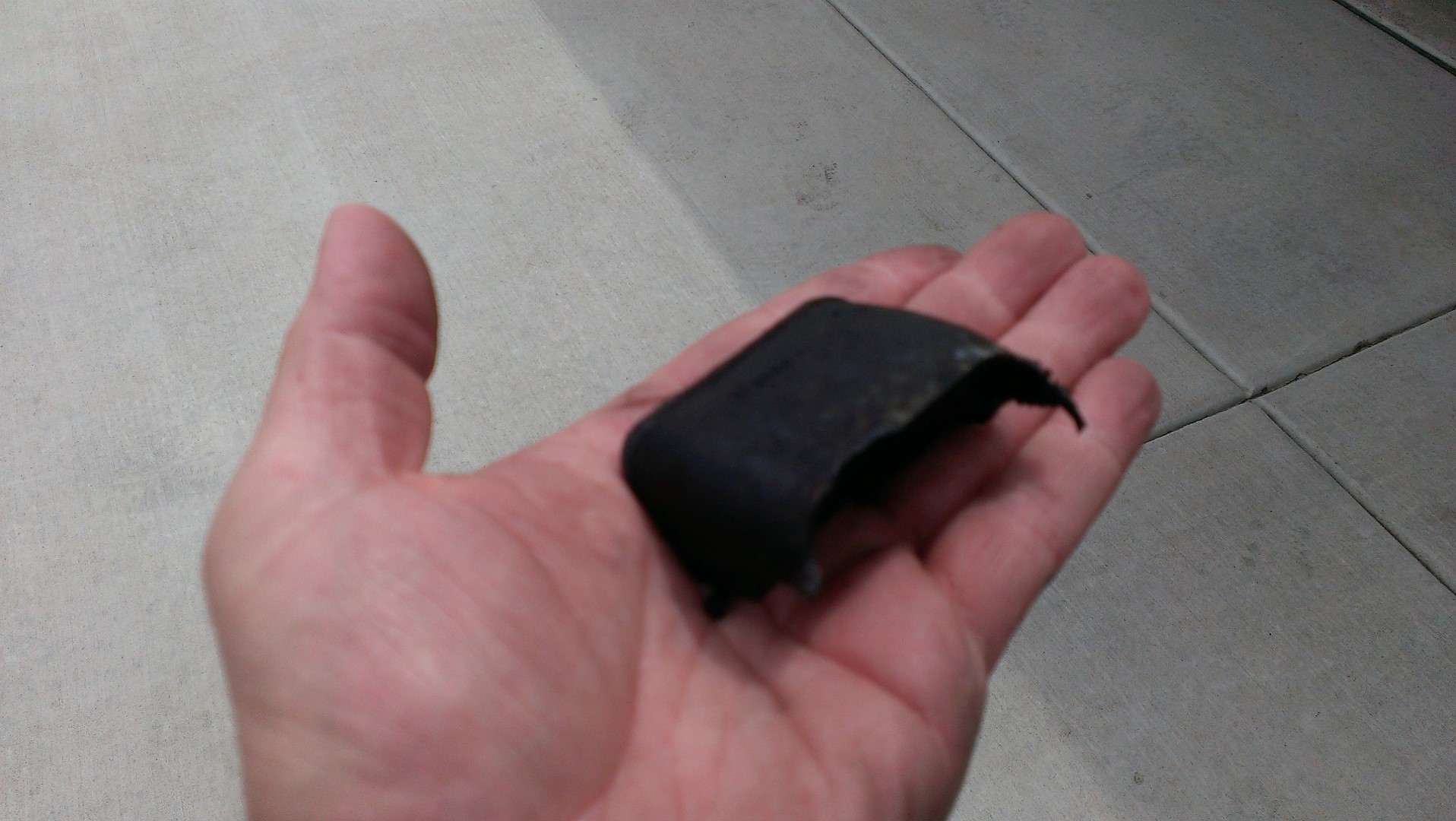

Top one is severely cracked and dry, as are the front and rear, but not broken. Lower one on the side is in pieces. I figure the car is almost 20 years old, and if the rubber on the lower is falling apart, the others that are showing wear and age are soon to follow. As we have no intention of getting rid of this car, I am just doing them all.

Just as a follow up, replaced the lower passenger side engine mount and the vibration issue was fixed. Still need to do the other mount, but they are not disintegrated like this one. Thanks for the help!
