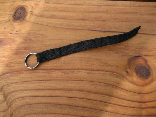

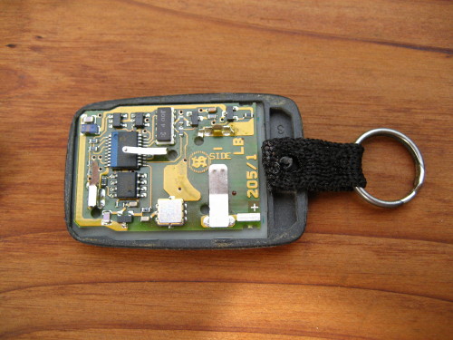

Here's what I ended up doing.
I got some 1/4" wide nylon webbing, and folded it over the key ring which I salvaged from the old fob. Then I stitched it together firmly using a needle and nylon thread. I used lots of stitches so the two pieces of webbing would behave as one. Then I cut the webbing to length, about 3/4", and used a lighter to melt the ends so it wouldn't unravel. I held a nail in the flame to make it hot, and used it to melt a hole in the webbing near the end. Then, disassembling the key fob, I placed the nylon webbing in the gap in the case, with the plastic stud poking through the hole in the webbing. Then it's just a matter of snapping the case back together, being careful not to get the webbing caught between the case halves. I used a drop of glue on the end of the plastic stud to keep things from separating, but I don't think it's really necessary.
This has been holding for 5 months, and isn't showing any signs of letting go at all. Thanks everyone for your ideas!
