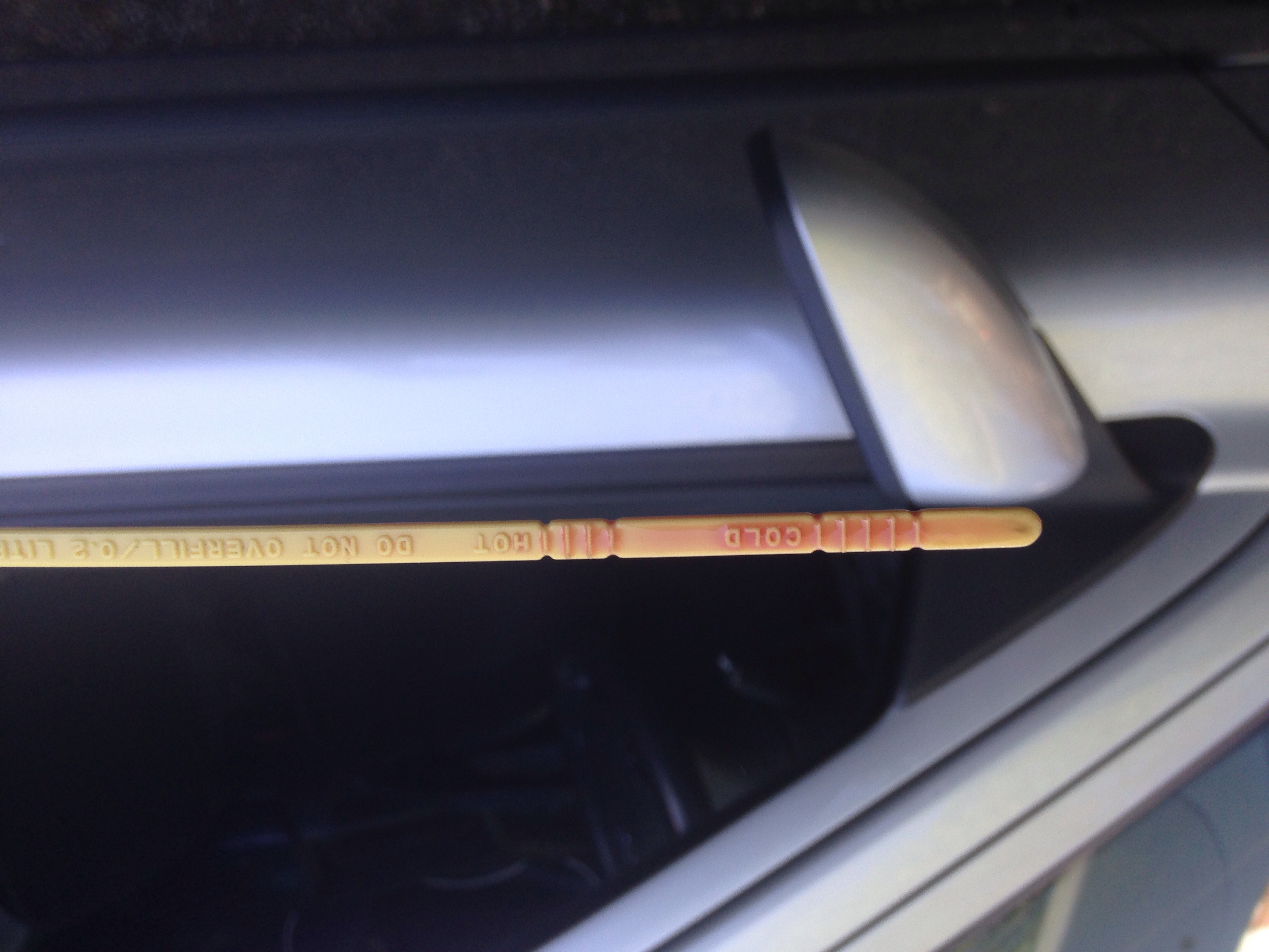

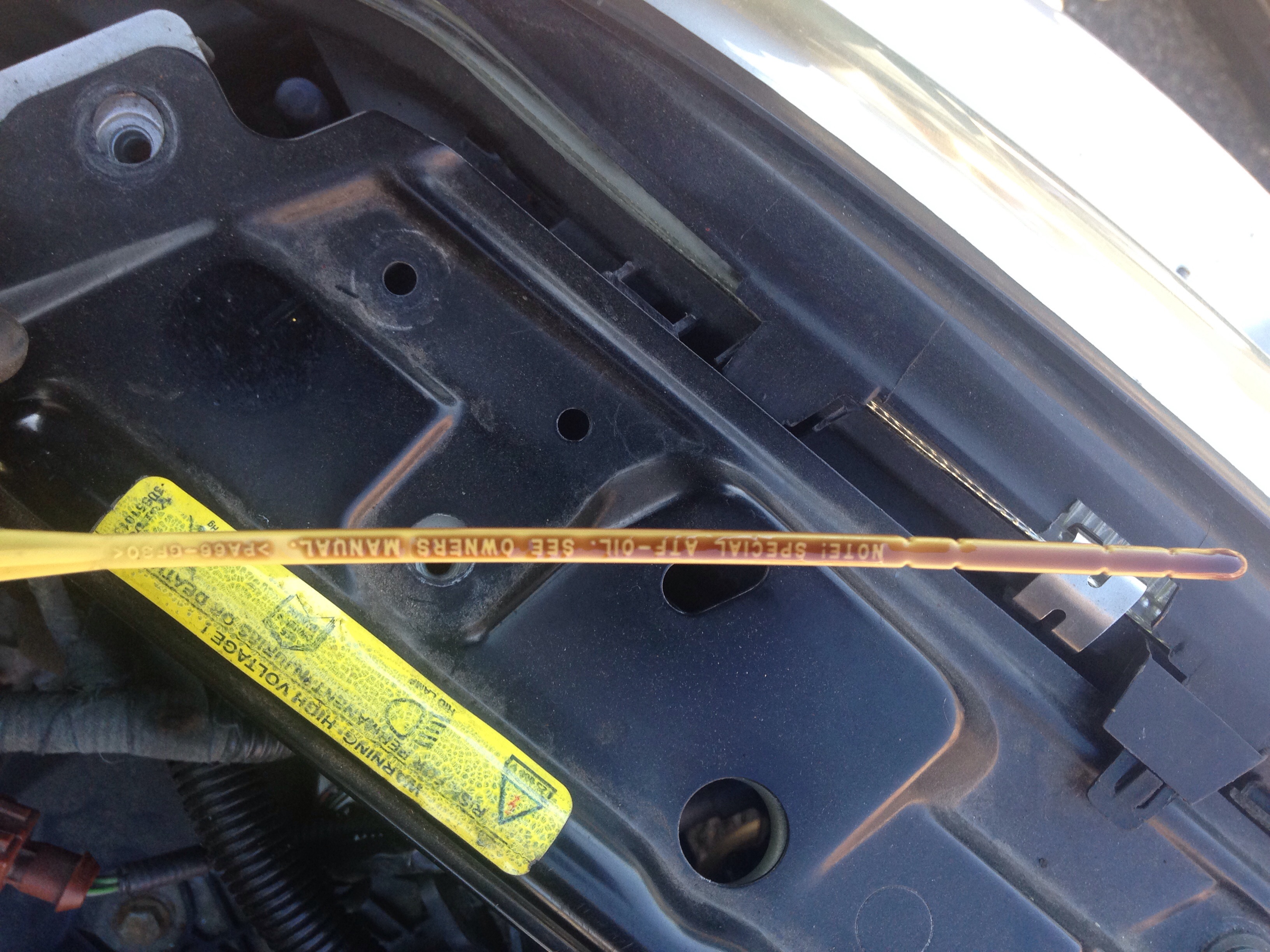

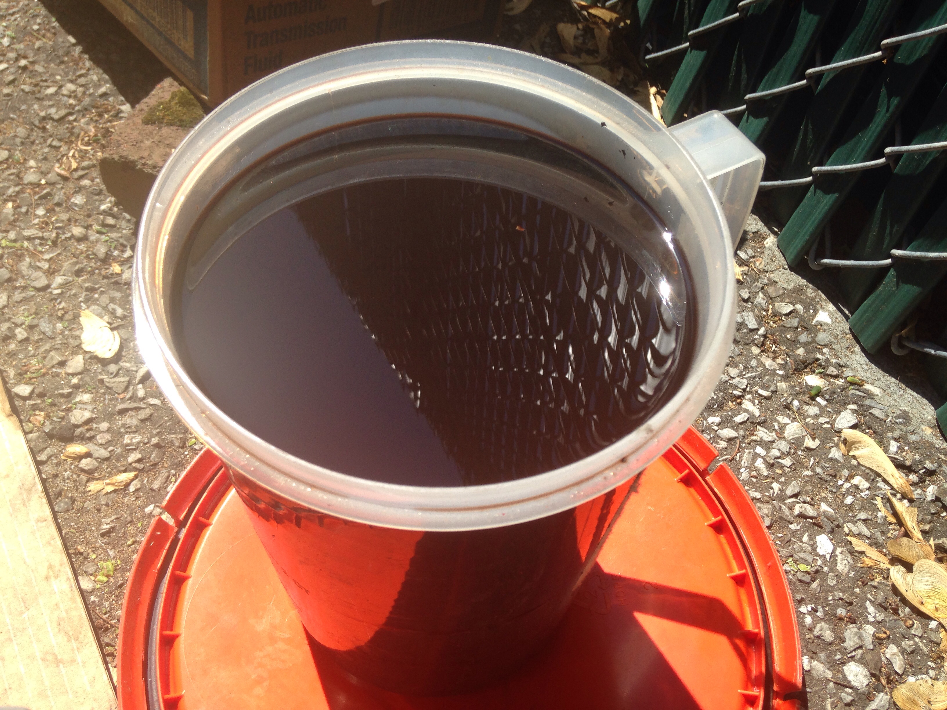

P2 04 V70R Transmission Flush
6 3/4 quarts of (dark) colored fluid came out of the pan. Cleaned drain plug and magnet. To my knowledge their should not be more than 3 1/2 of quarts coming from the pan. So I'm going to replace 3 1/2 quarts and continue my flush/fill from the BOTTOM tranny hose from the Radiator per IPD flush instructions
