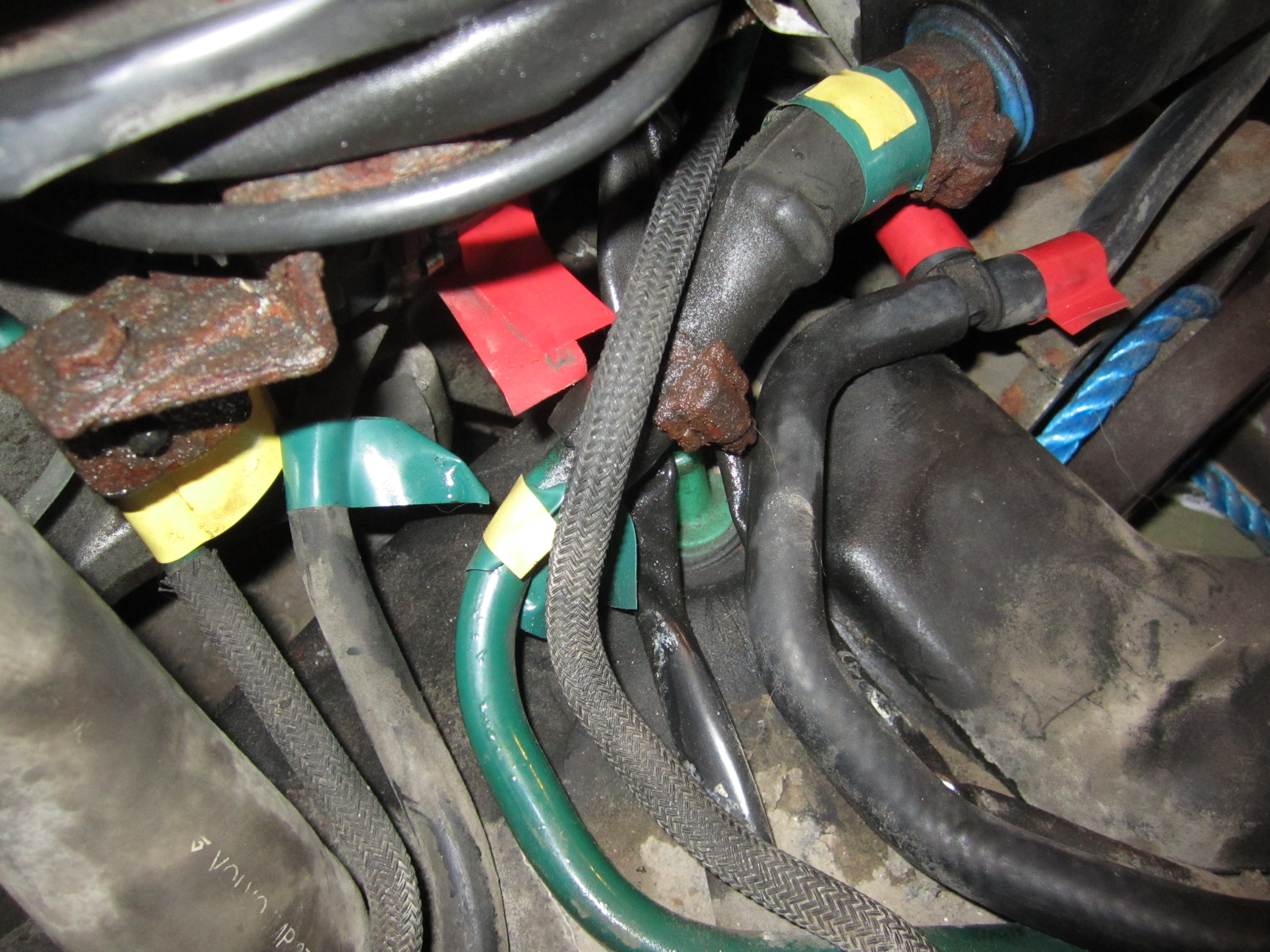

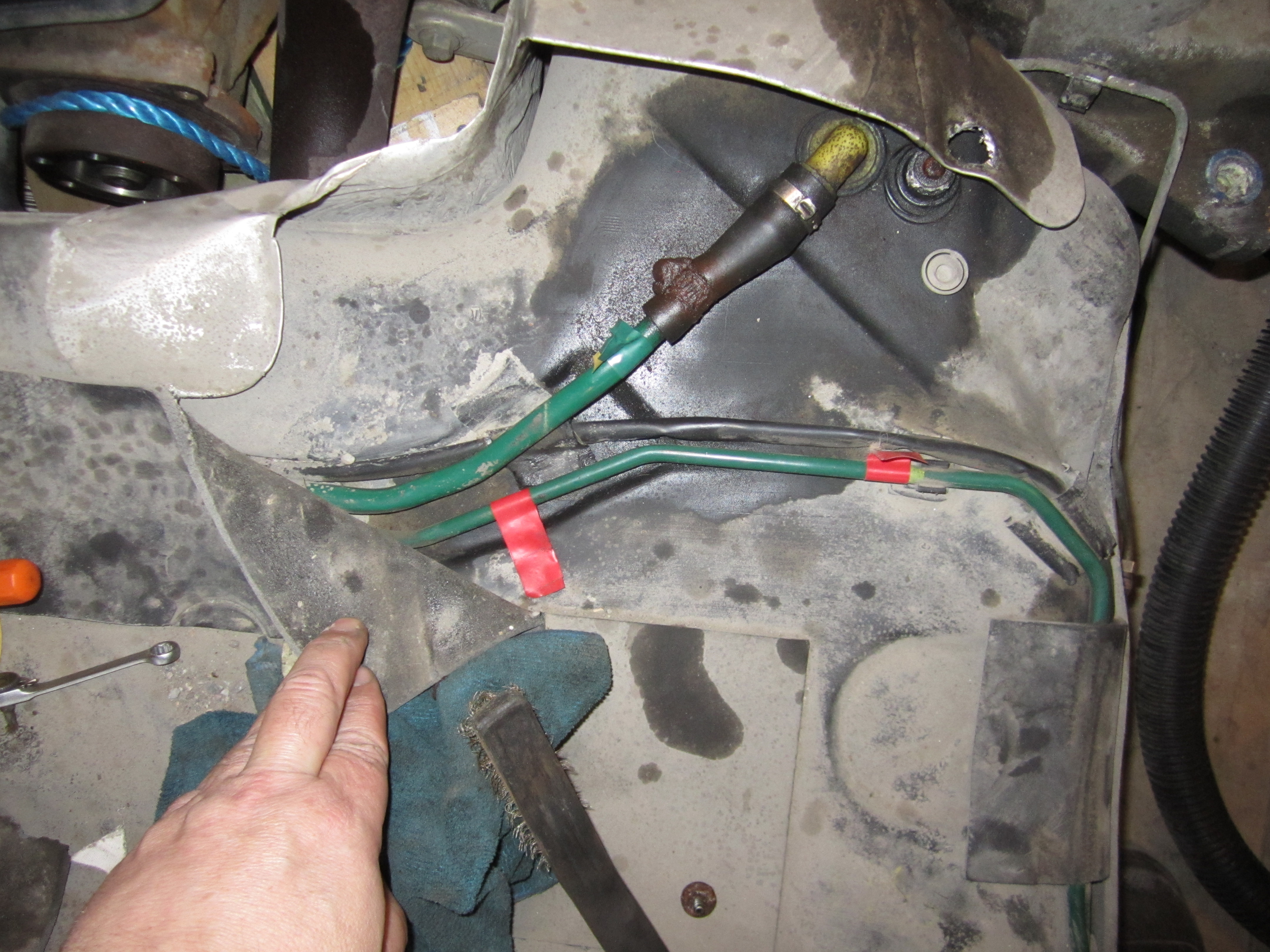

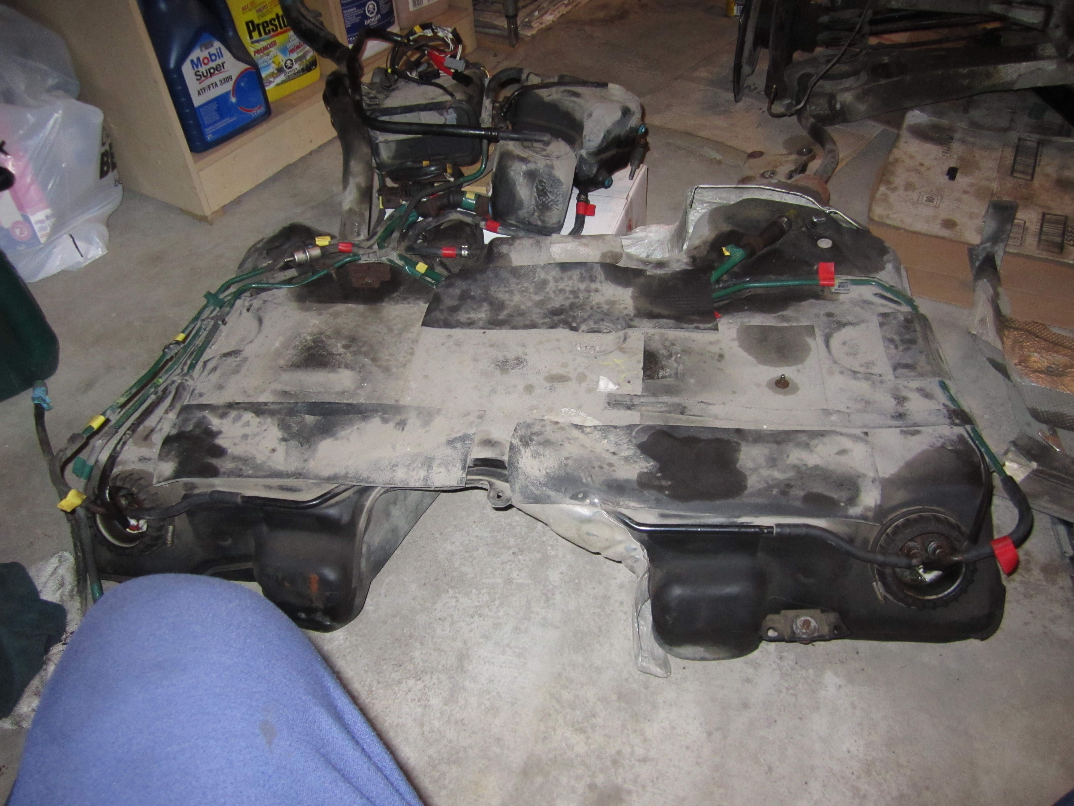

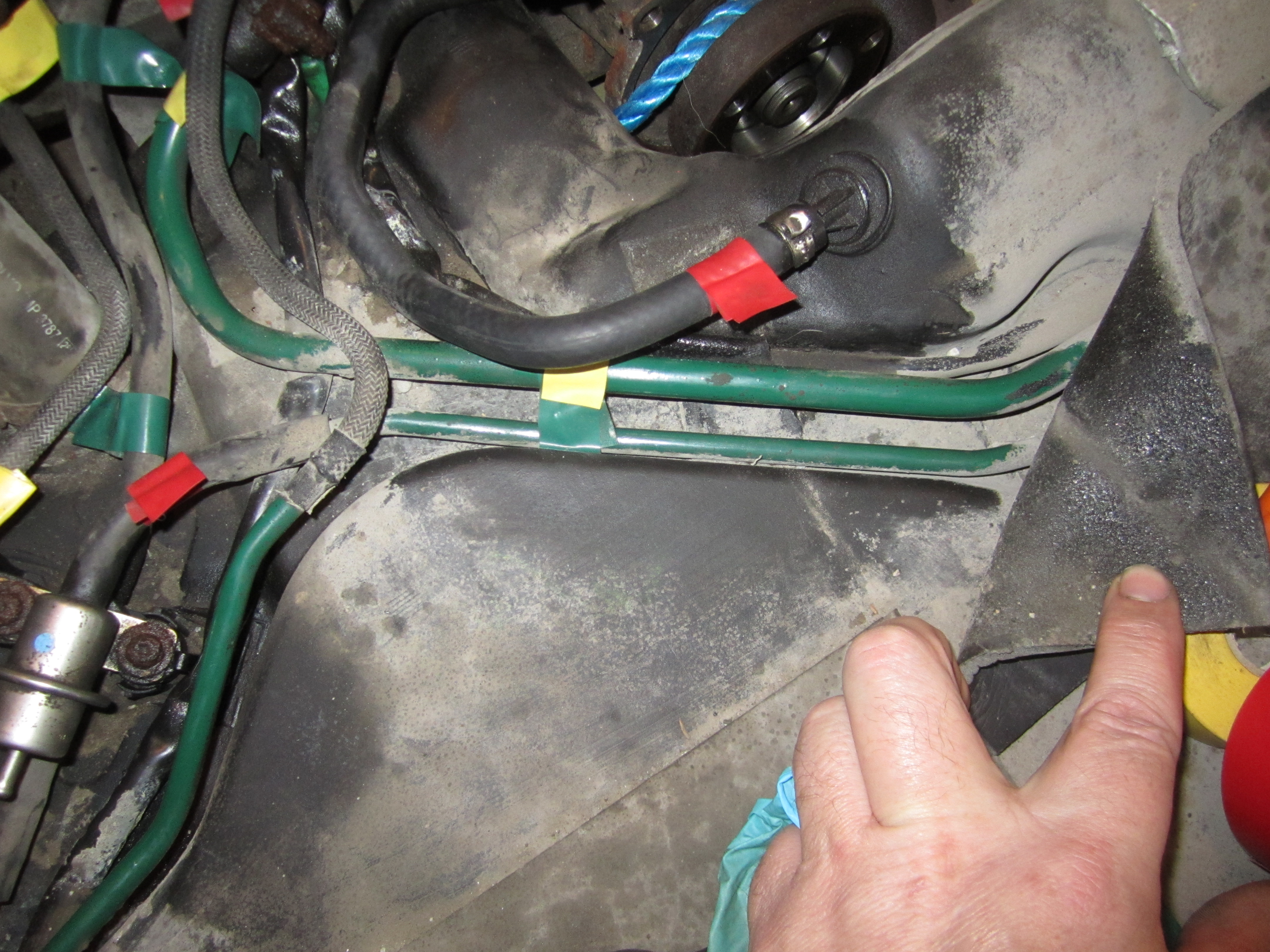

1) Vent pipe: Volvo part # 9445494. This runs from the top rear left of the tank to the lower connector of the smaller header tank
For orientation. Top right of picture is rear LH of tank. Closest to you in picture is front of tank
Pipe is the one with the rubber end piece to top of the tank.
The pipe runs across the top of the rear of the tank and is the larger of the 2 GREEN pipes in the middle of the above picture.
The end of the pipe is the large rubber ended pipe with the YELLOW/GREEN tape on it.
I may have to leave it but the rubber ends are looking tired and these cannot be bought either. I have thought about replacing the heavily corroded clamps, but am worried it may damage the rubber replacing them.
