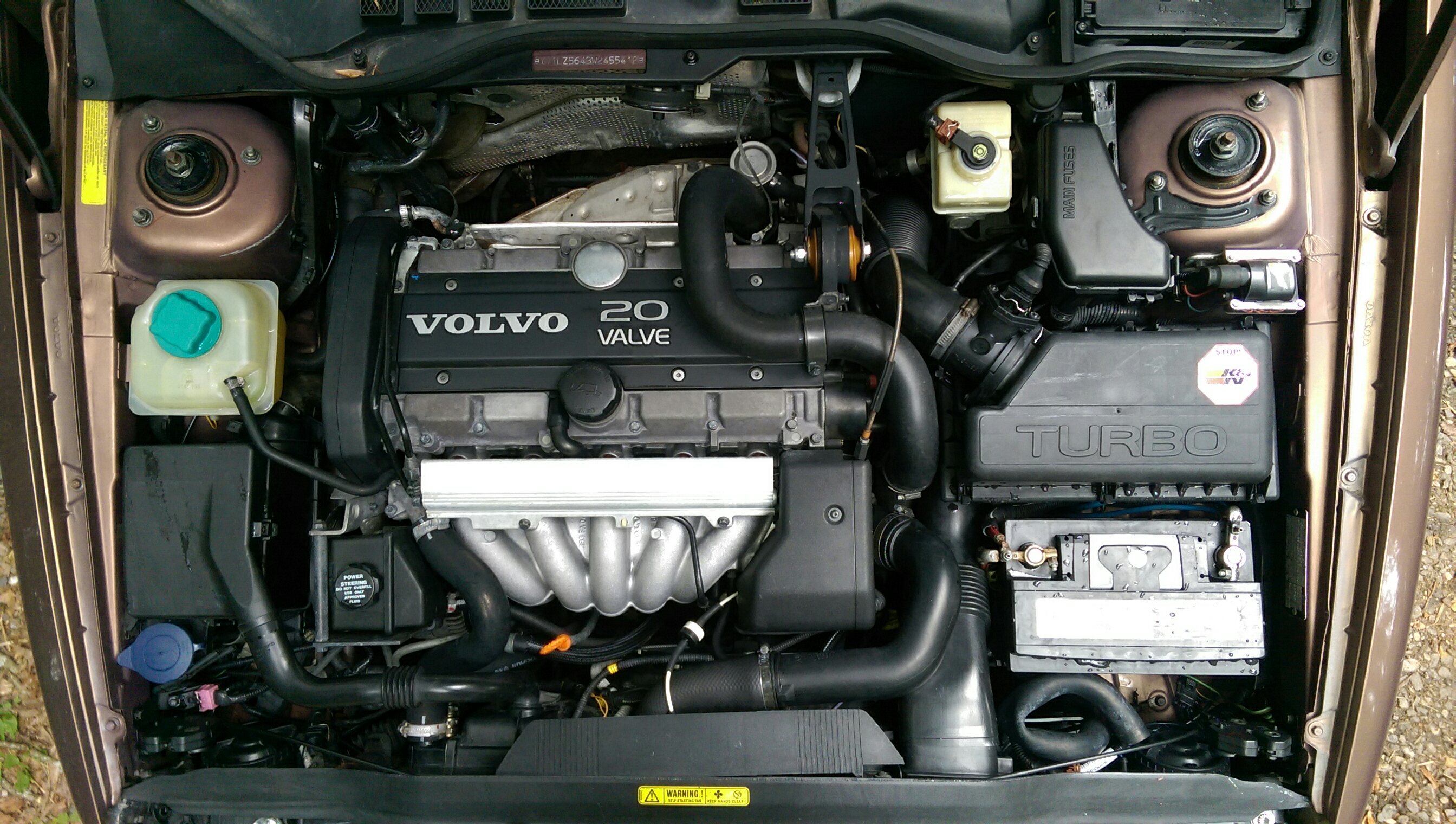

Today I am tearing into my beloved XC
I have just wrapped up my stage 0+ and have developed a tiny leak from the coolant system into the #2 cylinder. I discovered it after a rough morning start, then looking into the cylinder the next morning when it was cold and seeing a couple of table spoons of coolant. I am slightly disappointed that I have to take all I have done apart to fix something that was supposedly fixed two years ago. Hopefully in a few day it'll be back on the road providing me joy and function. Plus I'm going out west in 12 days (road trip).
I will be having the head machined to true.
I have done a few engine heads before, Any tips would be appreciated.
