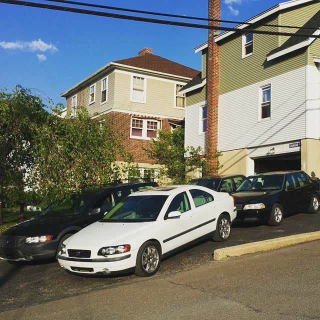

I meant to write in my initial post that bad shaking upon acceleration into traffic or going uphill. I have good power, she's kind of a beast, just poorly mistreated in the past. The driver's side control arm looks fairly new, with volvo stickers still on it and readable. I am going to try to just replace the bushings for now. Pulling wheels off the front today. I know everything with the car isn't so bad, it's just the time to take to fix it all. Instead of going on vacation this summer I'll be in the garage.
No cel, no codes on my basic obd2. Some days it drives alot better than others, but that could just be my intolerance to the imperfections. Might change the fuel filter today, that appears to be easy enough, ha. I'm just spoiled with Volvos, never had one that gave me this many problems, other than my last that was just sold and that was only a cylinder head replacement because the tb jumped.
All perfect except my imperfect xc, the s70 in the back that you can hardly see was the one the got away. Not adding any until the xc is either perfect or crushed.
