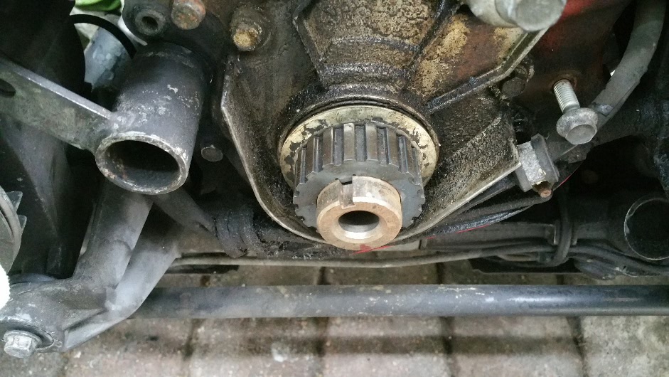

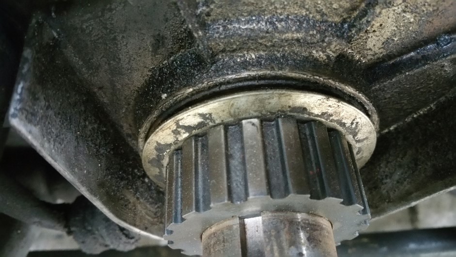

I know that this is an old thread, but I'm having the same struggle getting my crank gear off. It's on there pretty tight, and there is absolutely no room behind it to get a screwdriver, let alone a puller. How do I get this thing off without damaging something? Also, what is the metal ring directly behind the gear (pictured)? It looks like a dust cover but it's loose and rotates. Is this part of the crank seal?
And while I'm asking all of the questions, should I replace the seal while I'm in here? It's not leaking at all, but there is some residual oil in the area that you can see in the pictures. I'm assuming the answer will be "if it ain't broke don't fix it". But I thought I'd ask.
Thanks in advance for the assistance. -Bob

OK. I figured this out, so if anyone else is facing the same issue here is what I did. I found a good video showing how the process should work: My gear however was frozen in place. So I hit it with penetrating oil several times and ended up tapping the gear very gently with a small hammer to free it. Once it broke loose it slid off very easily.
