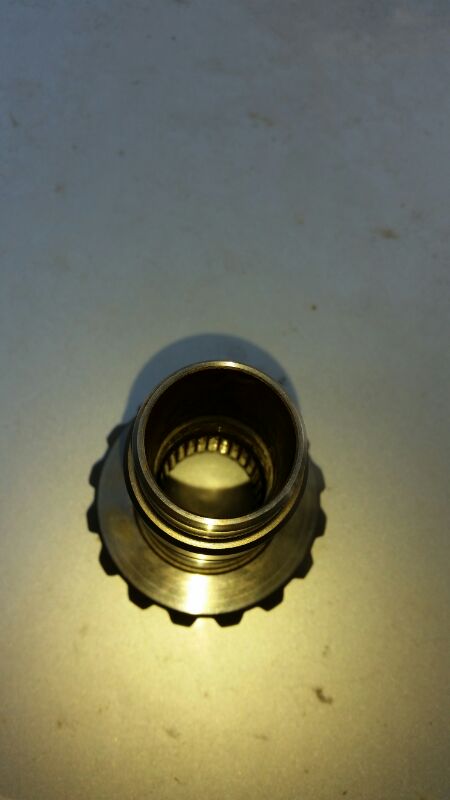

Hello Guys,
I got my differential broken which cause damage to the outlet of the gearbox gear(not sure how to describe it). The teeth inside vanished.
This part unfortunately is not sold separately but I am with only option to buy a new tranny or buy an old one and take out this gear. Both costy.
My question is, if out there someone have got broken auto transmission from which, he/she can give me that part I need. I am not exactly sure how it is called but I will attach pictures of it. Basically, I have been told, it is the the connection of the gearbox to the differential rod.
The tranny is AW50/51 AWD which is found in 2003/2004 model XC70(my make is Sep 2003 but model 2004) 5 gears 163 h.p diesel
If any one can help me out with info or directions I would appreciate it.
Thanks
orhanco

Alright, this part cant be made manually so I need to find an old tranny and take out the part I need,
Can anyone tell me on what Volvo and year they used the exact same transmission box?(etc, XC70 S80 so on) I want to widen my alternatives since XC70 2004-2005 D5 are really rare :(
My tranny is AW50/51 AWD 5 gears, my car is 2004 model XC70 D5 163 horse power (make Sep 2003 but model 2004) D5244T
thanks

Any AWD P2 car (S60, V70, XC70), at least prior to 2006 (not sure when European market first got 6-speed TF80SC). Some first generation S80 and XC90 with 2.5T engine have it as well.
I can't tell if this part is 55-51SN-specific. If not, you can source it from 55-50SN as well.
Install VIDA, you can look what variety of transmissions this year and this model has in your market (INT).
