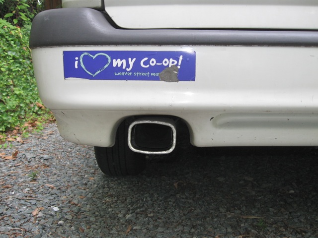

Agreed! I thought the new oval tip looked pretty good too. Here is a before-and-after with the original rectangular tip (which has been repaired a time or two over the years to fill in holes and repaint) and a new oval tip harvested from the junkyard:
Original tip:
Original '97 855 GLT exhaust tip
New oval tip from a '98:
Oval tip from a '98 sedan found in the junkyard
