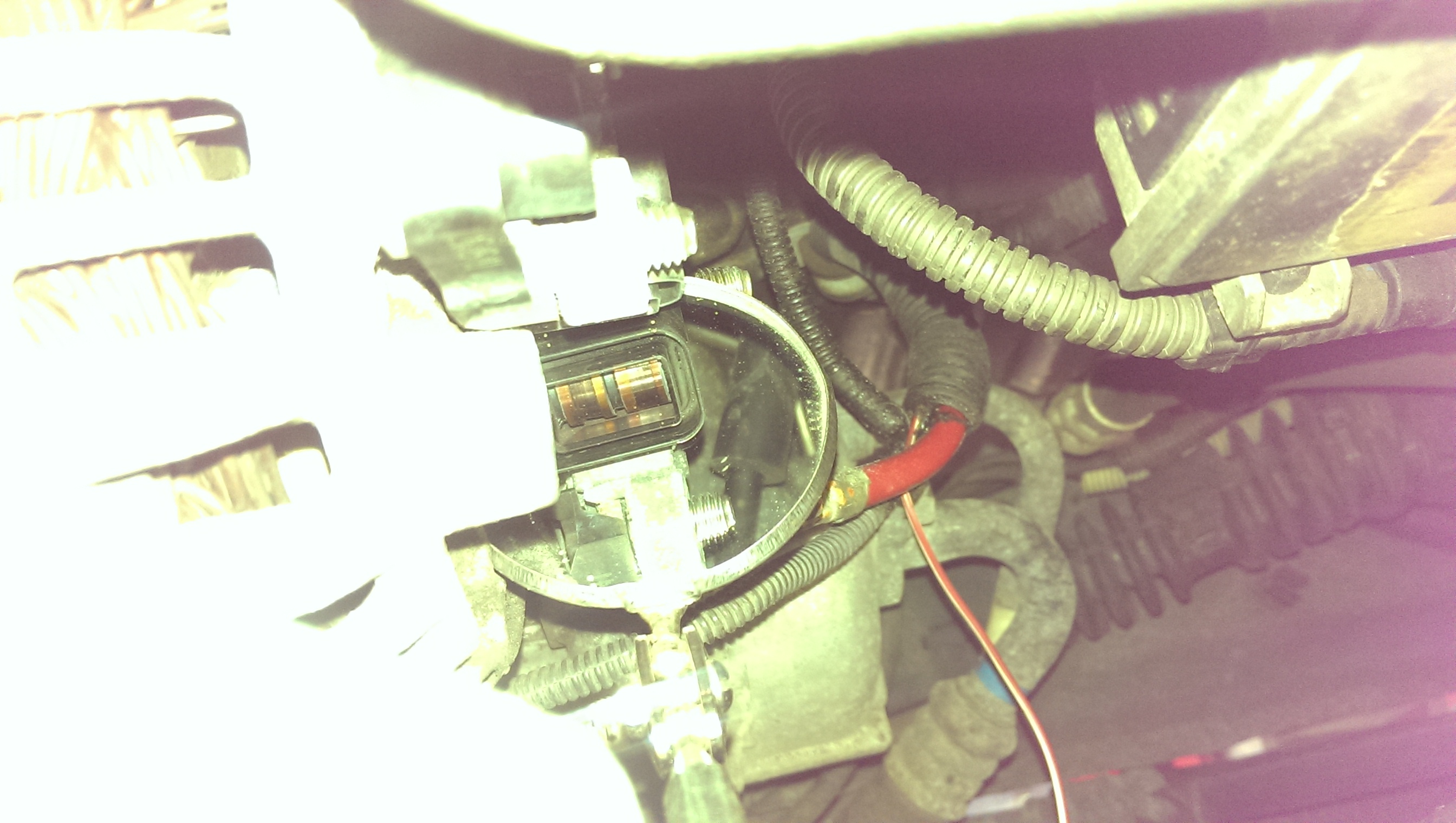

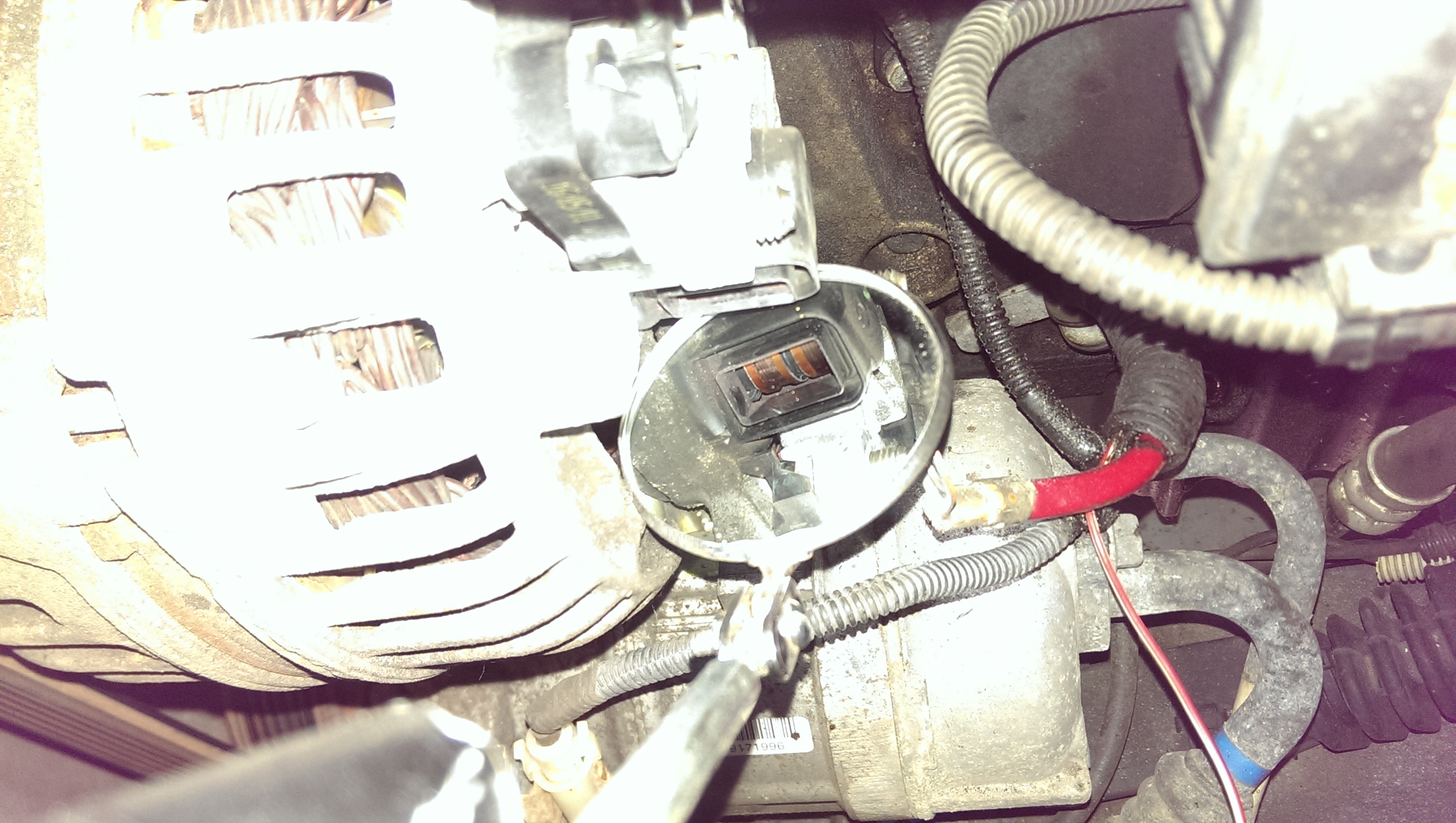

Decided to order a voltage regulator with the seemingly high rate of failure. With it removed, I noticed what appears to be wear where the one brush contacts the shaft. It may be hard to see from the pictures.
Does this warrant alternator replacement?
vtl
Posts: 4724
Joined: 16 August 2012
Year and Model: 2005 XC70
Location: Boston
Has thanked: 114 times
Been thanked: 603 times
Post by vtl »
Looks good. Brushes on old regulator were probably worn beyond limit. That's expected on 2001 car.
