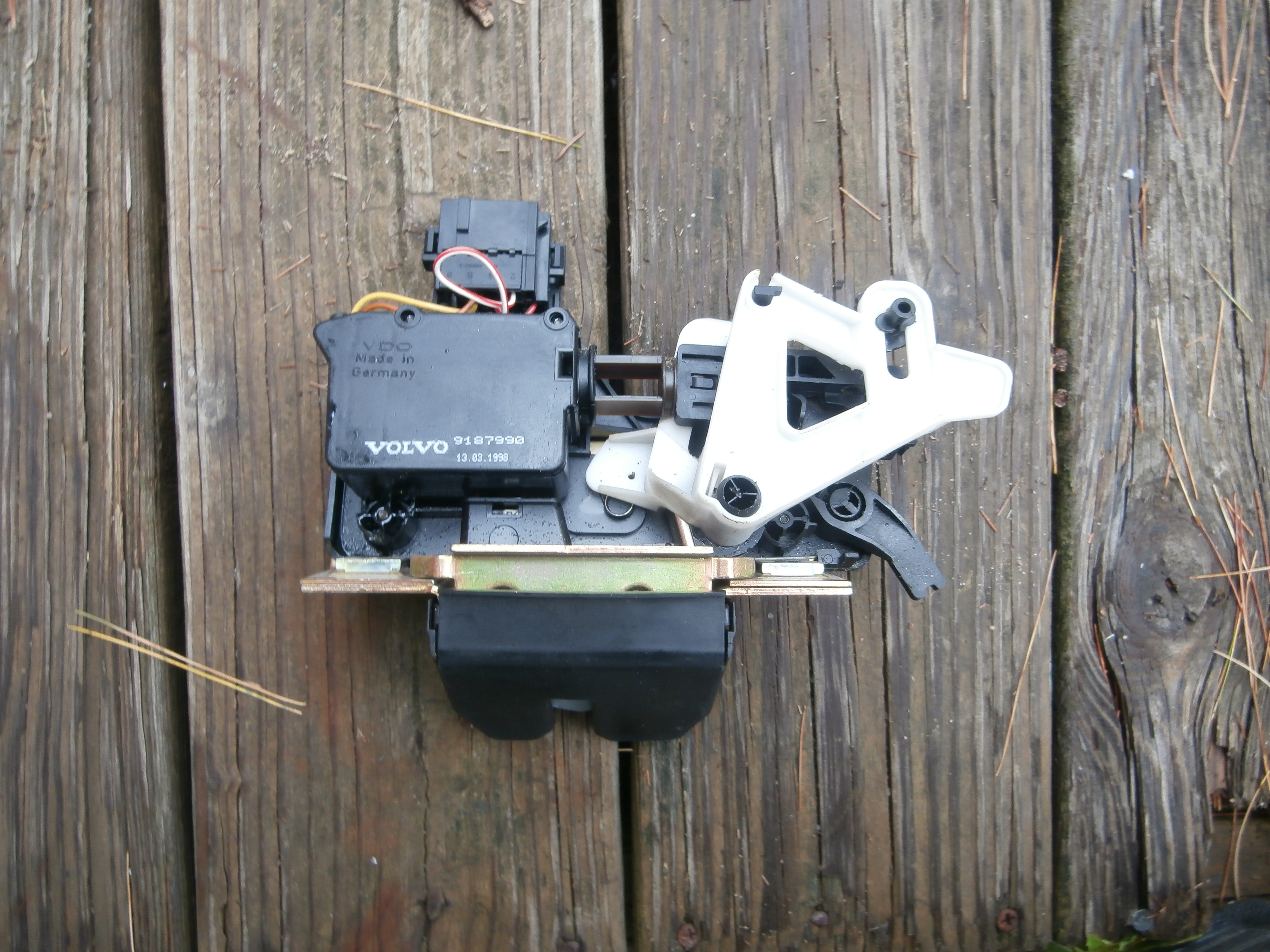

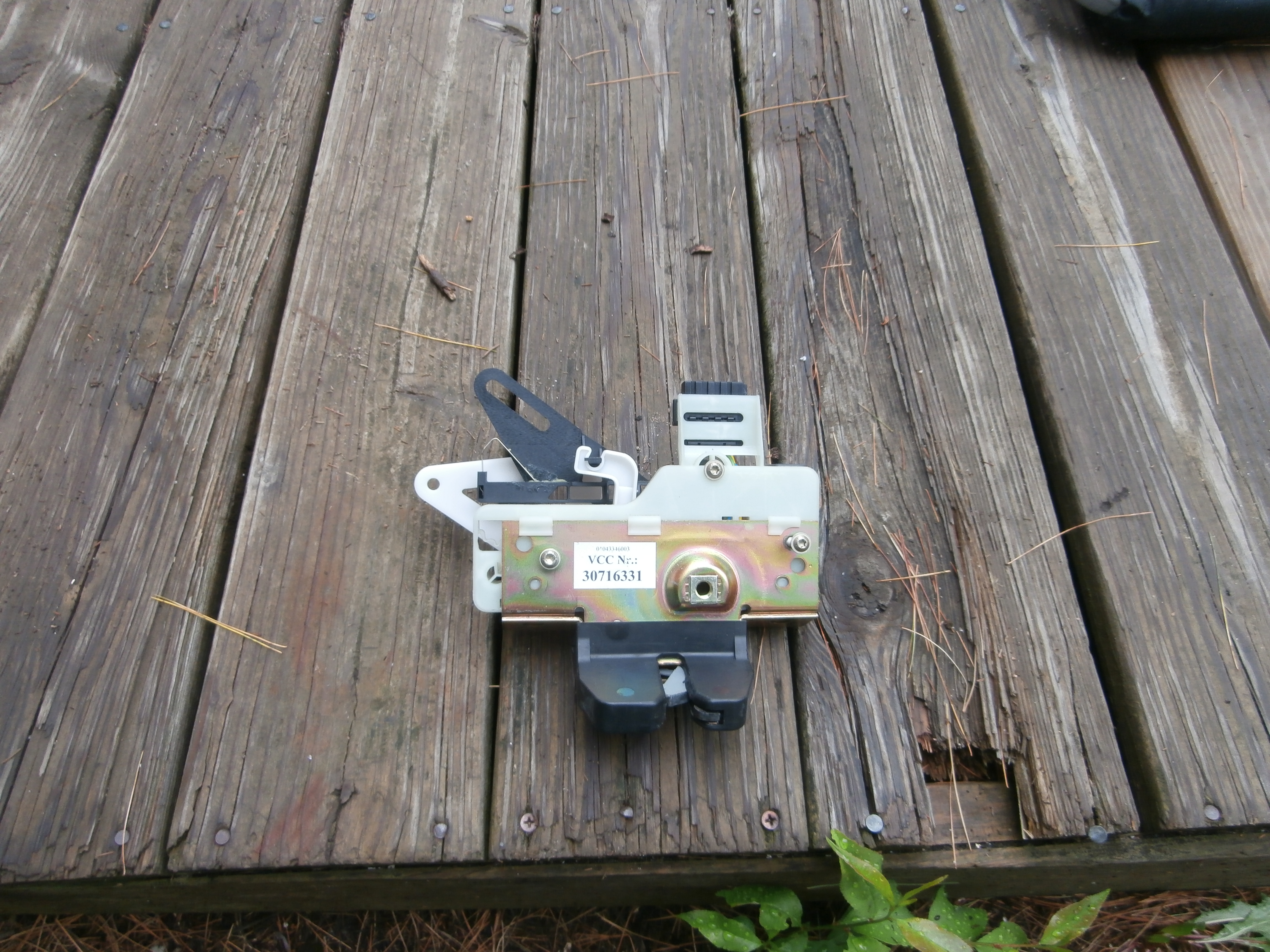

Like many others with the same issue, I have had problems with the latching of my tailgate, like having to close it multiple times to get it to latch finally having the latch stop working completely and ratchet strapping the thing closed, also including the dash light.
So I was looking for a replacement latch, didn't want to spend 150 to 200 on new so I found a newer version on ebay.
used latch from ebay
used latch
used latch

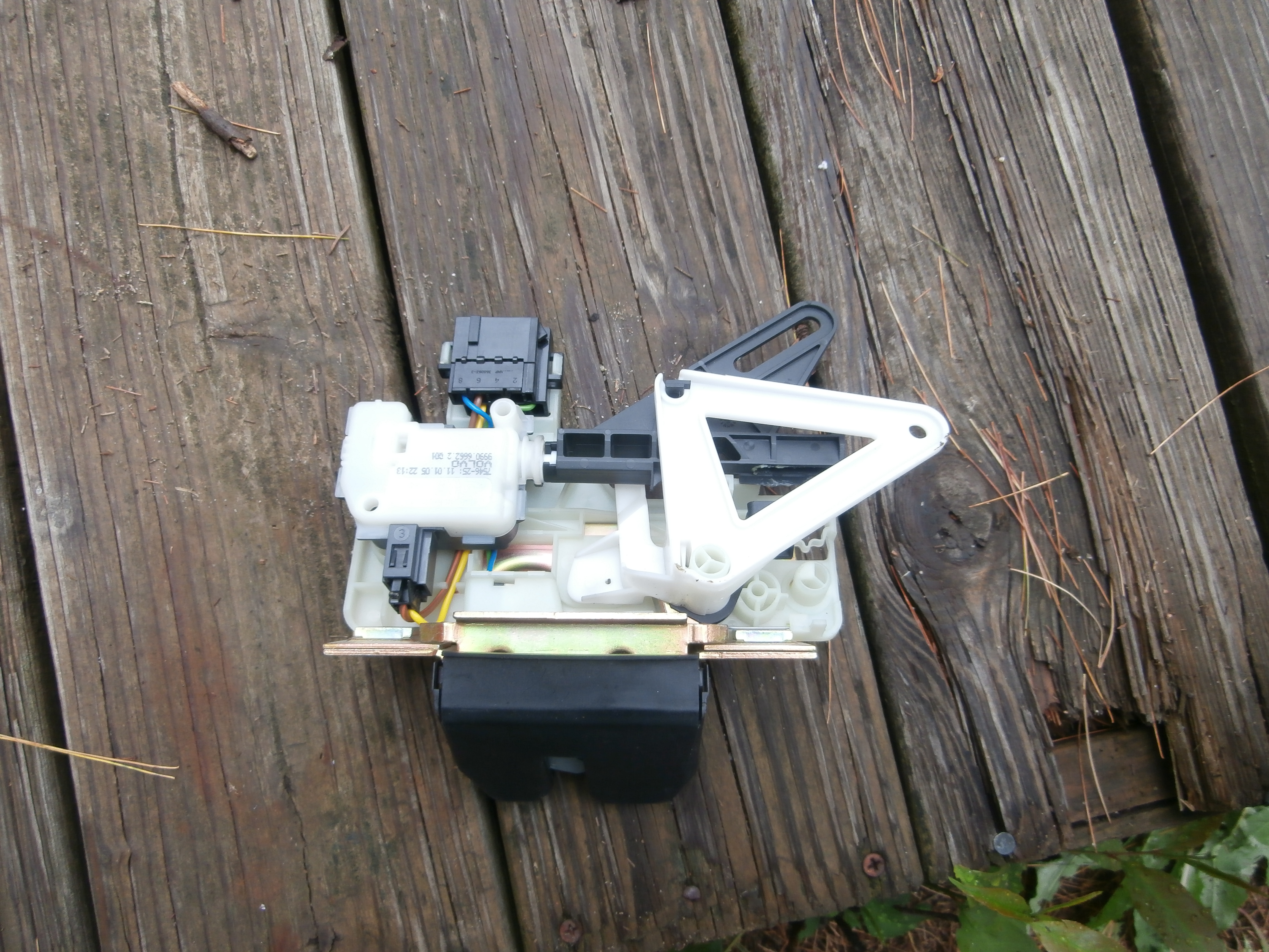

I switched my mechanism with the one in the new used assembly. I pulled the unit straight up after removing the 2 screws and slid right into the new assembly.
my assembly on the new latch
I found that the door latches on one shut and my dash light is no longer on.
