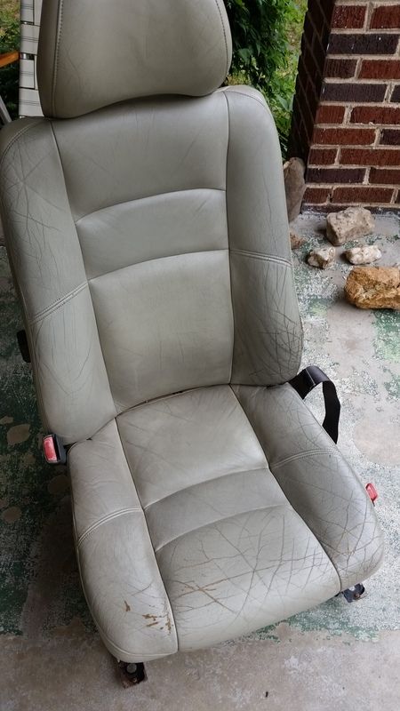

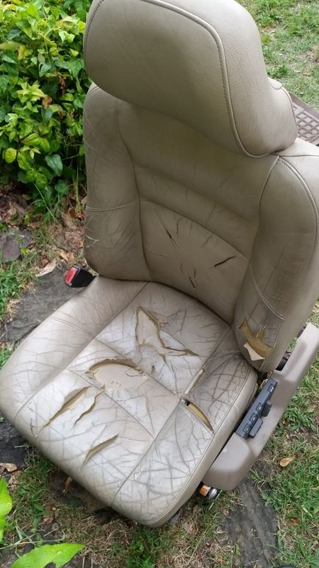

Thanks to a chance encounter with member rspi here in Little Rock, I heard there was a driver seat nearby...

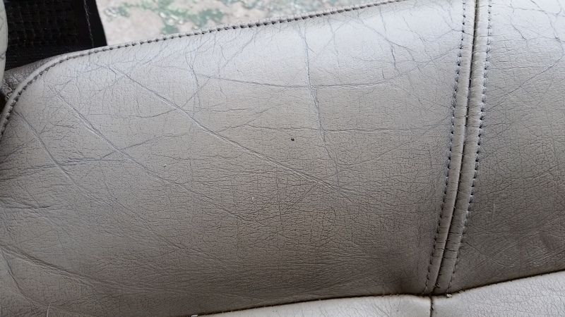

this picture was me trying to capture how dirty this seat was while cleaning it with some turtlewax brand leather cleaning stuff
I didn't realize until I had it home and cleaned up, that it is not the same shade of beige as my other seats. but it sure does look better, and not that noticeable while in the car

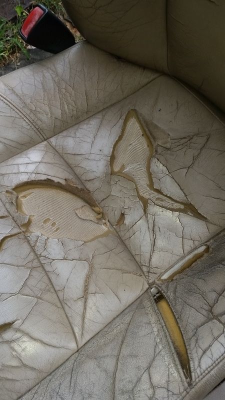

old seat

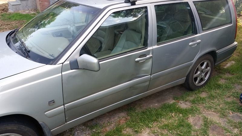

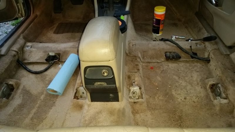

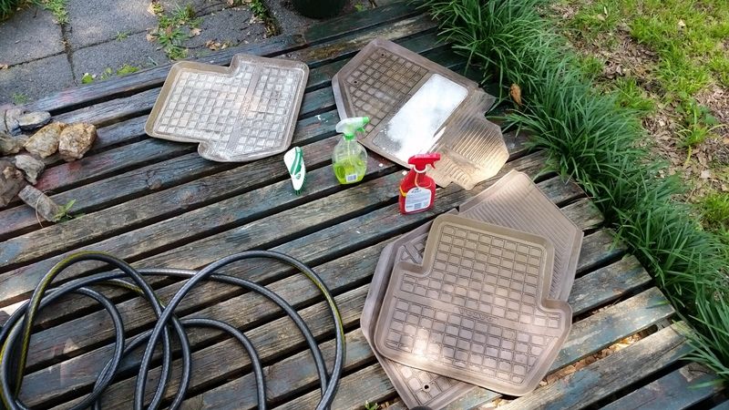

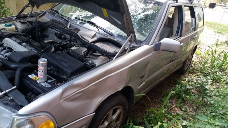

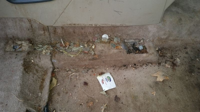

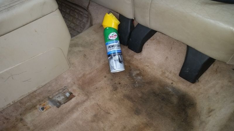

this will serve as the "before" photo of the carpet...it was starting to grow things. After about a year or more of having a driver door that doesn't seal, and in fact has a 1/2 inch gap because of a chance encounter with a huge 8-point buck. Door to be replaced this week :)
what can only be described as: "College Savings Account"

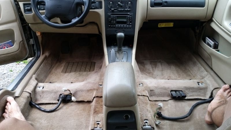

ahhh

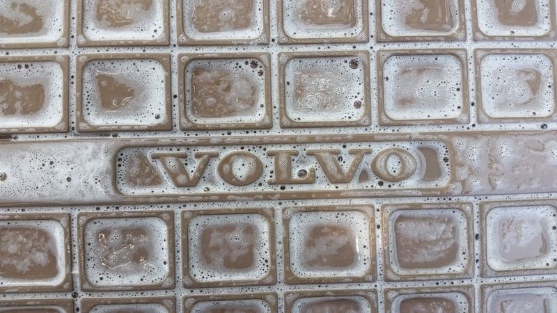

mats
it's good to stay highdrated on a hot humid day in AR
dat gap..is intolerable. working on that

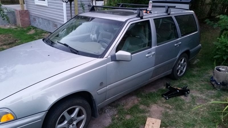

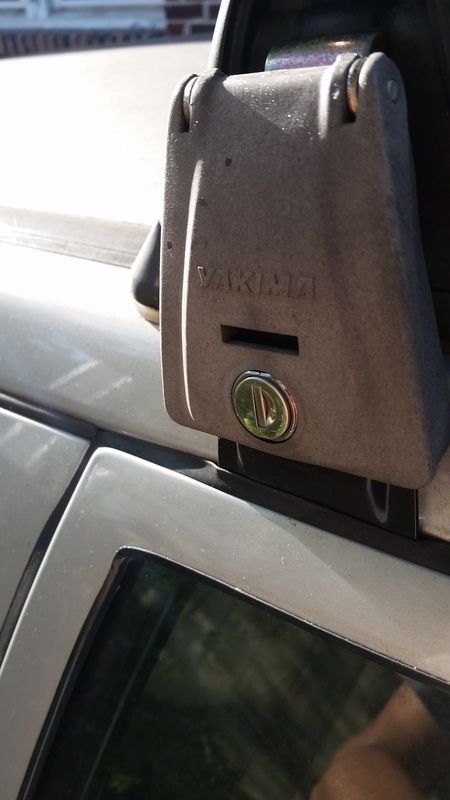

this is why i'm switching to rails plus cross bars soon..

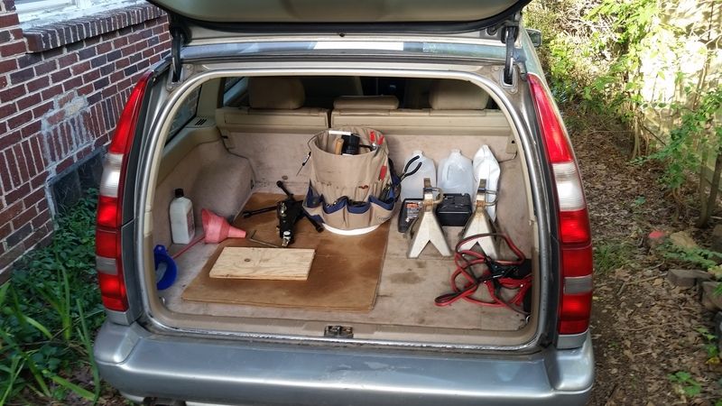

the nice thing about wagons is that they can serve as their own shop while being serviced

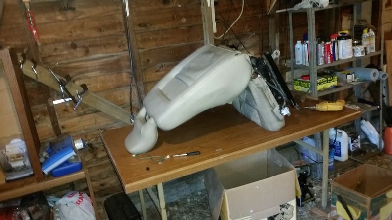

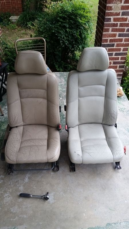

potential frankensteining of seat to follow? the "new" seat's back-tilt controls don't work and it makes a rather unpleaseant sound while moving front-back. I also managed to destroy one of the threaded bolt holes for the driver seat mount...

Previous pic doesn't show it so well, but...

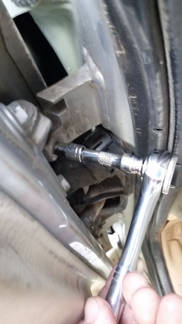

The junk yard car is a slightly lighter shade than mine... oh well. still should be way better than the old door. Still working on getting the alignment just right. Today I learned that removing car doors is far easier than installing....
Fun tip though if you want to remove a door by sliding the pins off the hinge, and you don't have an external torx bit of that size (like most people). A 1/4" bit driver fits very snugly on it, and the ones I dealt with weren't very tight and it came right off

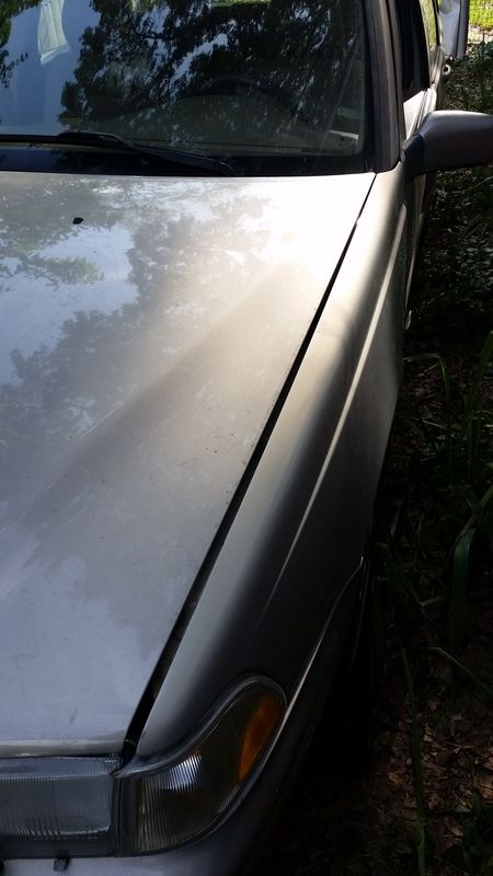

My hood and bumper had been replaced with a different tone also. It is the new style. :D

@obayha: nice! I have regretfully not been on the water as much as I should this year. And still haven't bought a kayak like I had planned to. Been sinking money straight into the kayak hauler (my car) for the past 6 months haha. I've hauled three kayaks on the current yakima cross bars a few times with no issues, I just like the look of the rails and it seems more secure to attach bars to rails. Plus they don't warp the door seal like you see in the picture above.
@bmdubya1198: Thanks! taking the seats out really isn't hard and boy does it feel good to know your carpet is perfectly clean in all those otherwise impossible to reach places :)

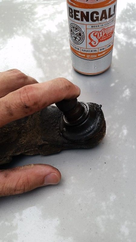

Didn't have much time to work on the car the past couple weeks. But finally got new Lemforder control arms and ipd swaybar links on. Not a terrible job if you know what you're doing, but this was my first and fumbled my way through it.
This is the only picture i got of the old driver's side ball joint...and this was the 'better' one :/
Didn't get any pics of either side completely done, but whatever. Torqued everything to Haynes for control arm hardware (37ft-lb for ball joint, 48 then 120 degrees for subframe) and IPD's instructions for their endlinks (45 ft-lb).

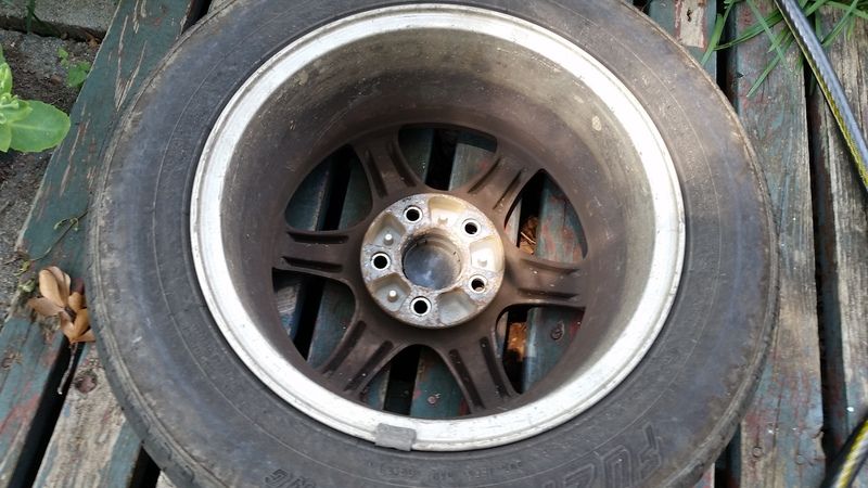

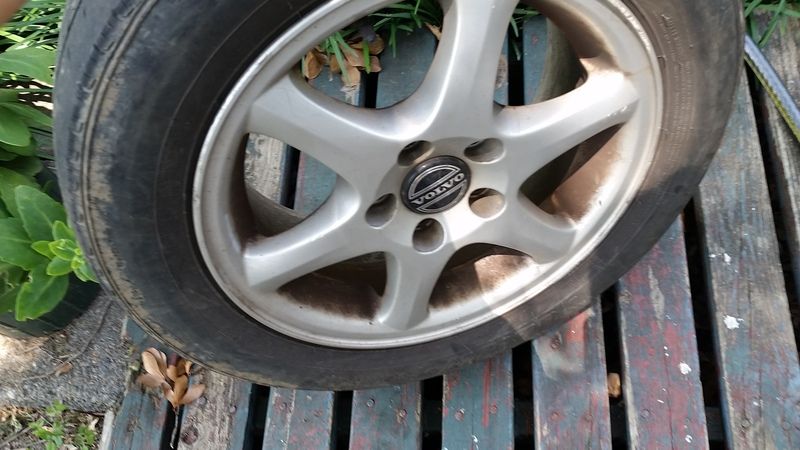

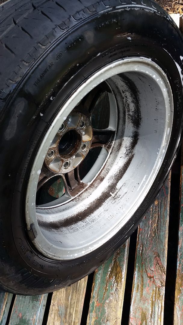

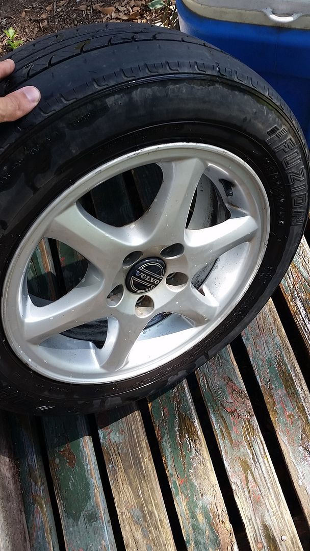

Cleaned another wheel. Ran out of elbow grease at the final state you see it in:
