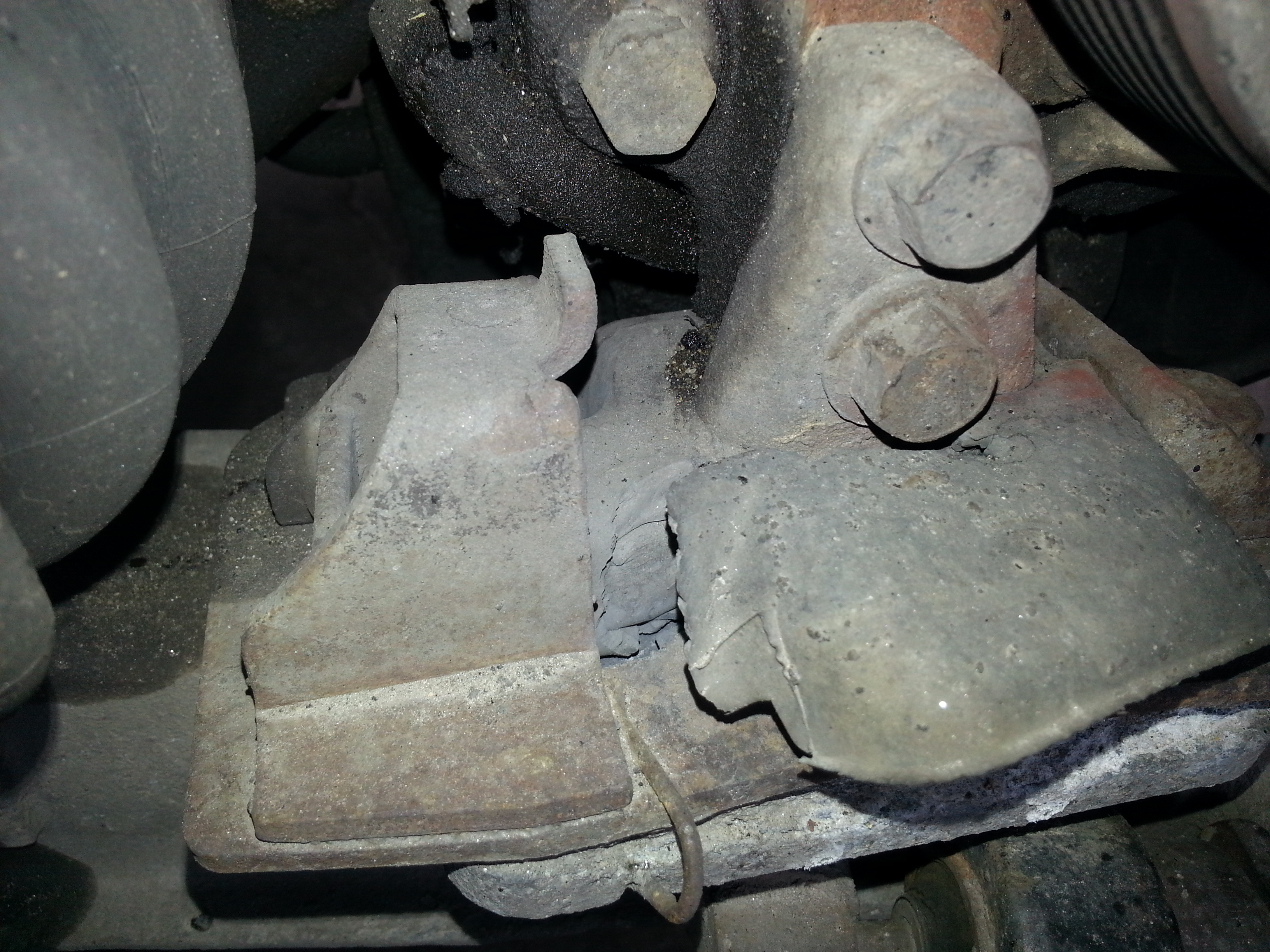

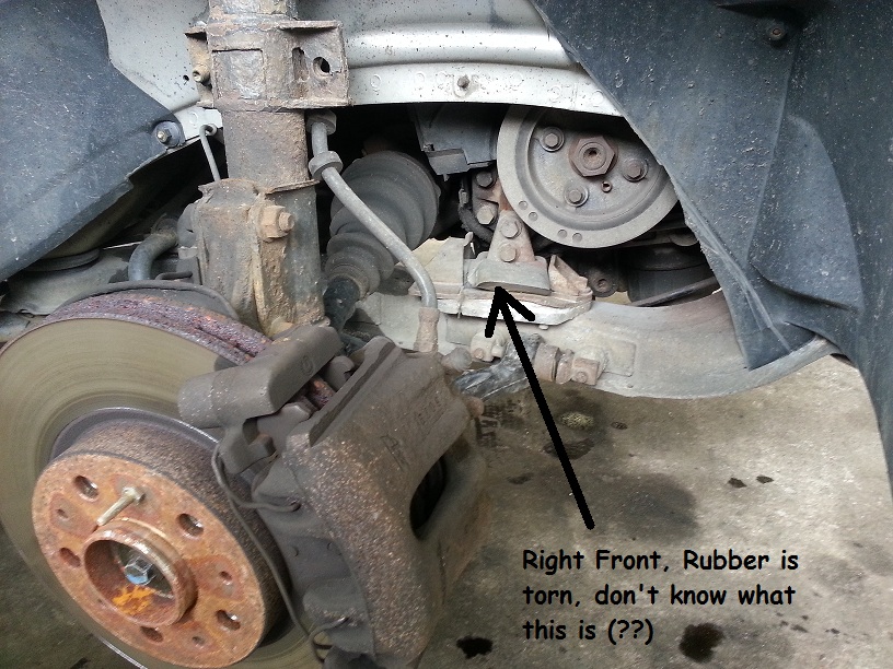

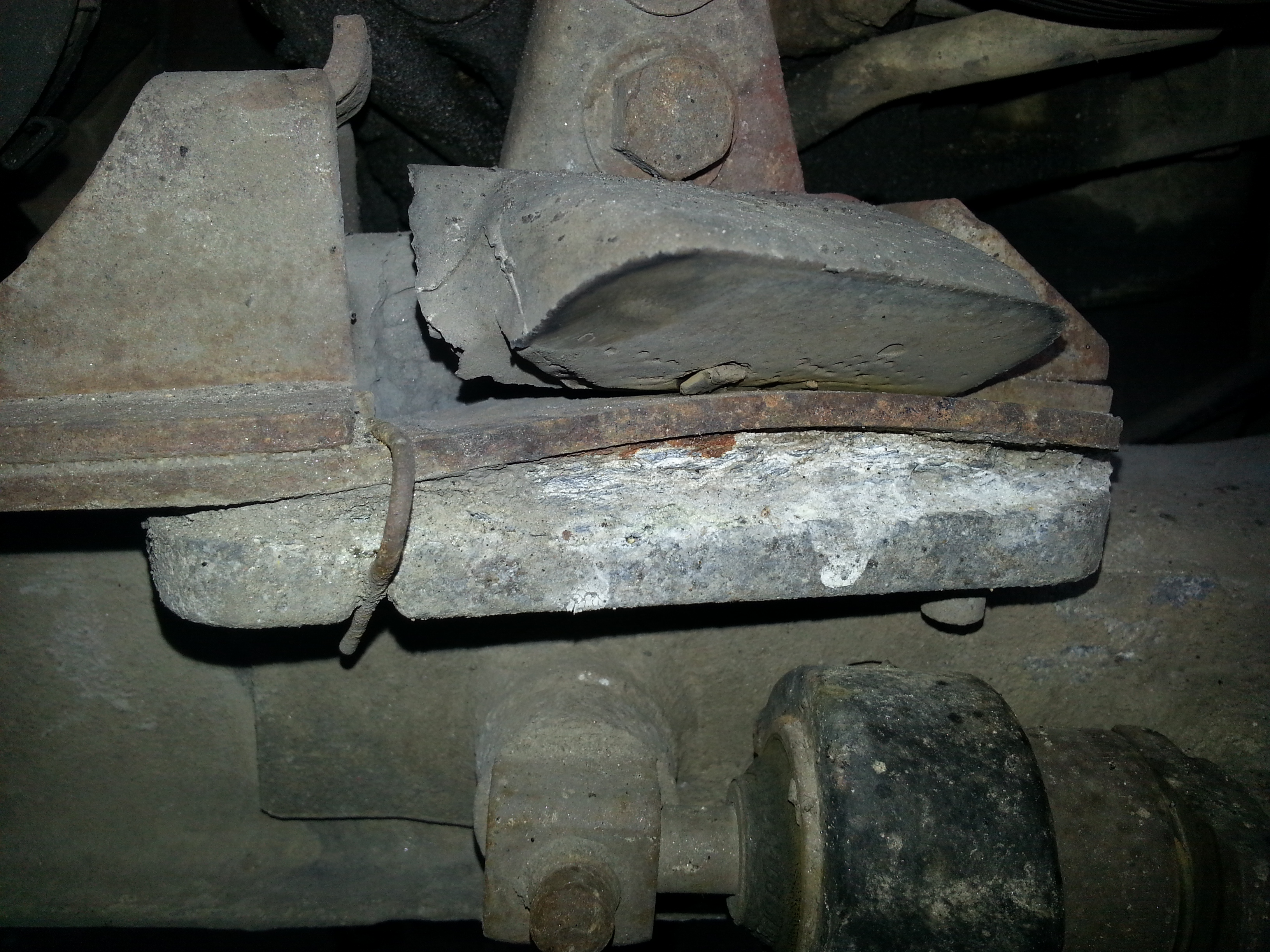

Recently, while the wheels were off (new tires!!) my 2000 V70XC, I noticed this ripped rubber component in the front right. Not sure if it's an engine mount or what, so I can't decide if I need to fix it, or look up parts & procedures. Any insight into what this is and if it's worth fixing?
- Inside the front right wheel

That is a broken engine mount (Volvo part number 9480190) You should replace it as it does contribute to driveline vibrations. To replace are the 2 bolts in the engine and 2 bolts in the mount to the subframe, I like to remove the engine bolts, then jack the engine up a little to get some more clearance to access the bolts in the subframe.

That's one of the 4 engine mount. I'd replace it asap, get only the Volvo OEM part.

They call it the front engine mount even though it is on the right side of the car. That mount is a pretty common failure.

I should have listened to all the other info on the forum, but I bought a low-cost (cheap!) Uro brand front engine mount because the price was SO good. When it arrived, the rubber was so brittle that it would crack (visibly and audibly) if you pressed your finger tip into it. If you pressed a fingernail into the rubber, you could see and hear it crack. There was visible cracking in the rubber when I took it out of the package. Absolute garbage - would have failed quickly in service.
I returned it and ordered a Volvo front motor mount from Tasca (a Volvo dealership that sells parts online, discounted). It was a beautiful part, solid tough rubber, and everything feels much smoother now. Much less engine vibration, and less pull to the right (and the ride seems quieter too).
I re-learned my lesson (once again), not to go broke saving money on cheap, critical parts.
