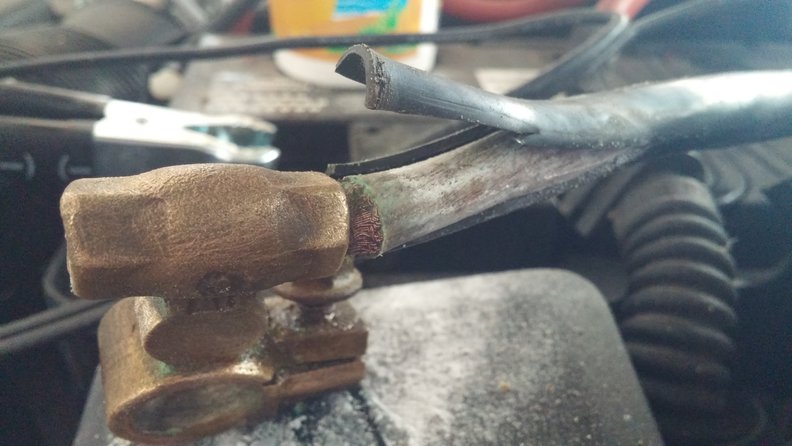

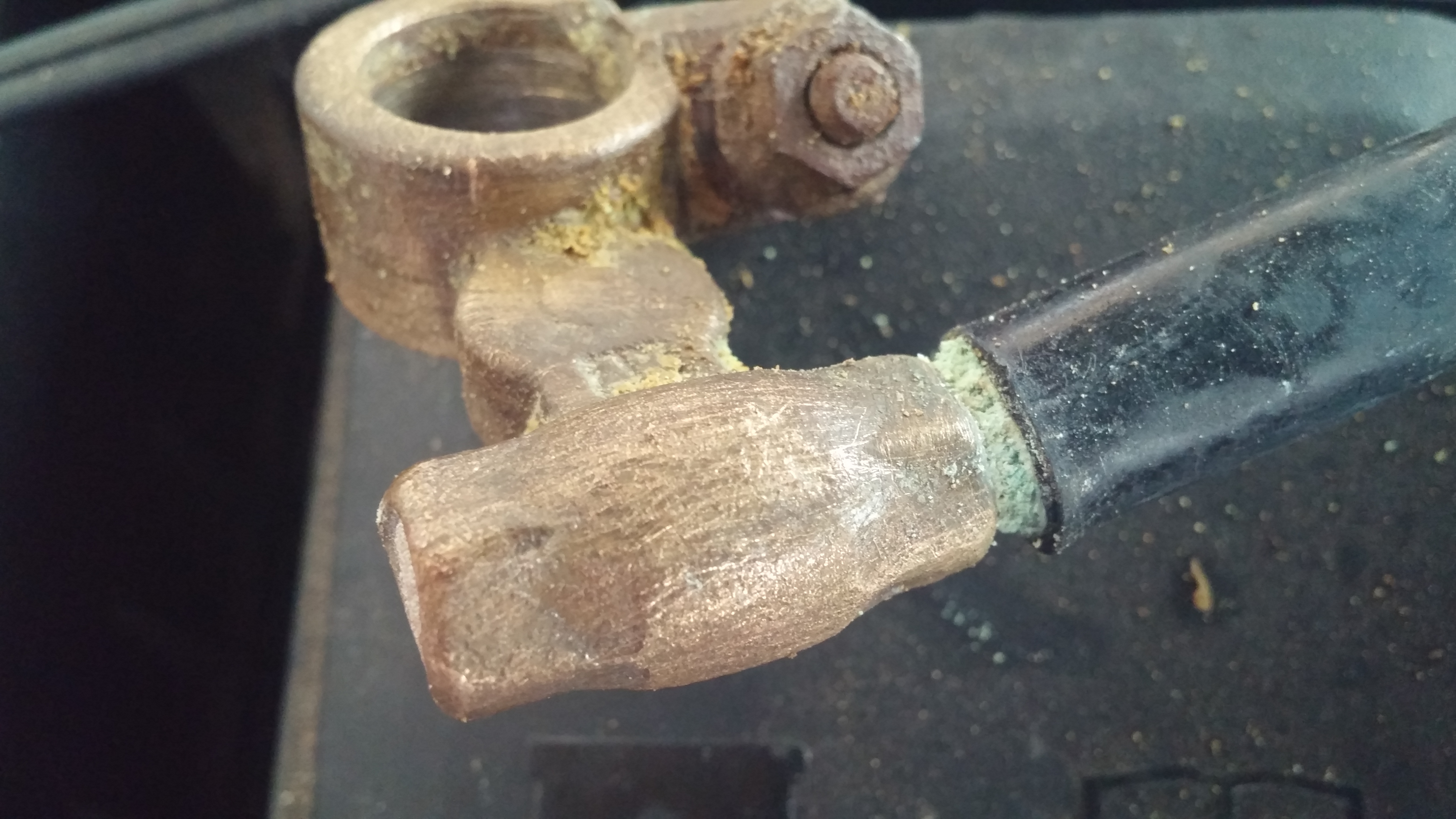

Well, this morning I was heading to work and the light came on about 10 minutes into my drive. At a stop light it was idling just fine, but when the light went green and I gave it gas to go... it just rolled forward with no additional throttle.... then all kinds of other warning lights came on regarding all the controls. I was able to get it towed home and tested the battery level. It was running about 7.8v. So, I gave it a jump from my son's car and drove it around the block with no warning lights. Pulled it into the garage and tested the battery (post to post) and was getting 12.3v with the car off, and 14.3 with the car at 2000rpm. Disconnected the battery and put it on my charger and noticed there's quite a bit of corrosion on the negative battery cable. I know these V8 Models have issues with the alternators, but do you think my problem could just be simply the negative cable not maintaining a good ground?

So, I went to the local autoparts store and bought a negative battery cable. Mounted it up, and slathered the ends in the terminal grease and took it for a drive. After about 5 minutes of driving...the alert returned. I drove home and while the alert was still on, I measured between the posts and it was 11.28 and dropping (car was running at idle with accessories on). I went and sat in the car and waited while it was running. Eventually after another 5 minutes the alert went off and I again measured between the posts and I was getting around 14.3v. Soooo, faulty voltage regulator? I hear that the voltage regulator on this model year is internal to the ECM, that true?

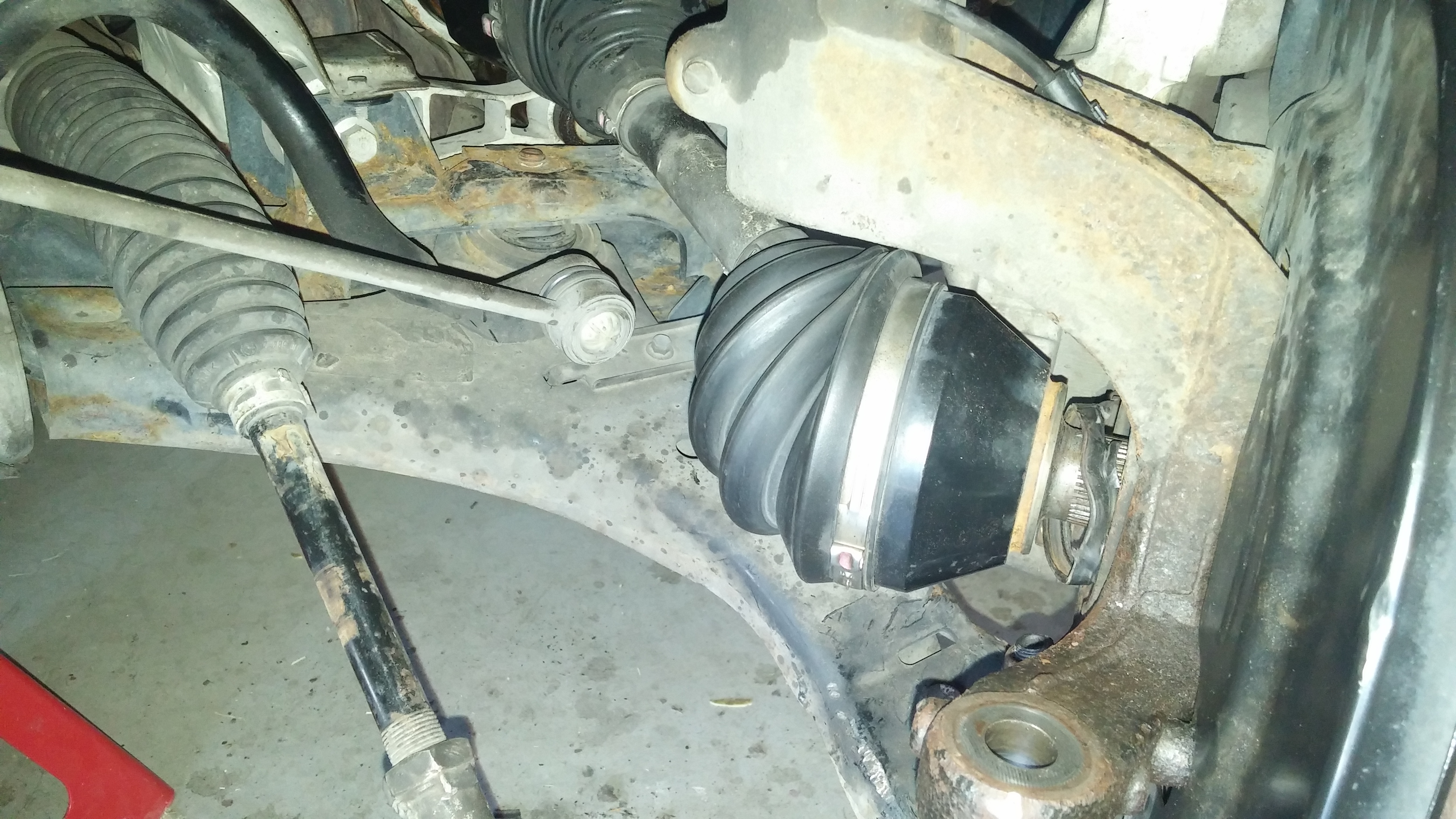

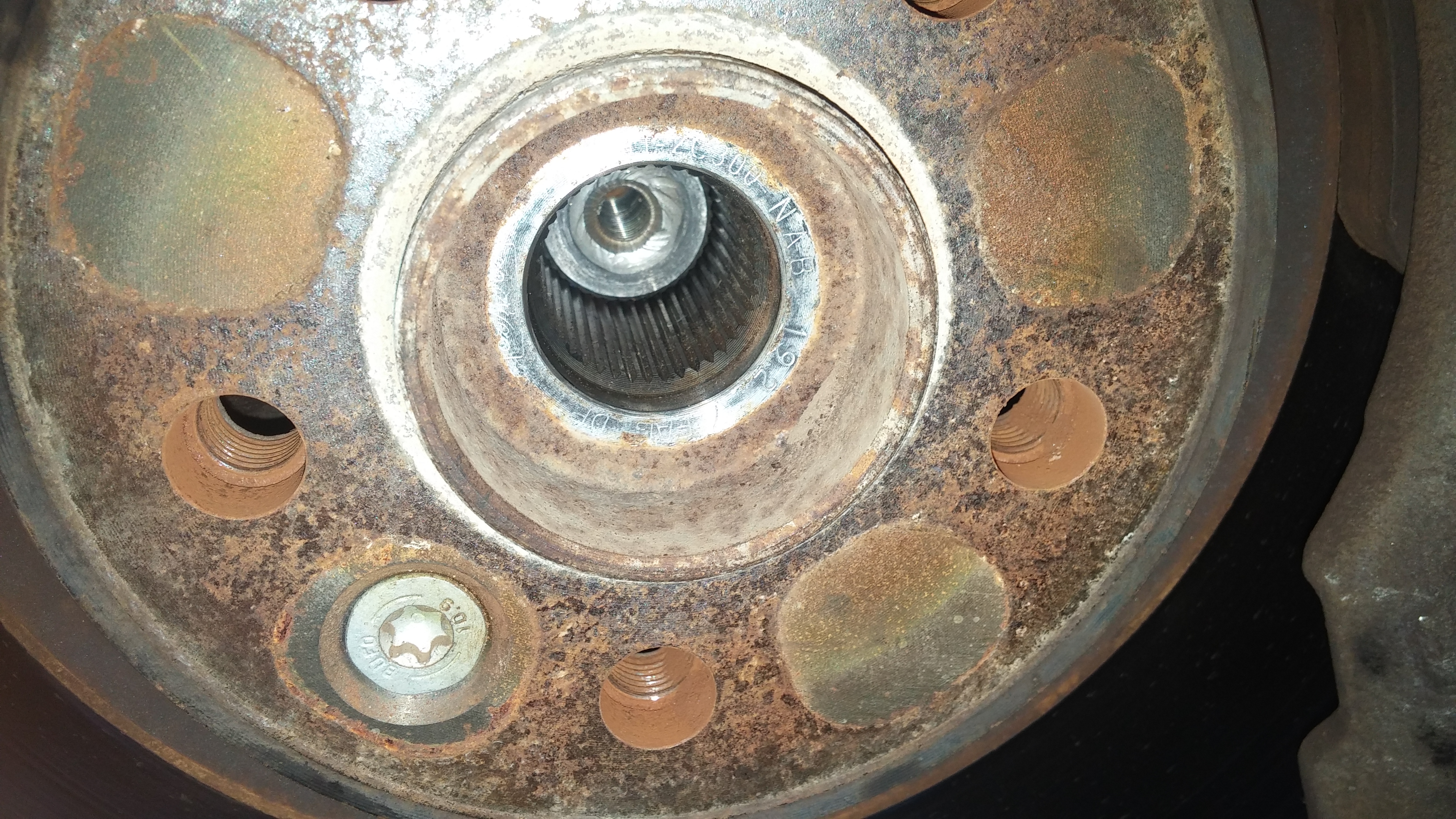

So, is there a magic trick to getting the passenger side axle out of the hub? I've disconnected the Outer Tie Rod, the Sway bar end link and have rotated the hub assembly hard left. I've unscrewed the axle retaining bolt and pushed it the axle back from the hub assembly as far as I can, but its still not quite far enough. I've tried jacking up the hub assembly and tried from several different angles and still can't quite get it. I don't want to undo the lower control arm connection to the wheel assembly if I don't have to, but I'm getting to that point I think.
I've seen other tutorials for the XC90 on this same issue, but I'm stuck... any advice?
