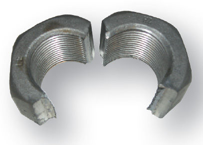

I have a nut splitter, have used on front suspension nuts before, it is a really great tool.

I just remembered that I actually own a nut splitter, although I have never used it before (and I already have a new nut since I bought new hardware before I started the job).

Make sure you split the whole width or else it is most dissatisfying.
