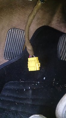

I noticed this wire just hanging there but couldn't find the plug for it.

If you can post back the wire colors that go to that connector we can probably figure out where it should plug in.

The connector looks like the behind the dash "auxiliary connector" in which case it may well plug into nothing -- i.e., it may be unused unless you have a bunch of accessories craving a power source.

The yellow connector does indeed appear
to be the accessory connector. Volvo provided
it as a power point for aftermarket accessories.
Most owners don't even realize that it exists, so
it's nearly always left unused.
