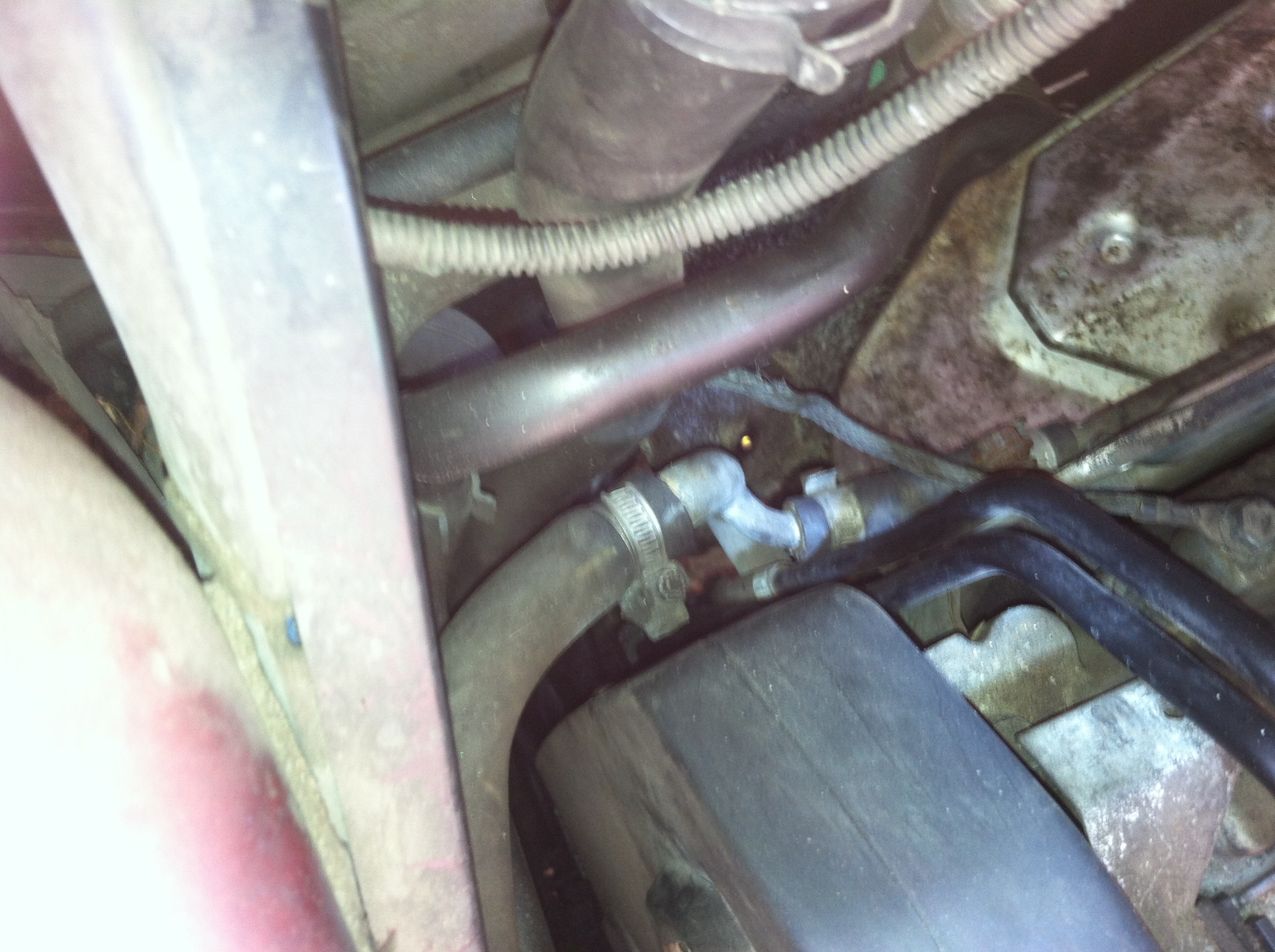

I'll agree on "once a turbo". My new to me is not a turbo, but need out weighted want. It was hard to push a 300,000 mile car into turbo without worry. My car is now living on in others, and I have a few more to remove.
Went to pull a part tonight and found a groundhog in the engine compartment. Did the right thing and gave him a few carrots and wished him well.
Shane
Not sure what he is working on, but I am sure I can rent him out if you need him to pull parts. The one is shinning at me. I think he is after my turbo.
Shane

Can you ask the groundhog which way the oil trap boss mounts?obayha wrote:I'll agree on "once a turbo". My new to me is not a turbo, but need out weighted want. It was hard to push a 300,000 mile car into turbo without worry. My car is now living on in others, and I have a few more to remove.
Shane
