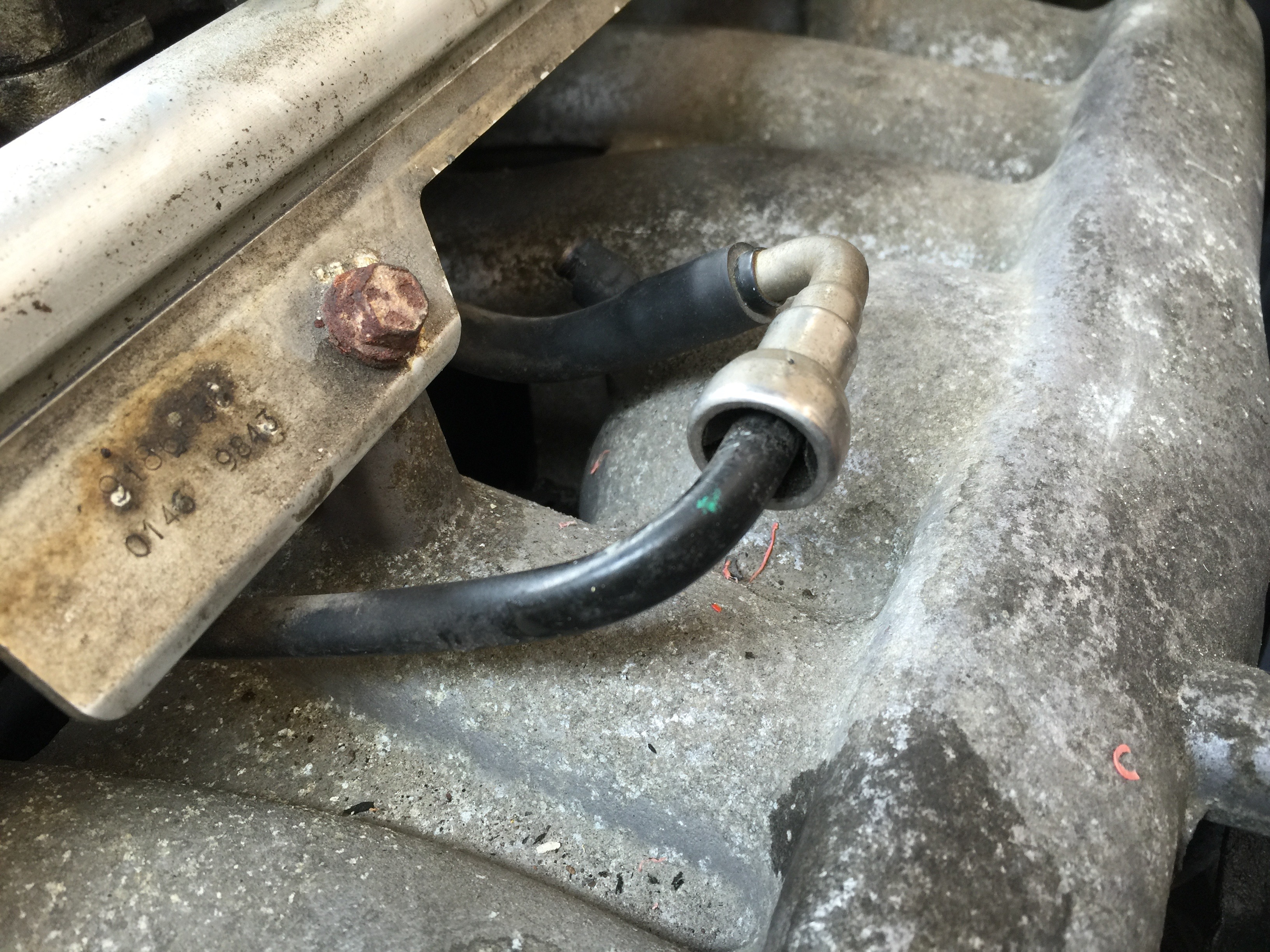

I realized the fuel line connect is released just like my AC lines.
This line has four springs that need to be pushed off a boss on the car side of the fuel line to release it.

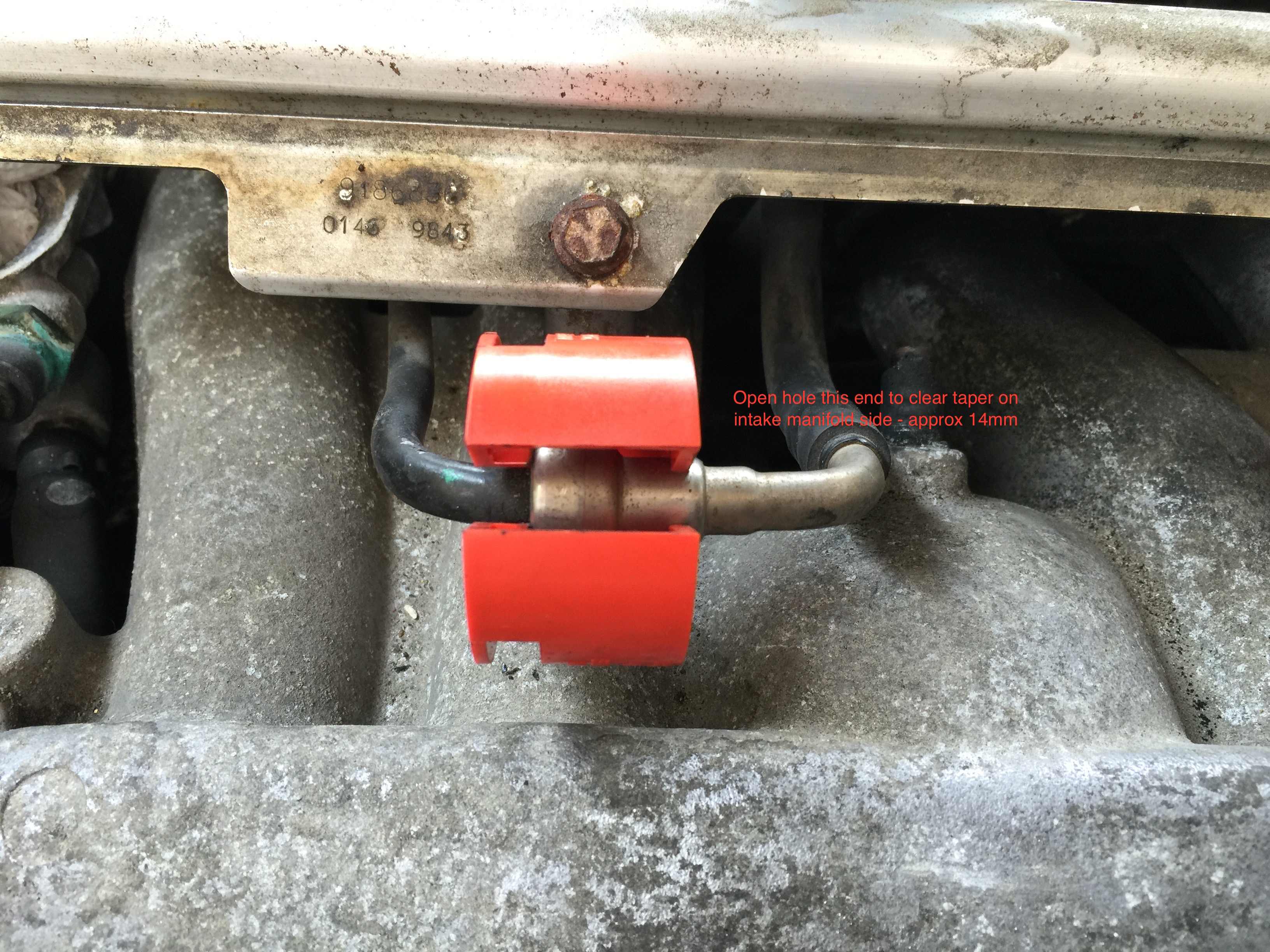

My 5/16 AC tool fit neatly into the release end but the other end on the intake manifold was too thick so the tool wouldn't close.
Solution - I drilled out the AC tool to 9/16 and Voila - it popped off the line perfectly
1999 V70T5M56 fuel line release tool , AC tool hack
