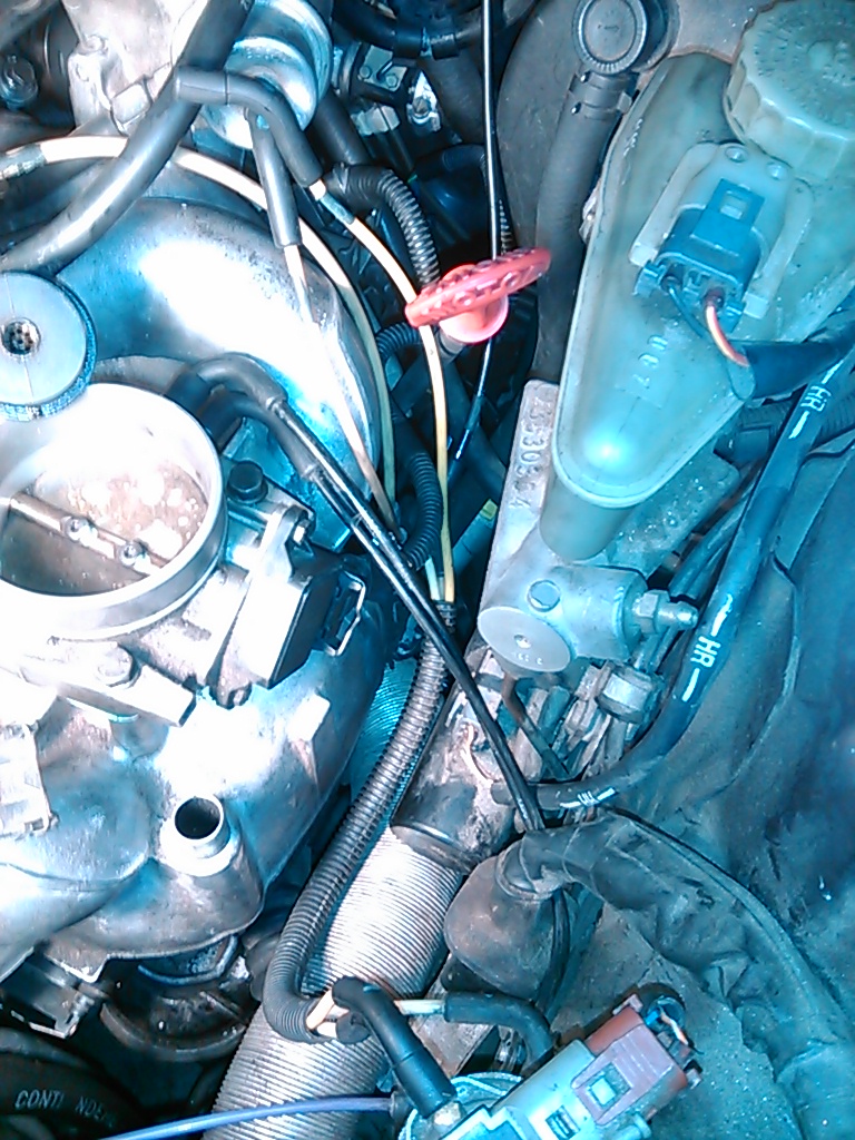

weres this vaccum line go?

This line comes off the egr solenoid, one goes to manifold tree one goes to flame trap and one goes to fpr I still have a unconnected one, any ideas?

What about the brake booster?

The EGR controller is at bottom of pic. The controller has a supply hose to the manifold "tree" and the other line would go to the EGR valve down below #5 intake runner on manifold.
The secondary air shut-off valve vac solenoid is close to the EGR controller and it has a vac source hose going to tree and the violet hose runs across the engine to the check valve/shut-off valve.
I can't see the ends at the tree but the FPR should be directly connected to tree.
The hose from the flame trap/crankcase vent is also directly connected to fitting around the tree or on the tree.
