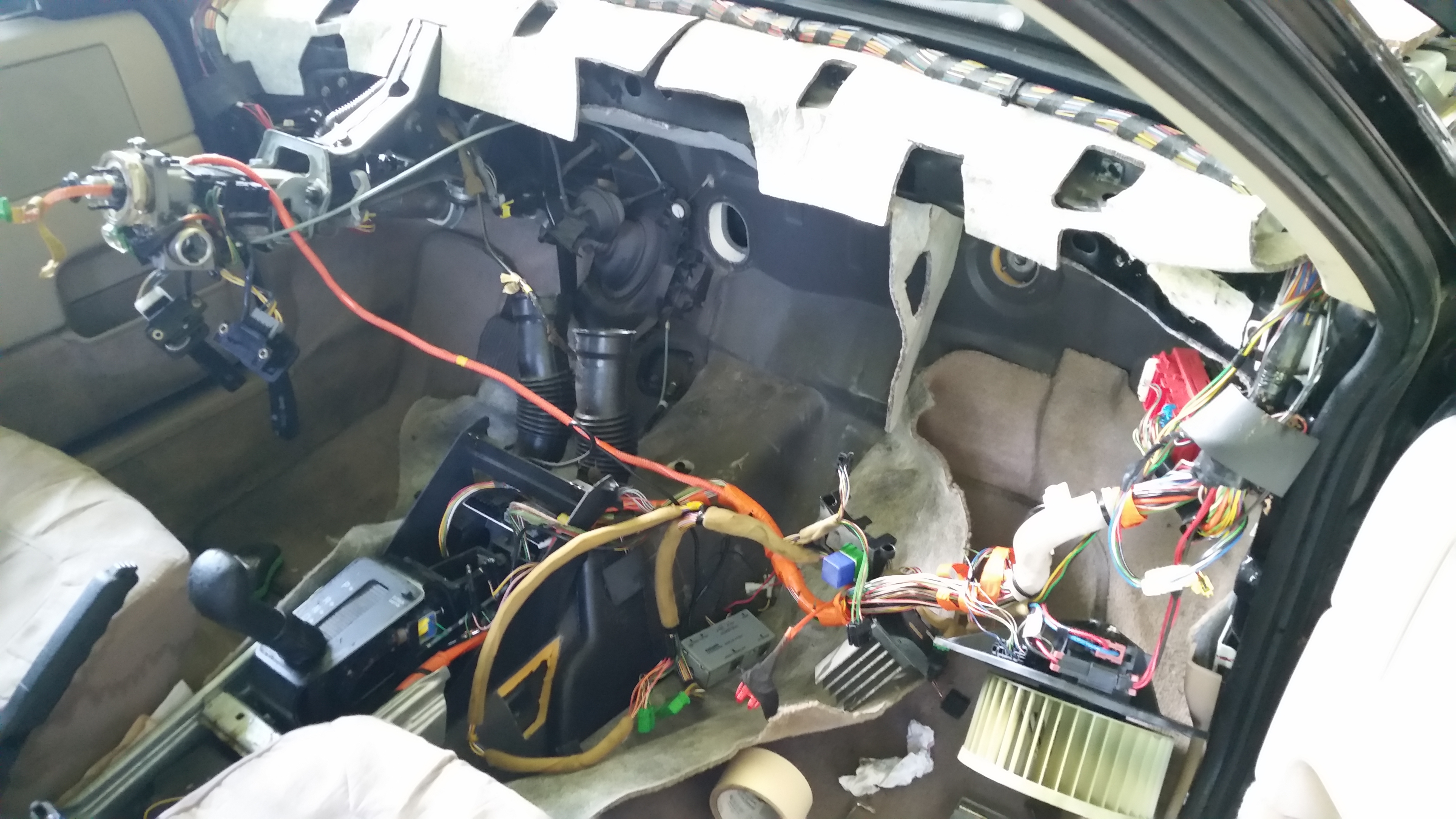

We I'm into the evaporator coil, its like a wars zone inside my car. Evertime I think I'm going to start putting it back together I fined something else broke

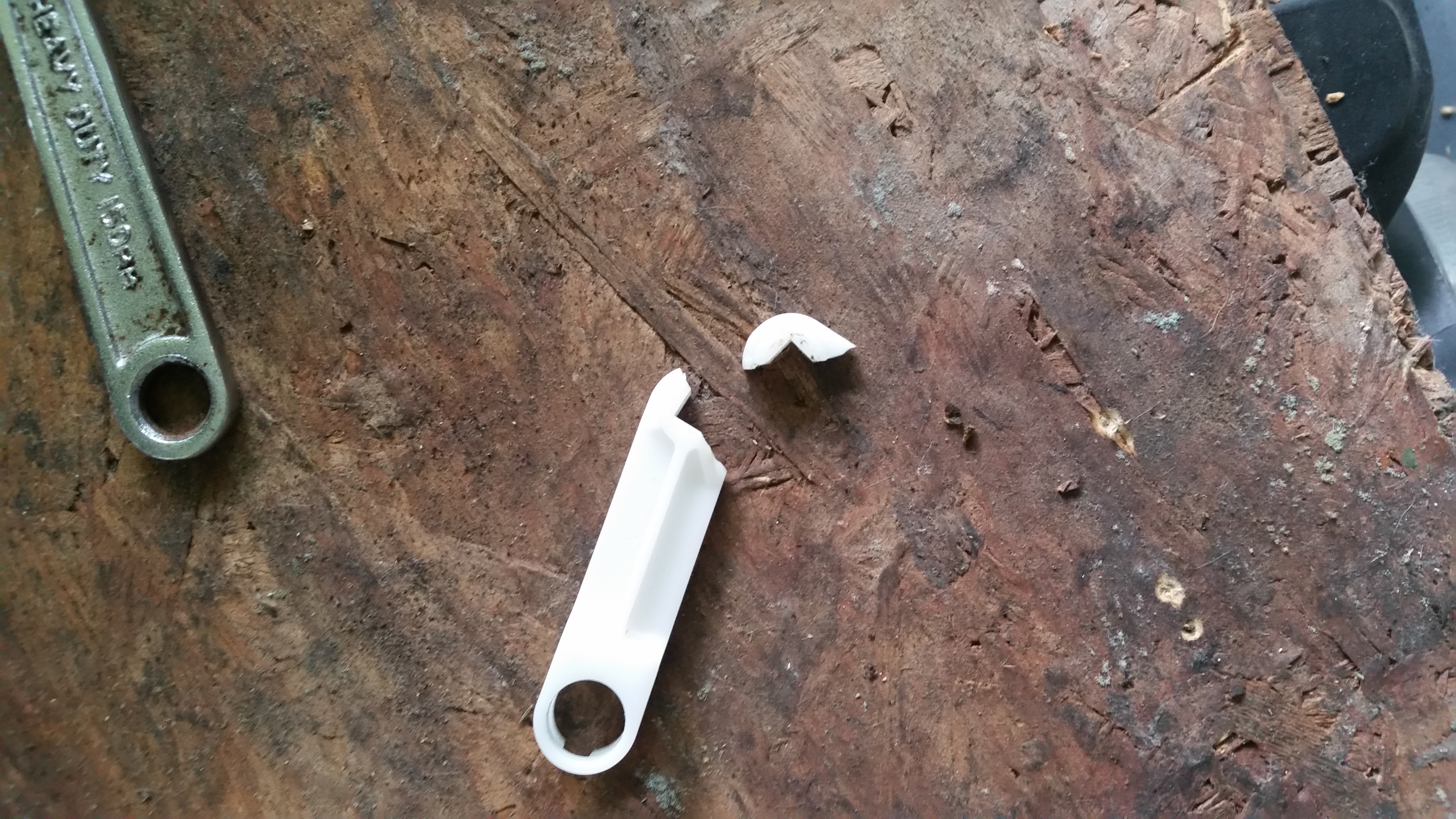

This little plastic arm thing is over by the fan and runs a damper between the fan and evaporator coil. What is it called so I can get a new one?
- Posts: 36148
You can glue that back together with some JB weld nicely.
The fixit engineer in me suggest a thin wire bent into a U around the square hole end, wrap the two legs of the U up high with several turns of thin wire, then bond wire and plastic with JB-Weld
Damper motor connector is what Alldata calls it ..I suspect it's the one for the blend door

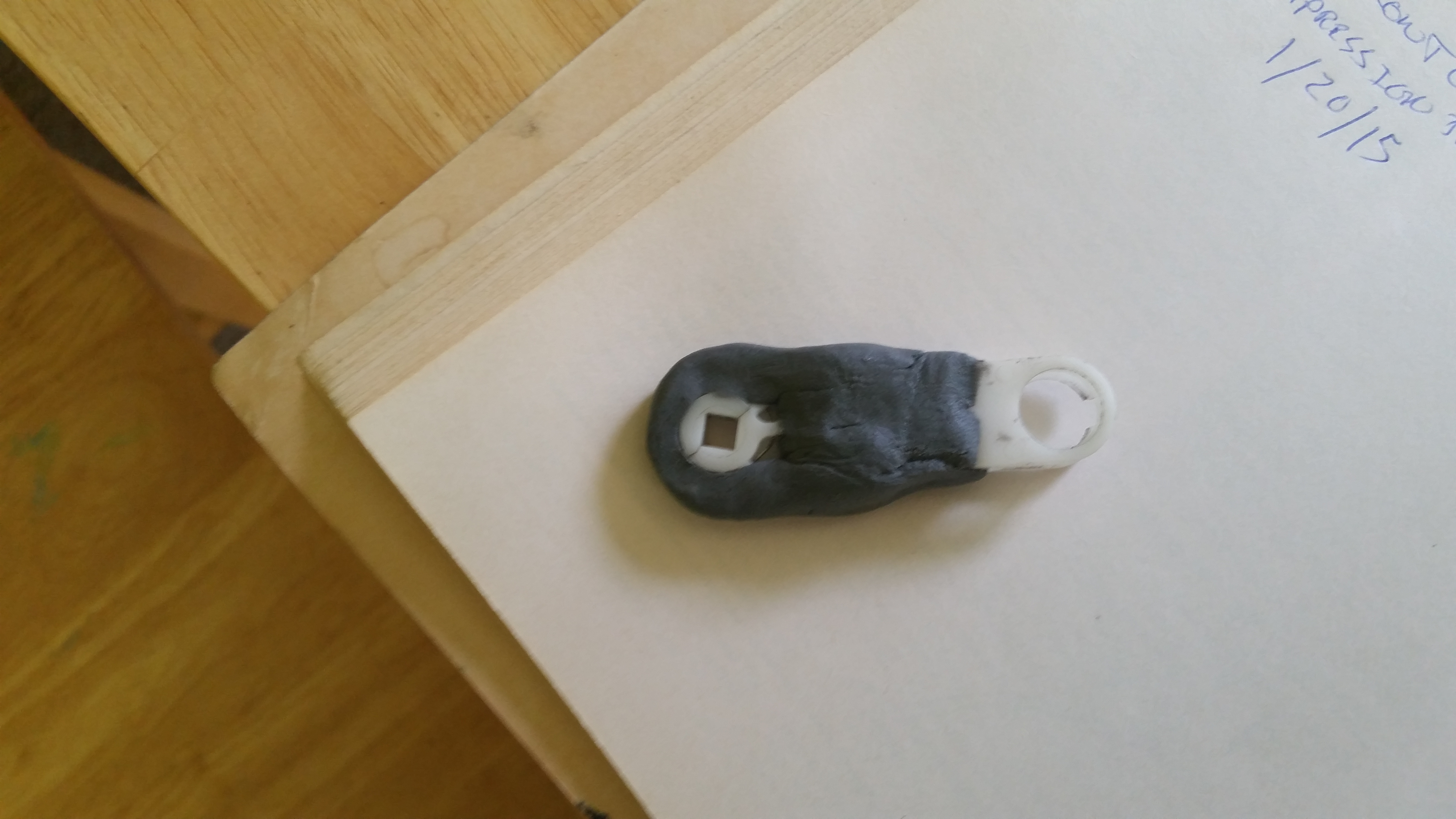

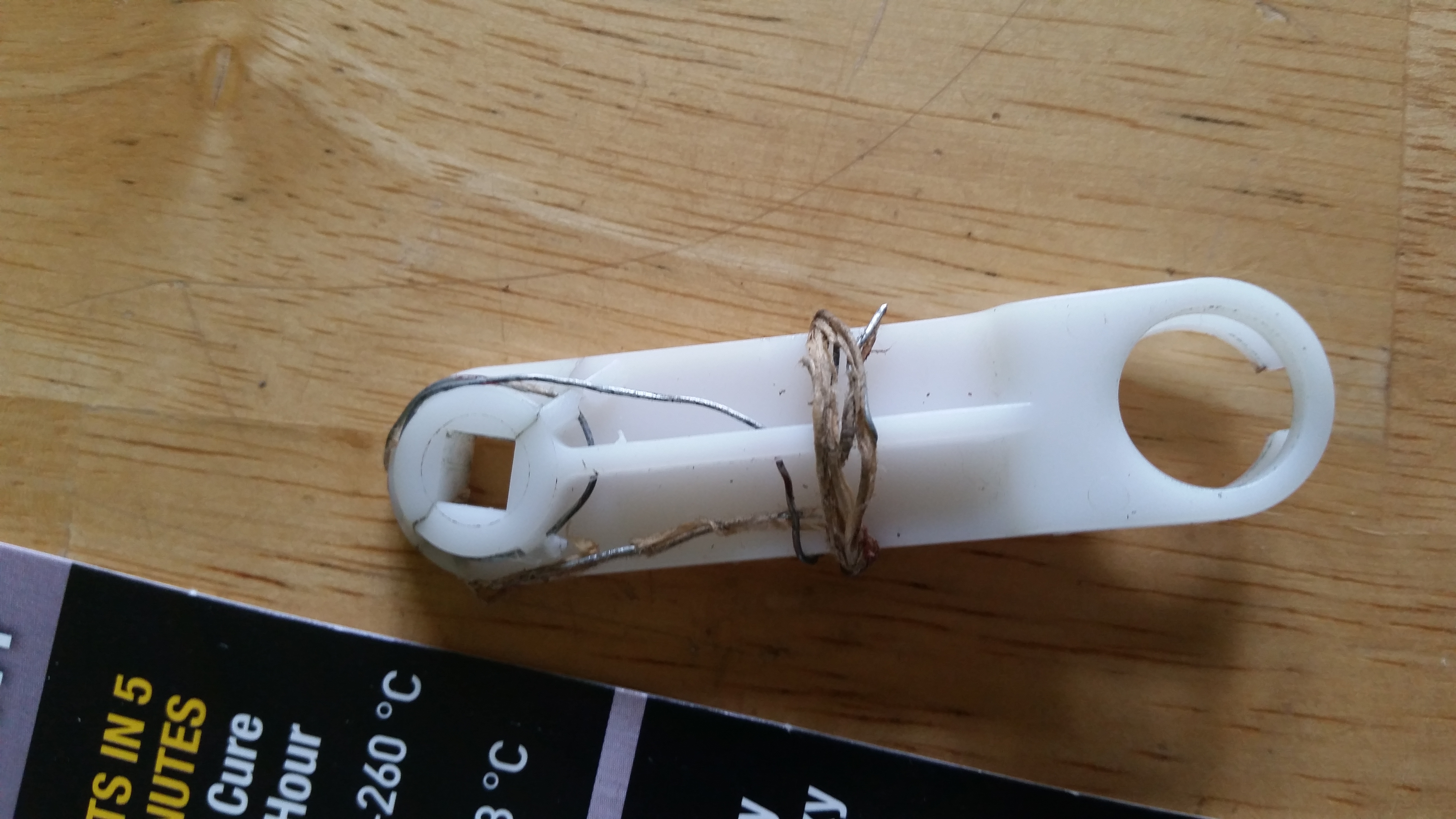

I like your fix, I'll try it and post pic.'s

Nicely done. That will hold especially if you got some tension on that wire going around
