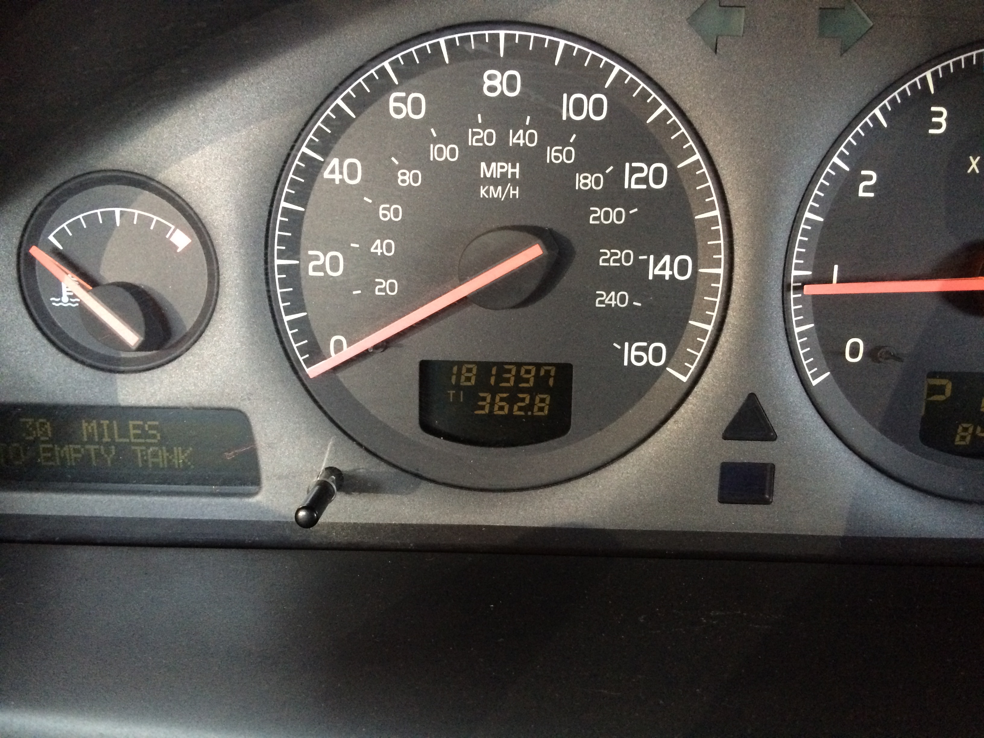

Last night, drove the my wife's XC(01 181XXXXmiles) and suddenly the following issue brought up right after cranked. :shock:
Please review the following information and let me know what do I need. Thank you.
1. No audio & auto climate control lights(Audio & ACC is working good).
- 2-3month ago, buzzing noise is coming from ACC when open the door.
It is still in there, I will clean inside the ACC fan.
2. No front & rear fog lights.
3. No headlight, seems only the DRL is working even set it on "0" position. No DIM funtioning.
4. The cluster liht is working:Spped & Tachometer lights.
However, the following lights are very DIM (not bright).
Trip odometer.
Gear and driving mode indicator.
Ambient temperature indicator.
Text window.
5. No warning lights/text message on the cluster.
6. All other electical is funtional.
I am assuming to:
1. DIM switch bad.
2. The battery issue?
Anyone can help? Thank you.
Regards
Joel J Benedict Lee
01 V70 XC 181XXX.
04 S60 141XXXmiles.

Thank you for advise. After a short diagnose, found it the problem.
1. Alternator relay or pulley: Tested & normal.
2. CEM: Tested & normal.
3. ACC units: Tested & normal, however, need to clean the inside fan soon due to buz noise.
4. All fuses & relays: OK.
Root cause:
1. DIM switch: Tested & mafuntion.
Should repalced a new either good used unit.
Thank you much for help All. :mrgreen:

Yes, it is dimming the dash lights: headlights & front and rear fog lights switch.
Update:
Recv'd the part($49 from ebay) & tested. Well functioning.
All clear!
