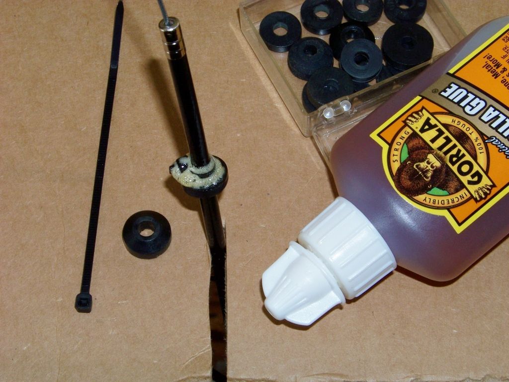

It seemed like a good idea for peace of mind to add an emergency hood release cable to both cars. Anyone who does work on their own car could figure this out without a DIY, but here's my version.
I wasn't very concerned about security because we garage both cars except when they are in use--so purchased a cable kit from Amazon the last time I needed to add a few bucks to qualify for free shipping.
With a tight-fitting faucet washer, zip tie, and polyurethane glue, I installed a stop on the cable sheath.

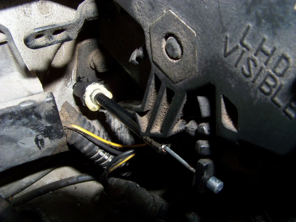

I drilled a hole through the inner finder liner--a bit lower would be better to clear the latch bracket, but it's a little difficult to tap a center punch back in there, so this was it. I did better on the wagon.
Finished up by crimping a loop, then tucked the thing up underneath, and zip tied this end of the sheath to make sure it would stay put, out of sight and harms way.
It's very easy to release the hood with this setup. I had originally thought of doing one for the passenger side latch also, but they seem to have a much lower failure rate, probably because it is an almost straight pull across the front of the car.

mika wrote:missing the big idea here...to where is the cable connected to? Does it replace the original cable?
Mika, it doesn't replace the original cable but is supplemental to it. It's a backup in case the main cable to the passenger compartment fails. It connects to the end of the lever that releases the latches under the hood. There is one located at the bottom of each latch. There is already a hole in that lever that Volvo conveniently provided (almost like they they anticipated a problem in the distant future).
You can replace the original cable like cn90 and probably be fine, but this is just a little extra insurance.
