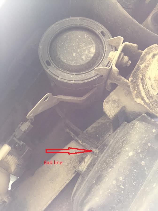

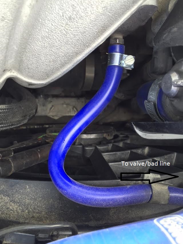

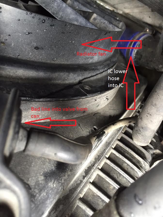

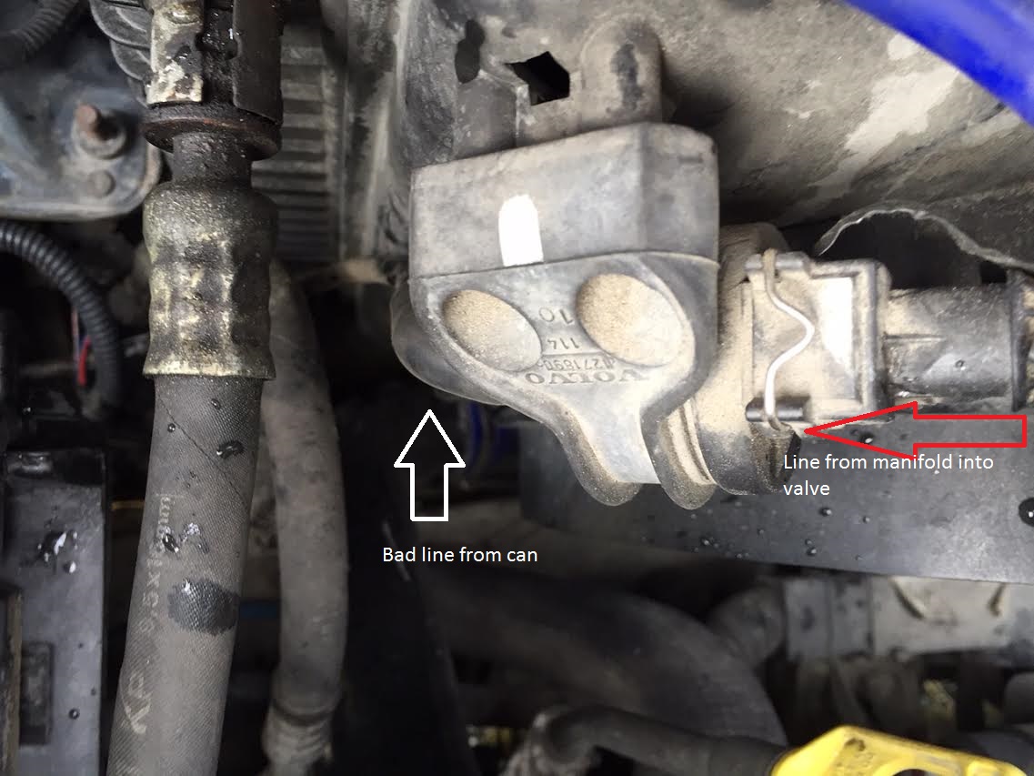

Sh1tty cell-phone pics coming up. I put some arrows and stuff in there, to ease the vertigo a little.
Line into manifold. Arrow points in direction of valve. This is a nice, new silicone hose.
Line continues from last pic (-ish) in from the right, through valve under that connector, and to the elbow and cracked line leftwards and down.
Here's the elbow and bad line looking downwards past the fan.
Line appears from the air guide and goes up into the can. It was cracked right inside the edge of the airguide, from the looks of it from long before I got the car.
