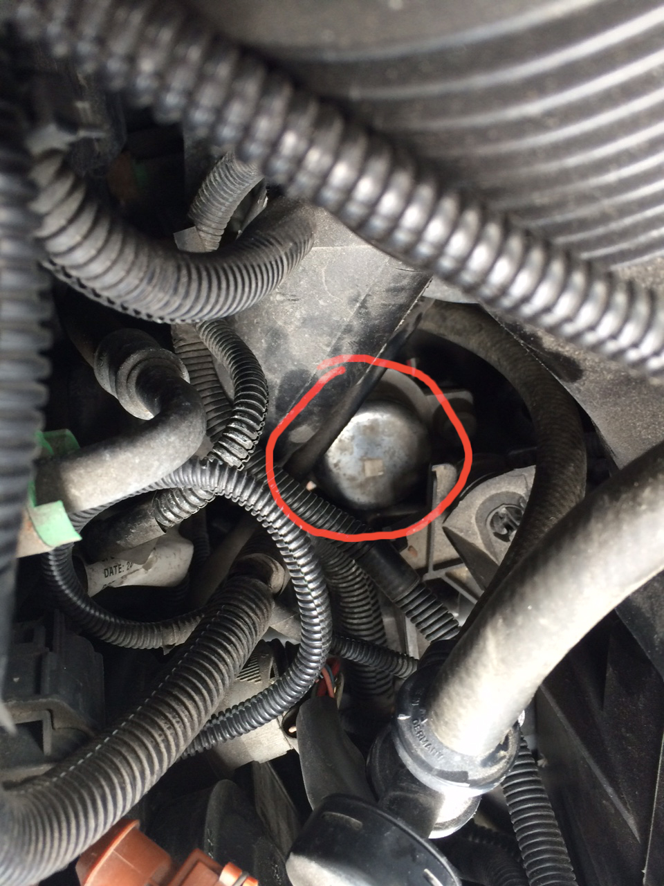

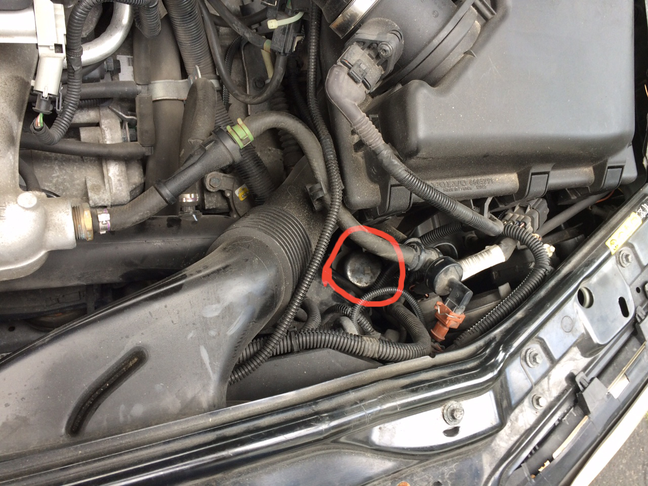

there is a somewhat loud noise coming from the car when is contact is on, engine running or not. behind the front driver's side headlight. if anyone is aware of what it is or what to do. (see picture)
car has 86000km on it. the module also gets very hot pretty fast, that is even when the engine isnt turned on.

anyone know what that part is or how do i fix it ?

Post by jimmy57 »
