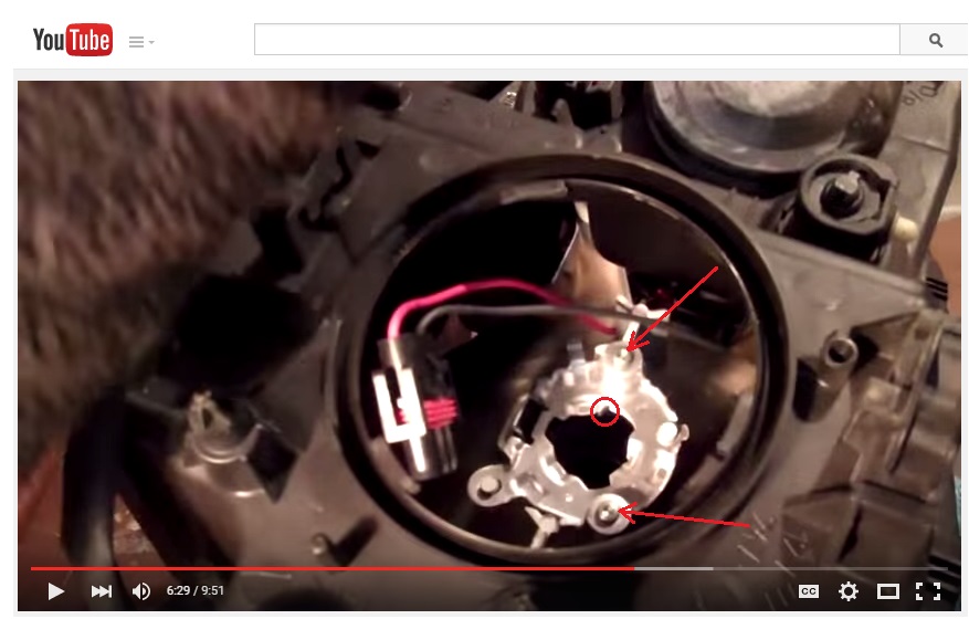

The owners manual says "twist the bulb CCW". Well, it took me 30 minutes and I could not remove the bulb! So I removed the other side (RIGHT side) for comparison.
Interestingly, the RIGHT side tab (Red circle) was bent inside, so removing the bulb was straightforward).
The LEFT side tab was straight across, preventing the bulb from coming out!
The solution is to remove the 2 Torx scews (Red arrows), then bend the small tab and remove it to make life easier for you.
Tip: to undo the connector, gently bend the plastic side tab on each side a bit while prying the connector with a small flat screwdriver. Go Slow!
