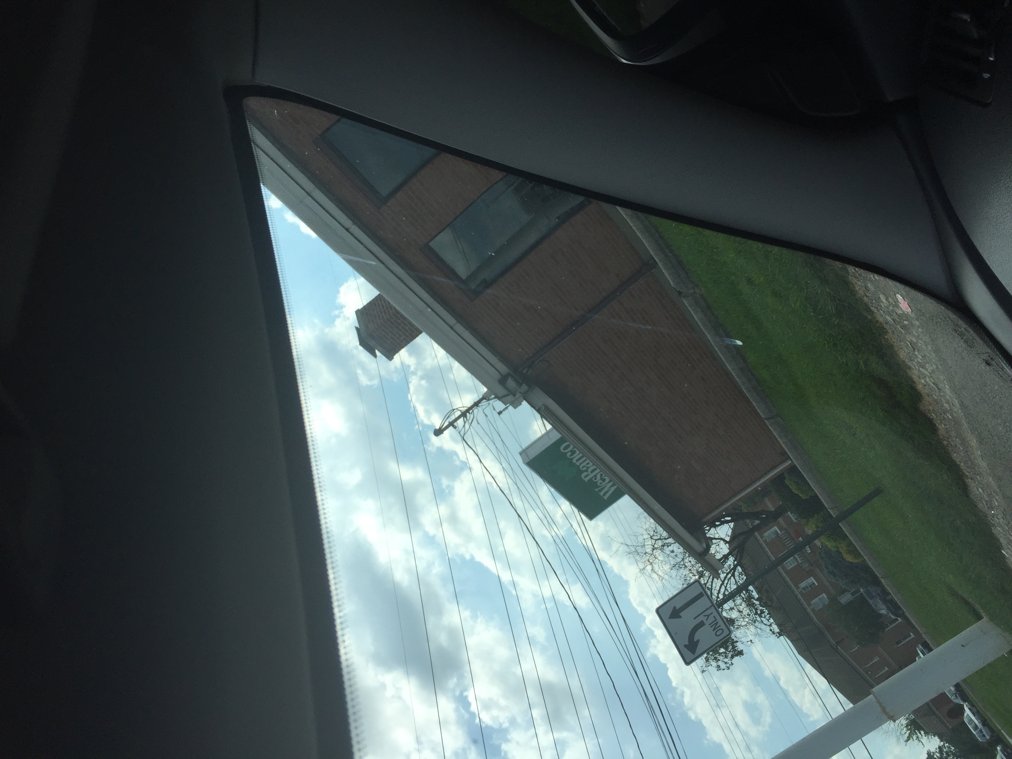

I just bought a used 2010 S40 with 50k miles. I just took it through the car wash and noticed water started to drip through the windshield in multiple places. It didn't do this the first time I washed it. The windshield also has a tiny chipped spot on it.
I attached an image showing where a water streak is coming in. It didn't look like there was water coming in near the A pillars.
Is this pretty bad news? Like I need a new windshield? I'm worried there might be rust damage. Anyone have advice... never dealt with a leaking windshield before.

If water is coming in from the high pressure car wash it's most likely going to be the seal around the windscreen. See if you can find a supplier that is willing to remove and refit. Otherwise remove any trim on the outside (if there is any) and check for consistency in the seal.
