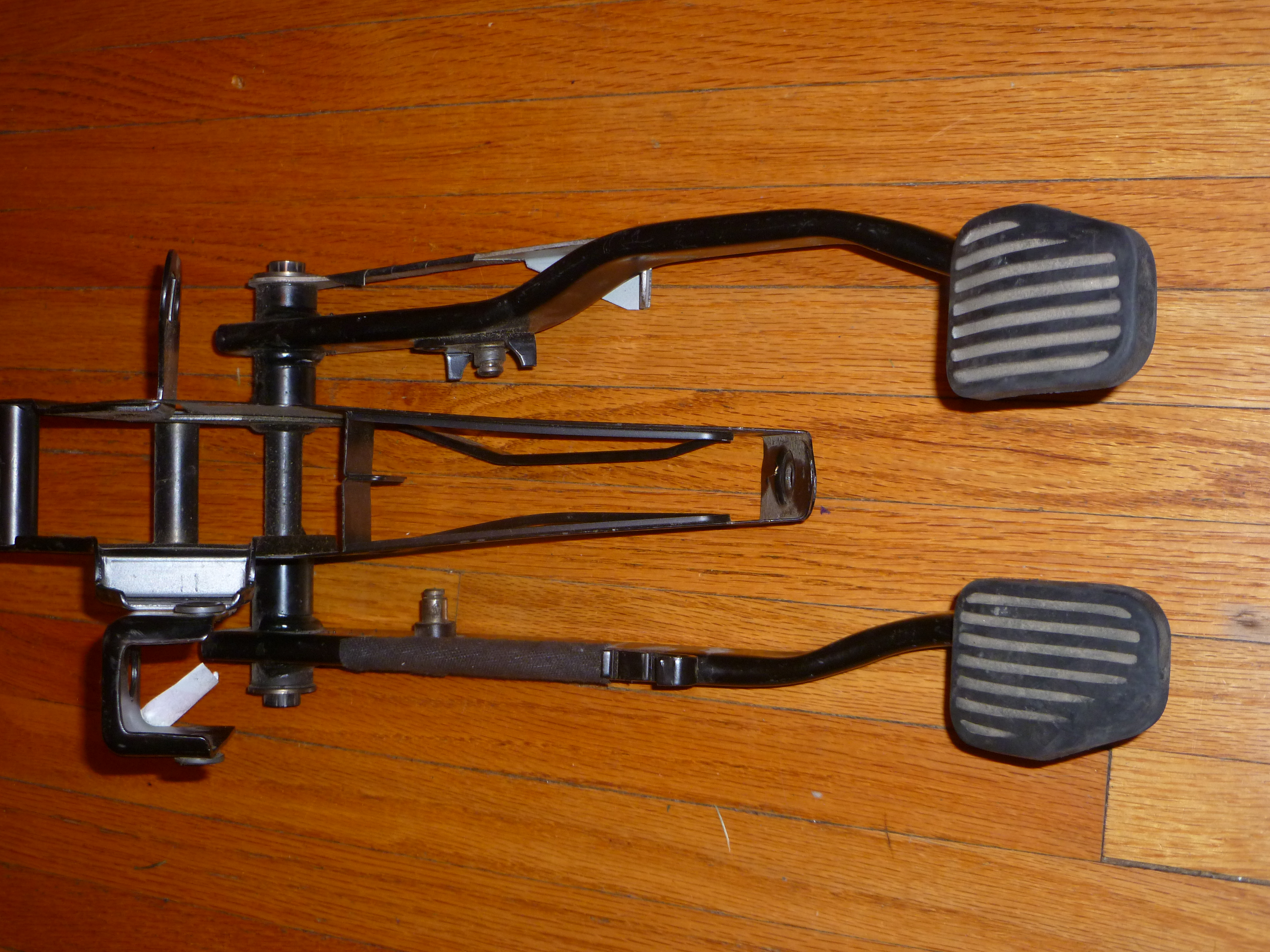

I am doing and Rn and manual swap and this is in my pile of goodies, is this for an 850 or s70 ? I have googled but can't find this one I need to get a return spring and wonder which one I need

There should be a part number or numbers stamped on them. If you can post the part numbers we can check.

From what I see, it can fit an 850 or S/V70 from 92-2000.
The spring kit part number looks like 271805
