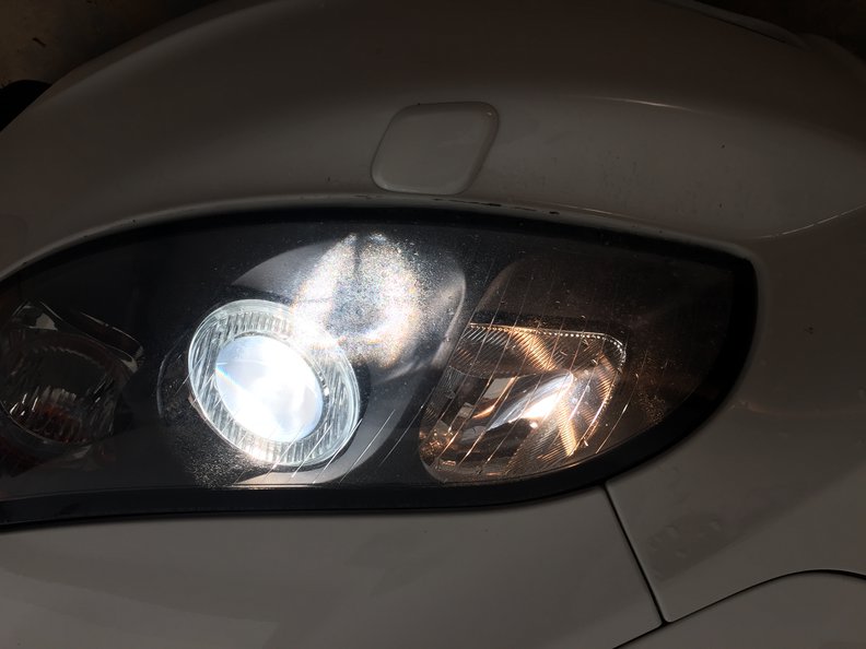

Earlier this week my driver side halogen headlight burned out. I noticed the high beam was on, but dim when the car was running. I assumed this was to compensate for the burned out bulb. I replaced my halogen and the driver side high beam continues to light dimly, even with the main headlight working. Both high beams work, I just can't get the driver side to turn off. Ideas?

Sound s like corrosion or a short somewhere. Try unplugging, cleaning and reconnecting the bulb connector, and then your headlight relay. Otherwise it could be in your switch or the dimmer stalk.
